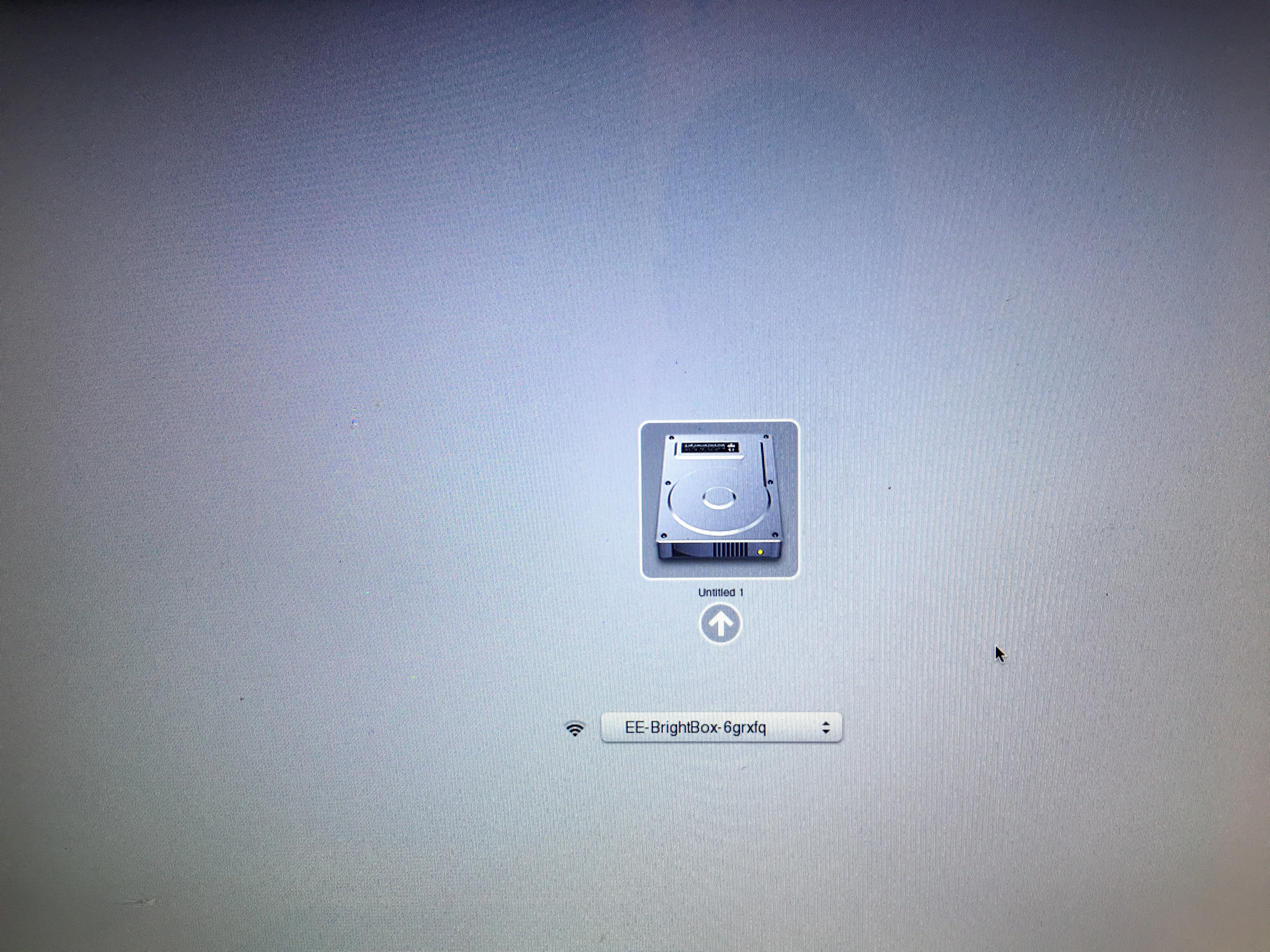

Holding option got me to a menu where I could see my hard drive but there isn't a recovery partition and if I double click the drive or click the arrow, white screen (actually grey screen).

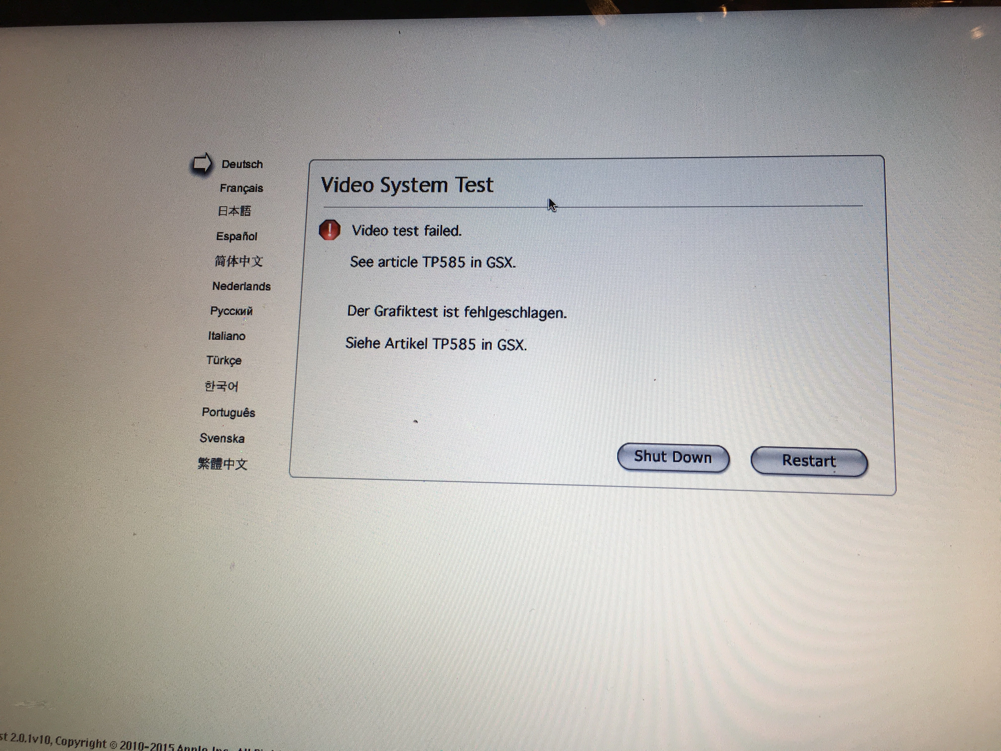

Went to the Genius Bar and looks like it's the GPU. They booted from the network and ran a hardware diagnostic. All tests passed apart from the video test. I need a new logic board. Lucky for me my model is covered under a quality program so I get the replacement free of charge. Thanks for all your help guys.
