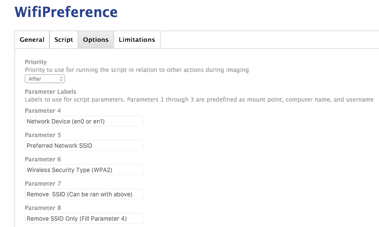

The script has a check to ensure all settings are filled with input or it exits with what is missing. Here is a picture of the script options in Casper:

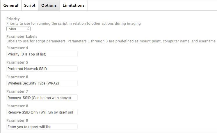

  • December 3, 2015
Here is the updated script since the last post, it can now auto-detect which EN port is WiFi. I've also added the ability to change priority numbers (0 being top of list). Below is the setup for the script settings.
