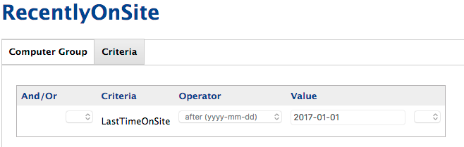

Tes, the EA is saved with a Data Type of Date.
The smart group is very simple, there is just one single criterion: "LastTimeOnSite after 2017-01-01":
I also tried
- 'before' that date,
- before 2018-01-01
- less than x days ago, with x being 1 or 0
- more than x day ago, with x being 1 or 0
For all of these the smart group shows zero members.
