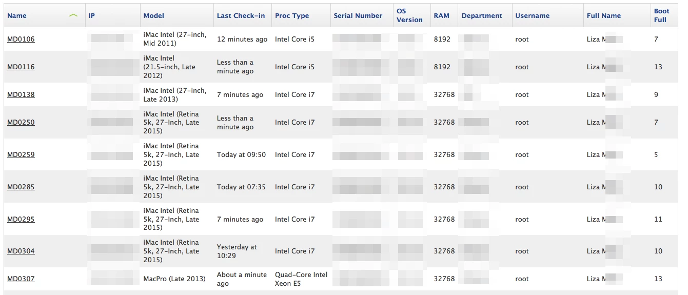

Hello all,
I'm seeing an odd thing in our inventory in JSS (v9.9.2) where some Macs will show root as the current User and a completely random name in the Full Name field. The name will show up for all the Macs that are showing with the User root. I can't seem to make heads or tails of why some Macs start reporting this. Today there are 22 Macs showing up this way (image attached).

Best answer by thoule
I suspect that your script that runs recon is running when no user is logged in so root is being returned. You could wrap that recon line in an 'if' to exclude root....
if [ $loggedInUser != "root" ];   then
    /usr/local/bin/jamf recon -endUsername $loggedInUser
  • August 31, 2016
Thanks! Have made those changes and will see how it goes - certainly makes sense :D

Even we have the same issue in our environment. We don't run any script for reporting there username. We can see around 80 Macs with same "Full Name" and others details but the Username is different. We are running JSS 9.81.
Anybody else came across this issue?
  • September 7, 2016
Just wanted to report back that thoule's solution worked a treat. I also added our local admin account to the exception as well. Thanks!
