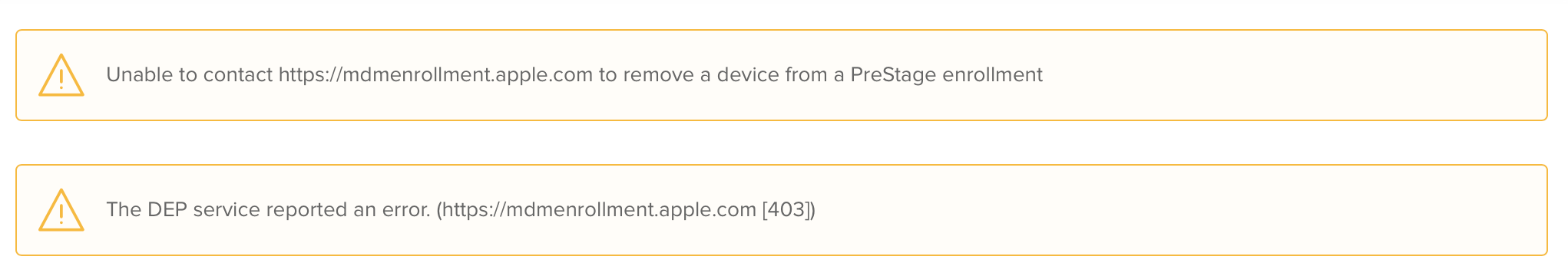

I can confirm that we are seeing this issue at our site and I was only able to install Xcode 10.x via setting the VPP to install Xcode Automatically. It worked only on 1 of the 5 computers after a restart. It never works if I try and install it via Self Service.
We have also reported to Jamf Support that our DEP is also broken since the Jamf Cloud was upgraded to 10.8.0
From our point of view the last two releases have been nothing but problems, very buggy and poor quality control.
