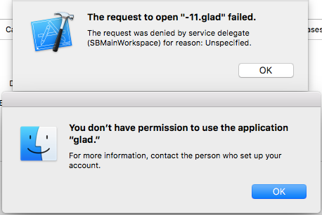

After I get into the Xcode and created some demo app for macOS, and then hit the "RUN" button, after a while I will get an error

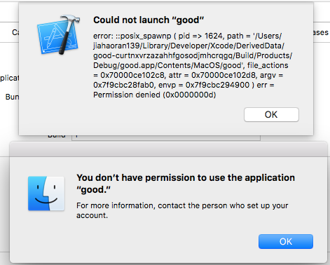

And when I try to create some demo app for iOS , and hit the "RUN", I will get this error
End of the day, they are all pointing to the permission or file rights problem. Something different for the domain users from AD to login than a local account login is that the primary group of the folders created by the domain users will be in format like this "domain namedomain users" , but for local account it will be staff group. I have tried to change the folders of my apps primary group from domain users to staff, and also tried changed to _developer group, but nothing works.

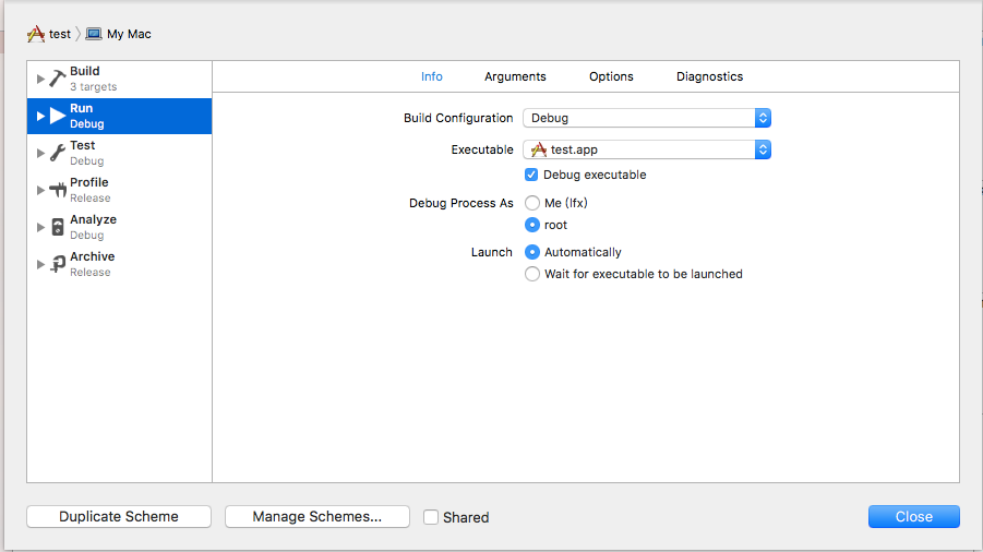

Guys, I am back, the problem was partially solved, for the MacOS app, I can go to the Xcode Menu bar -- Product -- Schema -- Edit Schema , change "Debug Process as" from "Me" to "Root" , this will do the trick no more permission denied for the macOS app anymore.
But for the iOS app I am still have the same error as above, because the "Debug Process as" option is greyed out for iOS app, not sure why the settings are different, but sounds noway I can change this.
This might lead to another question that is there any difference between the admin account created by JAMF and the admin account created by Apple setup wizard, because I have another MacBook Air with the same version of Xcode installed, which not having this problem at all.
