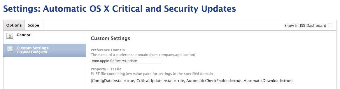

@mbezzo Use a Configuration Profile to automate...
ConfigDataInstall is the key that needs to be set to true.
As far as I know, these updates are issued as needed to respond to exploits. I'm planning to ask my Apple rep in later this week if they're able to share a feed of the latest update either by date or version.

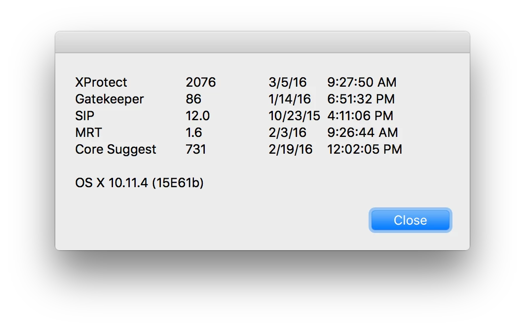

There are a number of items that fall within Apple's newer security updates scheme. Here is a screenshot of the little AppleScript app we use that shows the items and the dates, etc.
I won't post up the code as it's a rudimentary AS that was written by someone else and it got a lot of grief from guys that know how to write code properly. It does the job nicely, and we can see when the Macs are getting behind on things or not.

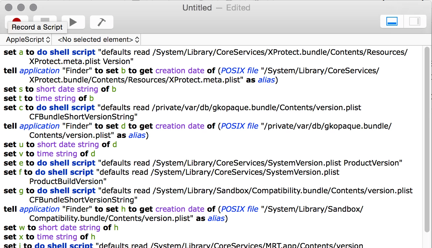

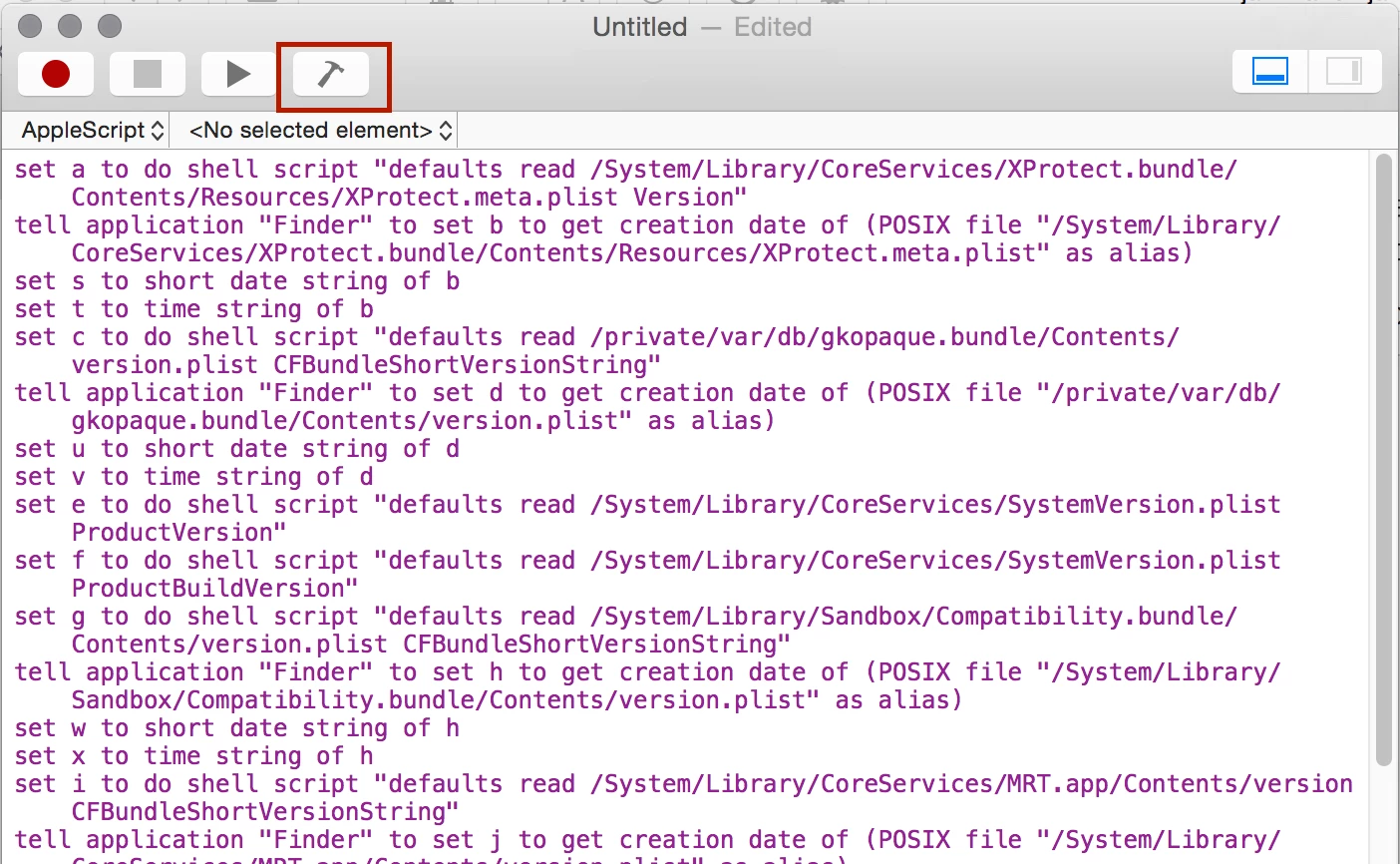

OK, I'll post it. Again - I did NOT write this. I didn't even know it was "crap" until I put it on Slack one day and got endless ribbing over it. I'm just learning the basics now and was only trying to be helpful. So, again, with apologies towards those who know WTH they are doing with code, here it is. Hope you find it useful. This one if for 10.11.x. I think I also have one setup for the older OS X's. I'll locate that and post later.
Open up Script Editor and create a new item. Save as a ".app" and run.
set a to do shell script "defaults read /System/Library/CoreServices/XProtect.bundle/Contents/Resources/XProtect.meta.plist Version"
tell application "Finder" to set b to get creation date of (POSIX file "/System/Library/CoreServices/XProtect.bundle/Contents/Resources/XProtect.meta.plist" as alias)
set s to short date string of b
set t to time string of b
set c to do shell script "defaults read /private/var/db/gkopaque.bundle/Contents/version.plist CFBundleShortVersionString"
tell application "Finder" to set d to get creation date of (POSIX file "/private/var/db/gkopaque.bundle/Contents/version.plist" as alias)
set u to short date string of d
set v to time string of d
set e to do shell script "defaults read /System/Library/CoreServices/SystemVersion.plist ProductVersion"
set f to do shell script "defaults read /System/Library/CoreServices/SystemVersion.plist ProductBuildVersion"
set g to do shell script "defaults read /System/Library/Sandbox/Compatibility.bundle/Contents/version.plist CFBundleShortVersionString"
tell application "Finder" to set h to get creation date of (POSIX file "/System/Library/Sandbox/Compatibility.bundle/Contents/version.plist" as alias)
set w to short date string of h
set x to time string of h
set i to do shell script "defaults read /System/Library/CoreServices/MRT.app/Contents/version CFBundleShortVersionString"
tell application "Finder" to set j to get creation date of (POSIX file "/System/Library/CoreServices/MRT.app/Contents/version.plist" as alias)
set y to short date string of j
set z to time string of j
set k to do shell script "defaults read '/System/Library/Intelligent Suggestions/Assets.suggestionsassets/Contents/version.plist' CFBundleShortVersionString"
tell application "Finder" to set l to get creation date of (POSIX file "/System/Library/Intelligent Suggestions/Assets.suggestionsassets/Contents/version.plist" as alias)
set m to short date string of l
set n to time string of l
display dialog "XProtect " & tab & tab & a & tab & tab & s & tab & " " & t & return & "Gatekeeper " & tab & tab & c & tab & tab & tab & u & tab & " " & v & return & "SIP " & tab & tab & tab & tab & g & tab & tab & tab & w & tab & " " & x & return & "MRT " & tab & tab & tab & i & tab & tab & tab & y & tab & " " & z & return & "Core Suggest " & tab & k & tab & tab & tab & m & tab & " " & n & return & return & "OS X " & e & " (" & f & ")" buttons {"Close"} default button 1

Excited to get this running but when I create the .app file with TextWrangler and run the file, the .app won't run, throws up an error "You can’t open the application “GetLatestVersionASU” because PowerPC applications are no longer supported.
Researching how to get his done, but if any of the gurus know the answer, I'd greatly appreciate the help!
mm2270
  • March 11, 2016
@TomDay Its an Applescript, so you need to paste it into Script Editor, located in /Applications/Utilities/ and then click the build button in the toolbar. Then save it as an application bundle. See screenshots...
Raw code, click the Build button highlighted
The compiled code. Save from here to an application bundle
