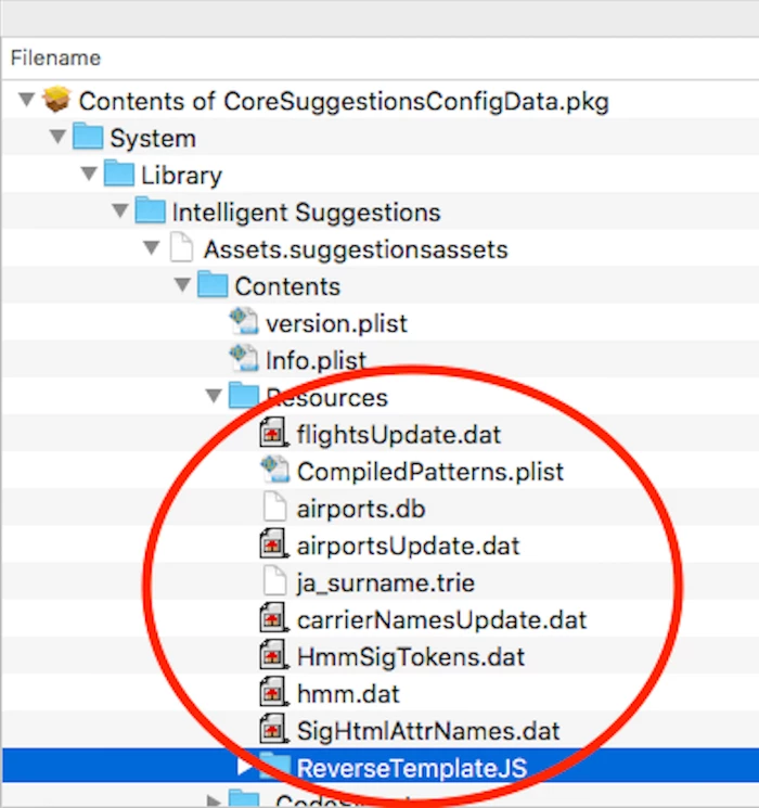

Forgive my ignorance, but anybody have any info on "Core Suggest"? I'm not familiar with it and didn't find much with a quick search.

@mbezzo - here's the contents of it. Still not really sure, but you can get some ideas looking at this:

@scottb Interesting - thanks!

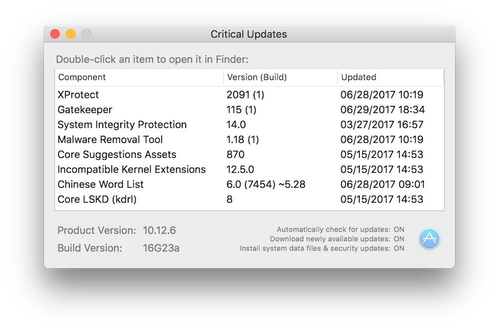

Here's an updated rev that is a little nicer. A mix of contributions by a few people.
Gives you the below in the screenshot.

display dialog displayString buttons {"Close"} default button "Close" with title "Critical Updates (v1.1)"
--EOF

Hey @ClassicII et.al, Phil has taken this over and is offering it up on his site (with other stuff). Check it out - he's a dev and a longtime fellow AppleSeeder. I pinged him about getting the script as he delivers it in .app form now. If he's cool with me posting the script here, I'll add it later. We used to pass it around and folks would edit to their needs...guess he's the gatekeeper (not intended) now.
Phil's site
Current screenie
