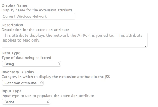

  • June 2, 2015
@jperkins01 I've actually switched to @mm2270 EA as listed above. I just add this to Management Settings > Extension Attributes
