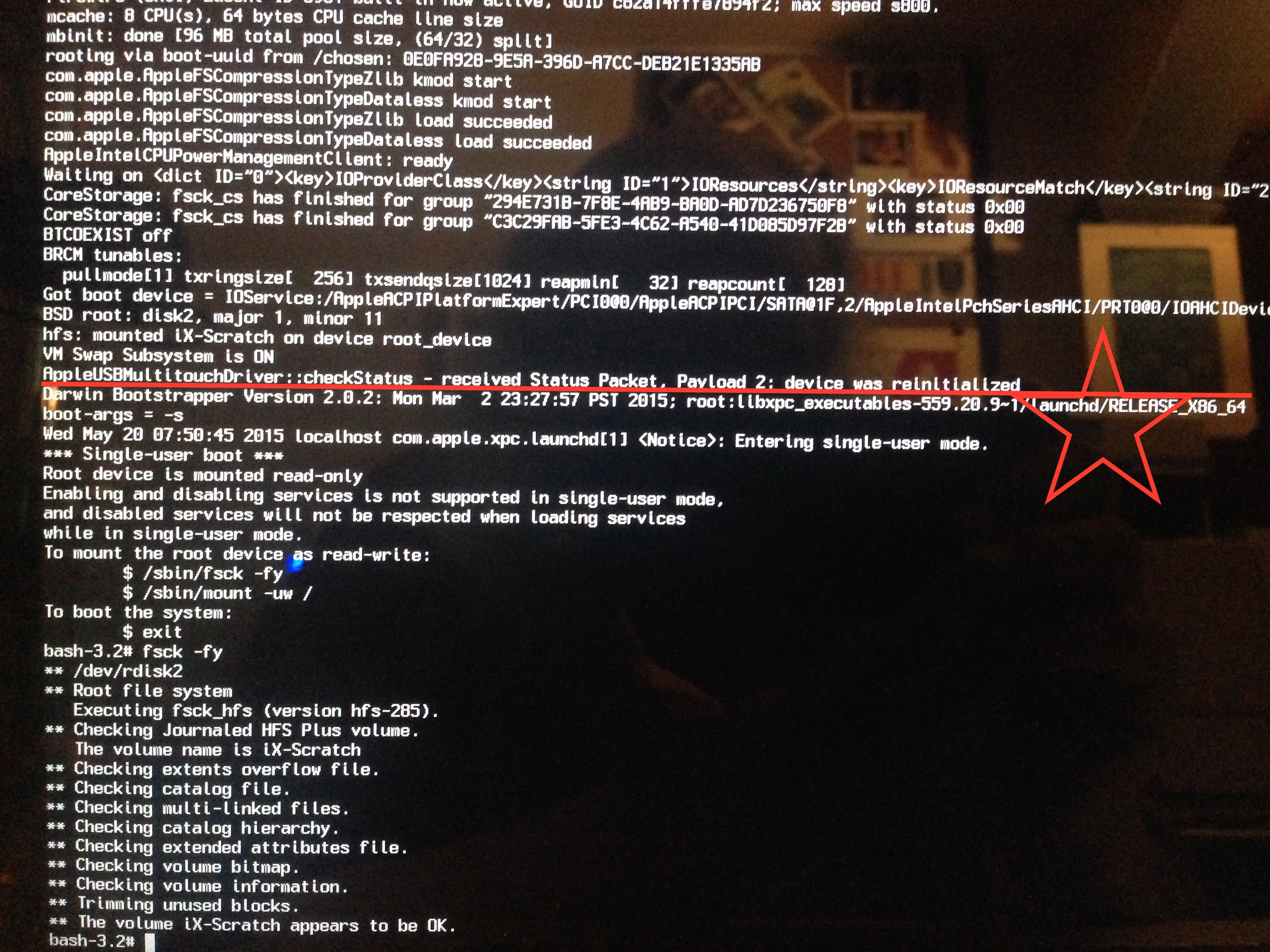

Yosemite will not start after installation over Mavericks. After installation, narrow progress bar runs with Apple logo above it, the system load process stalls and the logo changes to a circle with a diagonal bar across it similar to a "do not enter sign." Nothing happens after that .
Booting into SAFE MODE yeilds the exact same result. Holding down the OPTION key shows a Yosemite system installed on the proper partition, but choosing it and starting the system again yields the same result.
Holding COMMAND & S to boot into single user mode to run a fsck -fy scan stalls with a message that says it is waiting for the root system. The result is the same after a few seconds; the screen reverts to the light gray with the circle and the diagonal bar.
The attache picture shows the exact spot in the boot into single user mode that the process stalls.
I can boot into the RECOVERY Mode, run Disk Utilities, but disk and file structure is fine. I repaired permissions, but restarting from there yields the same result.
Resetting PRAM doesn't help, and reinstalling Yosemite doesn't help either.
