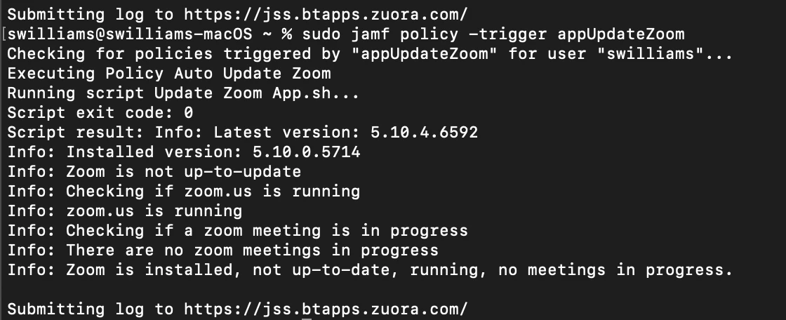

  • April 26, 2022
Does this still work? I ran this on a Mac which is on 12.3.1 with an old version of Zoom, I get the helper pop up saying out of date and to update, but then it just ends the scripts, with this output;
  • April 26, 2022
You have to uninstall the exist zoom and then run the script. It installs the ZoomIT.pkg which is the Zoom for IT. It is a different version of the client than the downloaded client.
  • April 27, 2022
Thanks for the quick response, so if I understand. The script wont do anything if the end point has the downloaded client and not the ZoomIT Client? But if it has the ZoomIT client it will work as normal?
  • April 27, 2022
Also, I am seeing this error within Policy logs;
2022-04-27 13:57:36.260 jamfHelper[41363:1706814] XType: com.apple.fonts is not accessible. 2022-04-27 13:57:36.260 jamfHelper[41363:1706814] XType: XTFontStaticRegistry is enabled.
Any ideas?
This is what I am currently seeing in the Log details of the script in JAMF.
Script result: Info: Latest version:
Info: Installed version: 5.11.6.9890
Info: Zoom is not up-to-update
Info: Checking if zoom.us is running
Info: zoom.us is running
Info: Checking if a zoom meeting is in progress
Info: There are no zoom meetings in progress
Info: Zoom is installed, not up-to-date, running, no meetings in progress. 2022-08-25 13:34:28.702 jamfHelper[11122:1687383] XType: com.apple.fonts is not accessible. 2022-08-25 13:34:28.702 jamfHelper[11122:1687383] XType: XTFontStaticRegistry is enabled
Also, If the user clicks on Update does it close out the application?
