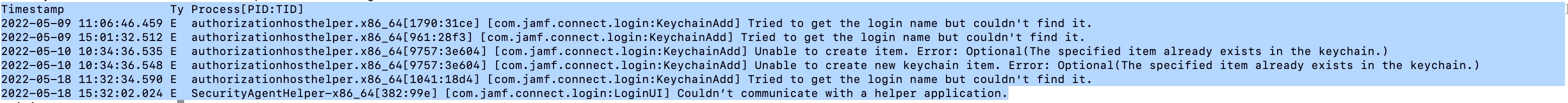

Ugh, it will not accept me posting the output, whether it's in a code block or not, it keeps removing it.  I took a pic of the output, maybe that will help?
I'm guessing the last line could be the culpruit?

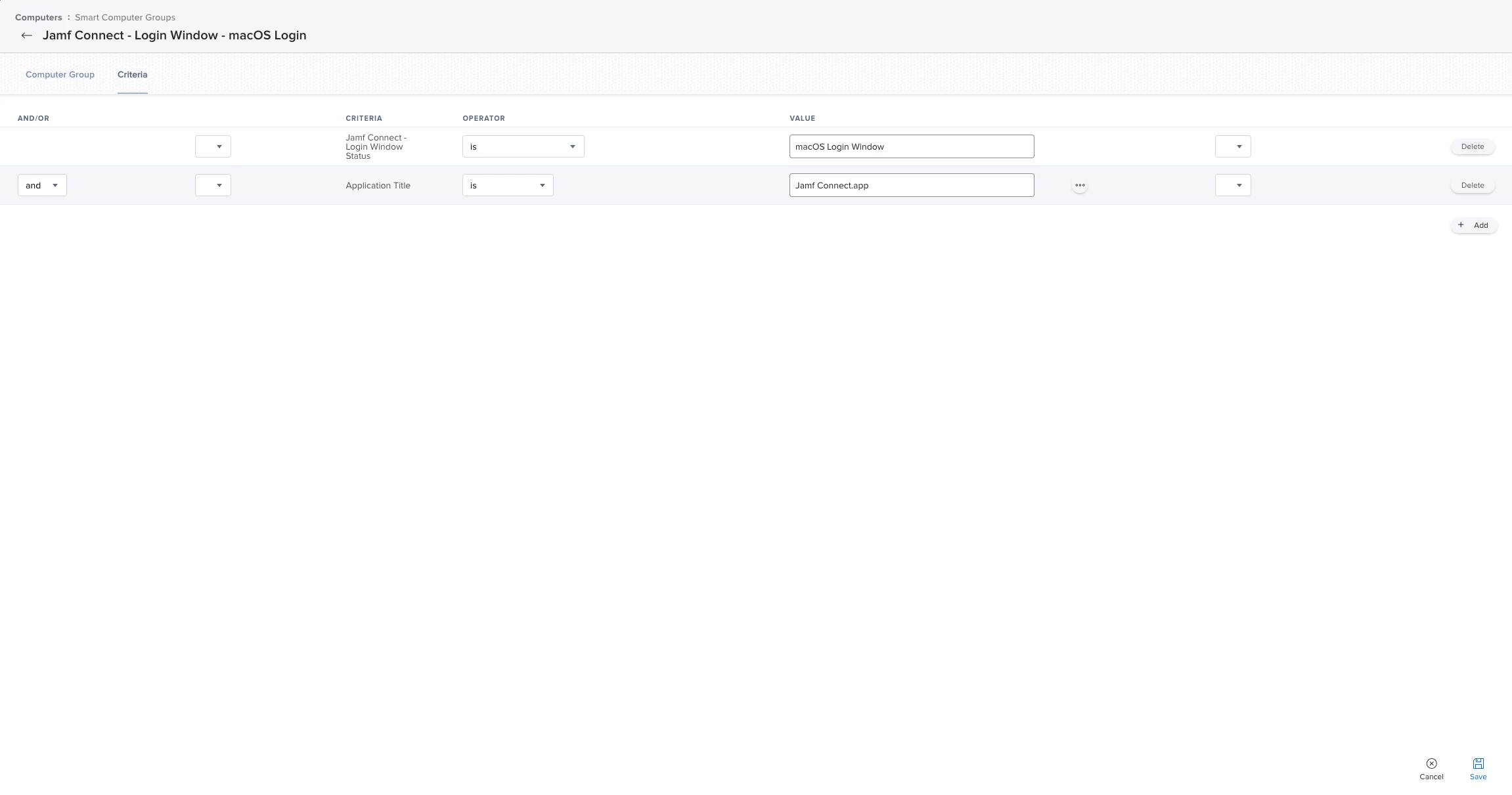

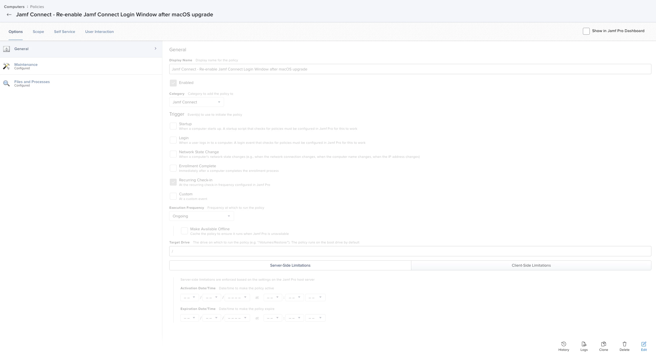

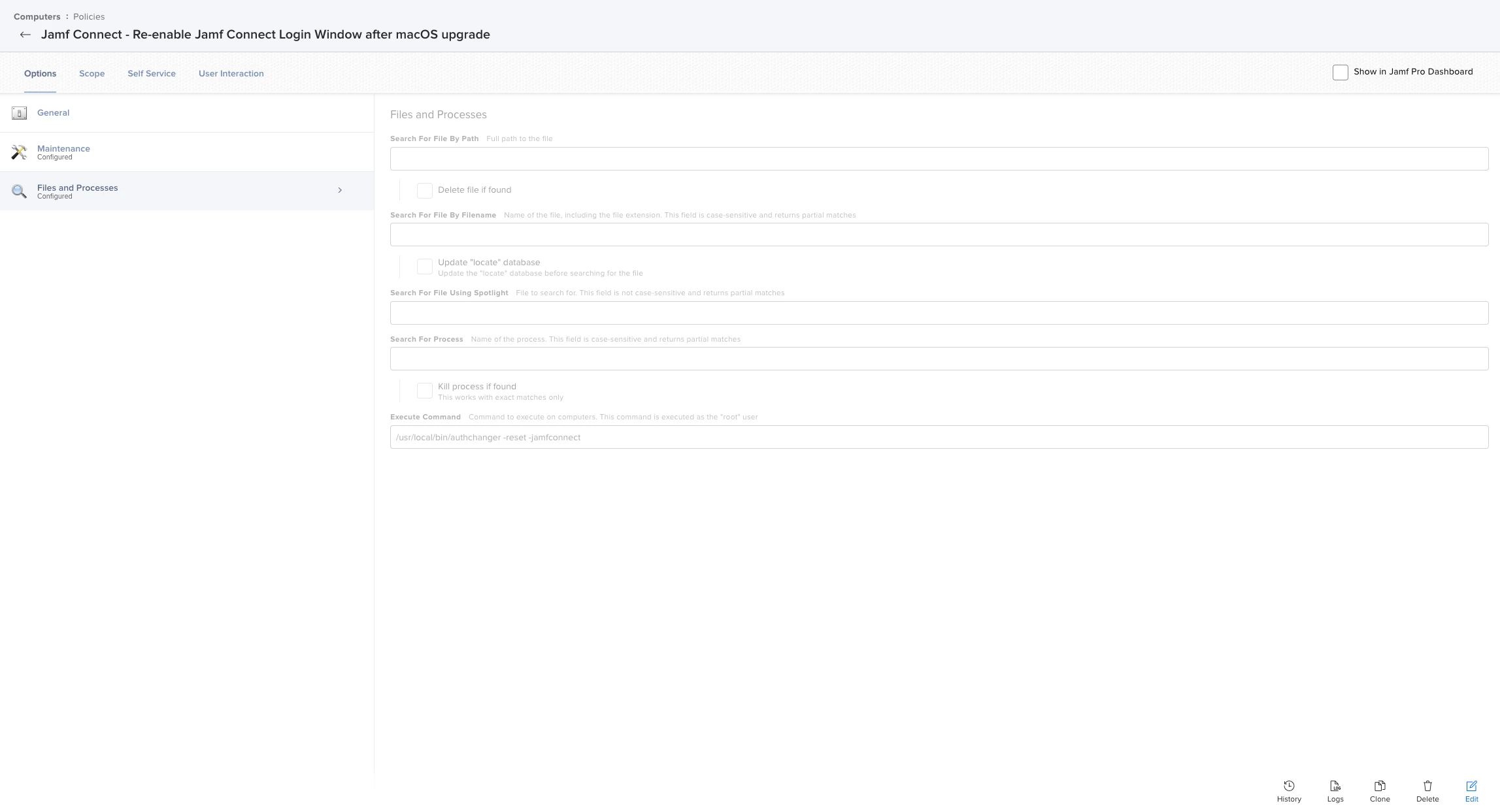

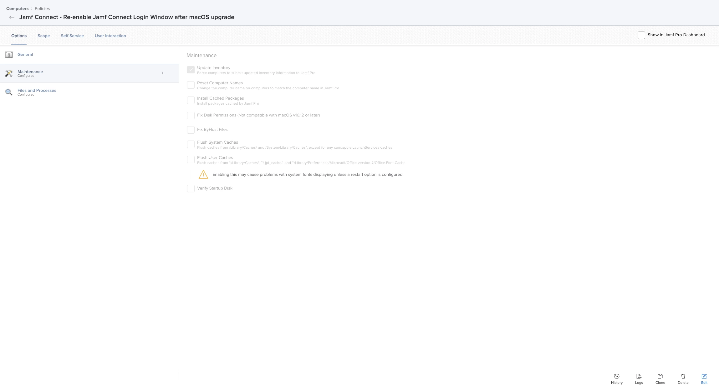

To add on to this, we have a similar policy that runs in tandem with an extension attribute we have that checks what the login window is set to. We used to use NoMAD, but for your purposes you can leave it out.
The EA is:
#!/bin/bash loginwindow=$(/Library/Security/SecurityAgentPlugins/JamfConnectLogin.bundle/Contents/MacOS/authchanger -print) if echo "$loginwindow" | grep -q "JamfConnectLogin:LoginUI" then status="Jamf Connect Login Window" elif echo "$loginwindow" | grep -q "JamfConnectLogin:DeMobilize,privileged" then status="Jamf Connect Demobilization Process" elif echo "$loginwindow" | grep -q "NoMADLoginAD:CreateUser,privileged" then status="NoMADLoginAD" else status="macOS Login Window" fi echo "<result>$status</result>"
Our Policy is then used to reset the authchanger db for any computers in our smart group that echo "macOS Login Window". We have this Policy set to ongoing for each check-in and we run a recon as well at the end so the the EA gets updated.
I'd imagine so, however I haven't ever seen that error before. Hopefully resting authchanger can help, otherwise you may need to completely remove Jamf Connect, reset the authchanger db to the macOS login screen and go through the installation process again.
The EA is:
I actually have this (or something very similar to this) set up as well so that if an OS update resets the login to the OS (like 12.3 did) then it will go into the smart group that auto changes it back to JC.  Seems to work well, but in this case, it's still set to JC so it never goes into the smart group.
Yeah ok, thanks for your help.  I did just do an authchanger reset to the OS window, rebooted, then authchanger reset back to JC and it seems to work, but still curious why it breaks in the first place.  At least we have a workaround in the meantime.  Maybe I can submit a ticket to Jamf and see what they say.  Again, appreciate all the help!
