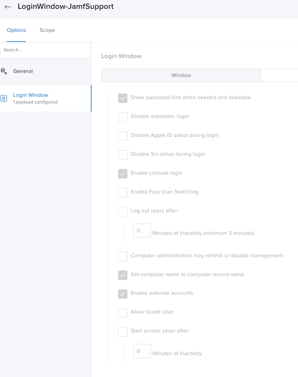

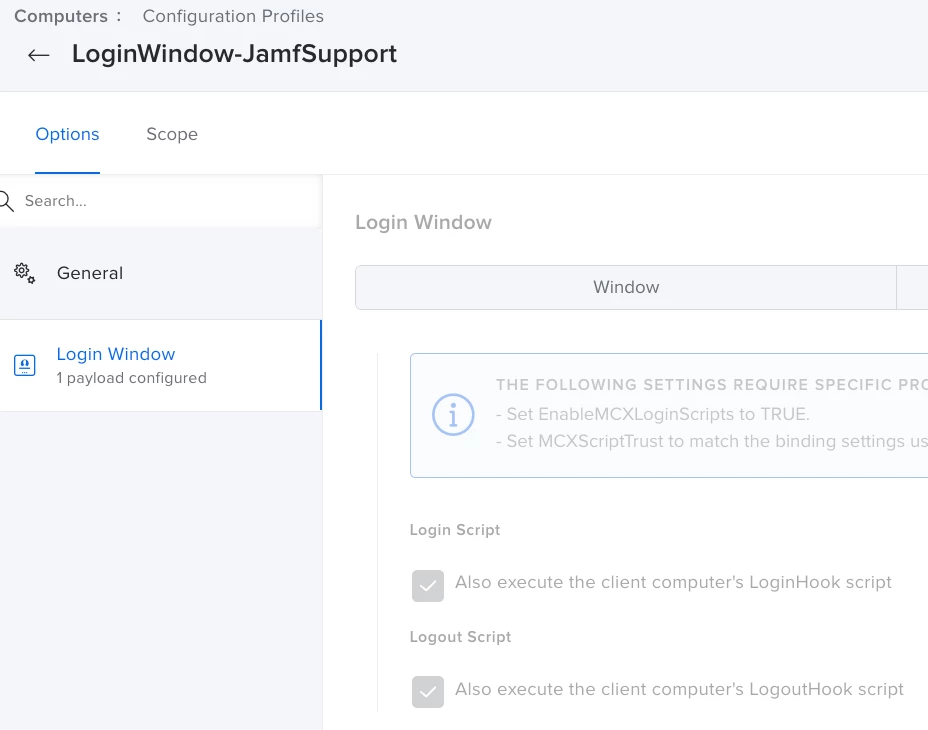

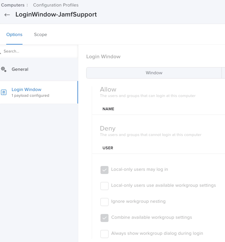

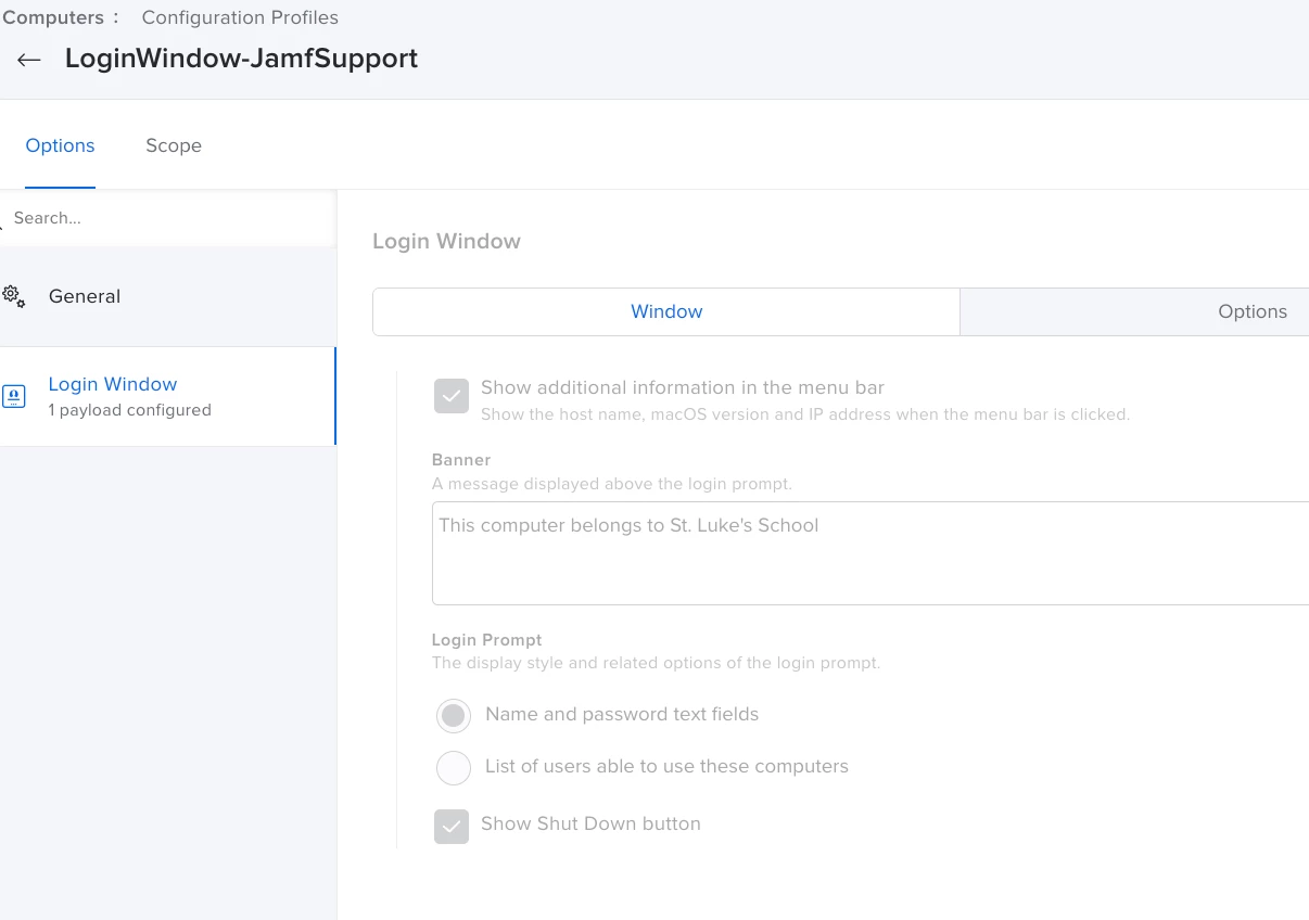

So I just heard from Apple asking me to try the newest seed for 14.2 where they claim the issue is resolved....looks like I have homework to do.  Here are screen shots of our config prof for login window that Jamf Support helped me build. So send that config prof down (remove your previous one with Login Window settings), plus run a policy that unhides the hidden admin account using the execute command...if this doesn't work for you then there must be more variables that also cause the lock screen issue unfortunately. Might seem obvious, but make sure you don't have multiple config profiles doing things to the Login Window to conflict with this new one.
Create a policy with this command:
Create a new Config Prof (and remove your old Login Window prof):

we got similar settings for login config as suggested to you by Jamf Support. The only difference is "Enable console login" and "allow external users" are not checked.

Is this intermittent for you or reproducible every time you get to a lock screen? Once I deploy these settings down, the "not accepting the password at lock screen" issue goes away. We just don't like having the jamf admin account being visible now though.
Also--are you using local accounts or mobile accounts? Are you noticing the same behavior on FileVault encrypted devices as well as ones that don't have FileVault enabled?
So did that solve it for you or are you still experiencing the issue? Since making the change, my Sonoma users haven't experienced not being able to log back in.
