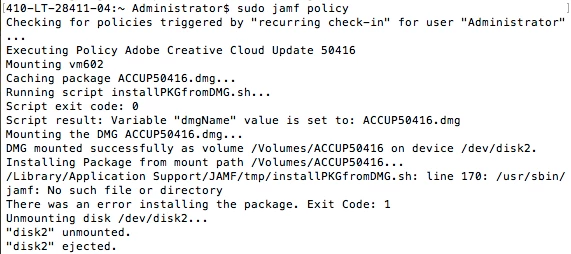

When running the policy on one of my Macs I am presented with the following error:
Would anyone have any idea on how to get this to work or what I am doing wrong?
Thank-you,
Anthony)
The binary path changed in 9.8+ to /usr/local/bin/jamf.
I haven't been admining long enough to know the real woes of the pkg from dmg issues, but as of the current CC apps, I've not had any issues with the Creative Cloud Repackager,
Since the change of all the binary paths are wrong in the script then. I will try to change them and re-upload the script to see if that makes a difference. Thanks for the suggestion.

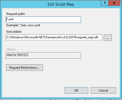

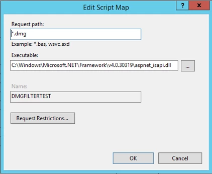

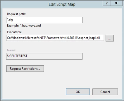

@apanages I've setup AUSST under IIS several times. What issue are you having?
Ideally we would like to download the updates once then have them available on our network instead of all of our users pinging Adobe for them.
@kerouak that would be awesome!
@thoule I am using this guide from Adobe https://helpx.adobe.com/creative-cloud/packager/update-server-setup-tool.html. I am able to synchronize with the Adobe Update Server after running the setup on my Windows Server, but the issues I am having are with the Setting up IIS 8.5 section. I ran through those steps and did everything that they instructed but I don't know what to do after I restart the website and run AUSST. The instructions get very vague after that point and that's when I called Adobe but they were not able to help.
Thank-you everyone for jumping in, I really appreciate the support from this community!
@apanages That's the guide I followed and it worked great. You need to find out what's wrong, so your best bet is to try things manually to identify the problem.
Is IIS Running?

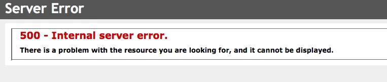

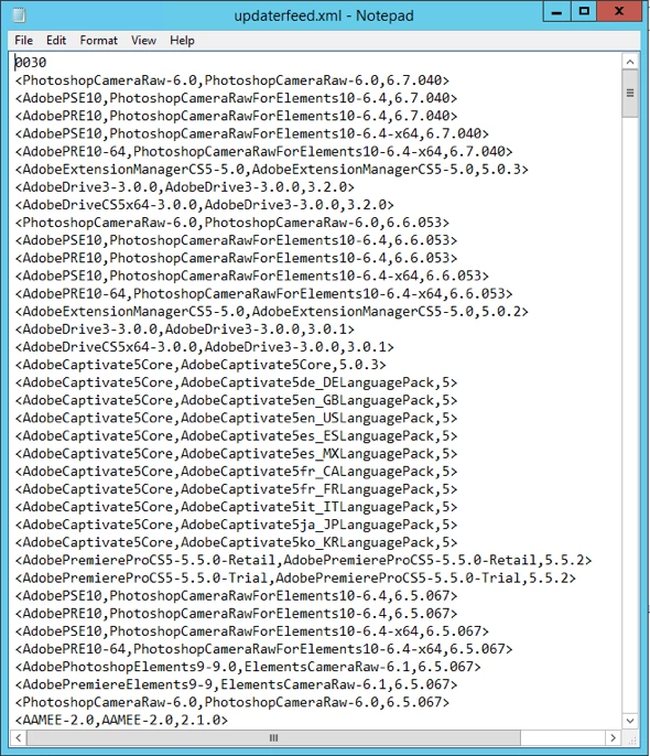

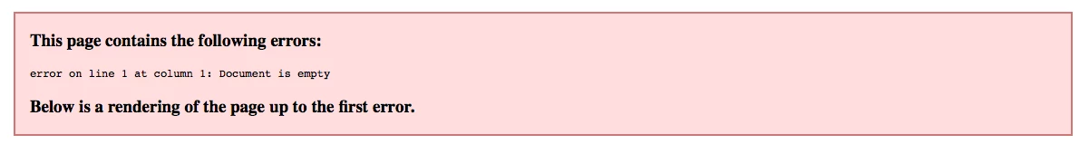

Can you download https://yoursever.com/Path/webfeed/oobe/aam10/mac/updaterfeed.xml (where Path is any path you added to the root of your server)?
@thoule I followed the path you provided (changing 'Path' of course) and I was give the following error message:
I created a test document in the same folder to make sure I was able to reach that destination as well. But this message is what I get when I navigate to the updater feed.xml file.
Any thoughts?
@apanages Is there any data in that document? You should be able to browse to it and see what it looks like. You said you could view an HTML doc in that same directory?
If empty: AdobeUpdateServerSetupTool is not running properly.

@thoule It appears that after I rebuilt my server I forgot to add the extension types. So I proceeded with the following:
  1. Launched Server Manager
  2. Tools > IIS Manager
  3. Click on my server on the left pane.
  4. Double clicked on Handler Mappings

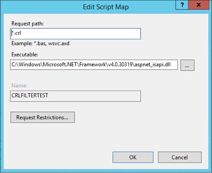

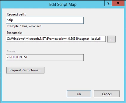

  5. Clicked Add Module Mapping and created one for each of the extensions:
  1. Under my server I clicked on Application Pools and made my DefaultAppPool (Classic).

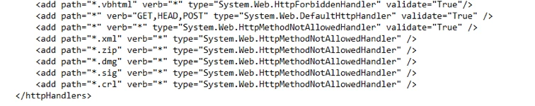

  2. I then navigated to (C:WindowsMicrosoft.NETFrameworkv4.0.30319Config) and added the following lines to the web.config file.
<add path="*.xml" verb="*" type="System.Web.HttpMethodNotAllowedHandler" />
<add path="*.zip" verb="*" type="System.Web.HttpMethodNotAllowedHandler" />
<add path="*.dmg" verb="*" type="System.Web.HttpMethodNotAllowedHandler" />
<add path="*.sig" verb="*" type="System.Web.HttpMethodNotAllowedHandler" />
<add path="*.crl" verb="*" type="System.Web.HttpMethodNotAllowedHandler" />
  1. Restarted the website.
Now when I navigate to (https://yoursever.com/Path/webfeed/oobe/aam10/mac/updaterfeed.xml) I get a 505 Server Error.
I was able to browse to an HTML file that I placed in there prior to making these changes. Now its not working. As far as the updater feed.xml, there is data inside the file.
Any thoughts?
This error is certainly a filetype error. IIS doesn't know how to handle XML.
This method is a little different than what I did. I just right clicked on my server in "Server Manager" and choose "Internet Information Services (IIS) Manager. Then in the IIS Manager, I clicked "MIME Types" and added (top right, add) an entry for each type (zip, xml, crl, dmg, and sig).
But back to what you've done and the documentation. Differences between the documentation and what you've done: I see under Request Path, you have '*.zip'. In the documentation, there is no asterisk.
It also looks like you are adding a Script Map and not a Module Map. See (https://helpx.adobe.com/content/help/en/creative-cloud/packager/update-server-setup-tool.html#main-pars_header_34).

@thoule would you have a screenshot of what the updaterfeed.xml should like when navigating to it through a webbrowser?
Web browser can't parse the xml so it throws this error. Which is fine because it means it found it.
XML Parsing Error: syntax error
Location: http://server/path/webfeed/oobe/aam20/mac/updaterfeed.xml
Line Number 1, Column 1:0001
If I use curl command line, then I can see the XML output.

So then this should be fine then?
The XML page cannot be displayed
Cannot view XML input using style sheet. Please correct the error and then click the Refresh button, or try again later.
Invalid at the top level of the document. Error processing resource 'http://serverPath/adobeupdates/webfeed/oobe/... 0054 ^
That means that URL is valid and you are downloading an XML file. Move on to testing RUM. Run RUM and look in your IIS logs to see if it's connecting.
