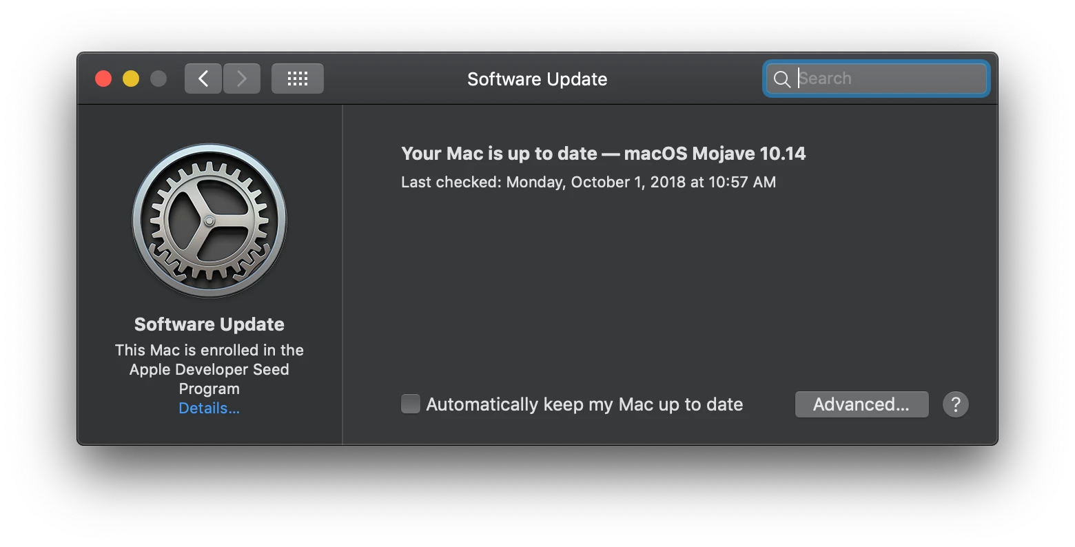

I acquired the Mojave installer using installmacos.py and when I run though and upgrade and check the software updates in sys pref, the window says checking for updates, and after it finishes checking the screen changes to say I'm participating in the developer program…

What build of the OS are you running?
18A391 or 18A389?
  • October 2, 2018
Same here.
I have downloaded Mojave’s from the AppStore and it’s byte for byte the same as the one produced by the script.
Problem only happens in an upgrade. If autodmg is used no url is set and it is fine.
Also using defaults delete to remove the url fixes the problem

@rderewianko should be 391…
@Lotusshaney so it's not my imagination?
  • October 2, 2018
Build is 391 and no its not just your imagination!

i downloaded from the mac app store and ran an upgrade w/o it being enrolled in the beta. So maybe something that the script is running when it downloads.
I'll open a bug on the git page.

Hello @jwojda I had the same problem. The thing is, I downloaded it on a Mac that at a previous time was enrolled in the BETA program. I have since downloaded it on a Mac that ISN'T in the BETA program. We will see if this fixes it for me.
  • October 2, 2018
I’ve done the same and I Think it may of fixed the problem. Let us know what you find

Hello @Lotusshaney and @jwojda I can confirm, the newly downloaded Mojave on a Mac NOT enrolled in the BETA program works fine. I still have issues with the darned user template folder causing issues, but that is for another discussion.
