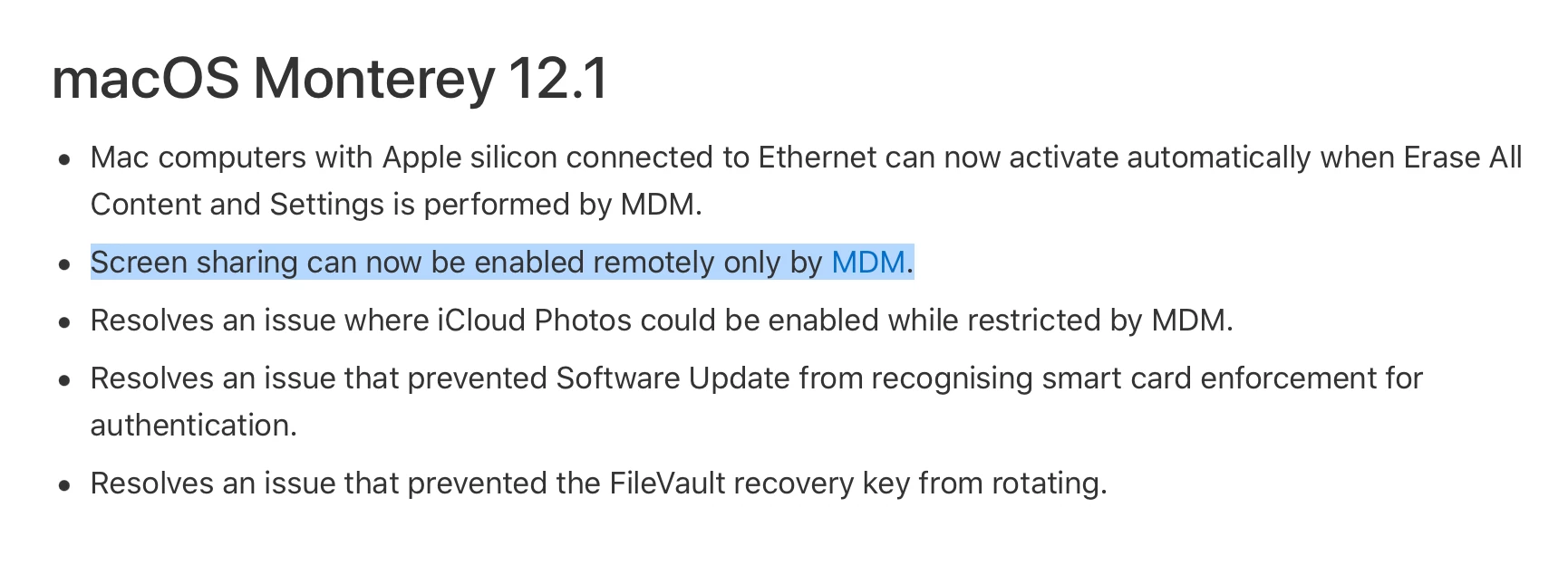

@prujamf I don’t have either of those scenarios setup to test but noticed this recent change note below;
macOS Monterey 12.1
  • Screen sharing can now be enabled remotely only by MDM.
https://support.apple.com/en-au/HT212586
Do you enable ARD via Jamf's api as part of your workflow and not just kickstart? Also make sure the following setting is enabled and you scope a PPPC payload as below to devices.
Use Screen Sharing to control a Mac that's enrolled in MDM

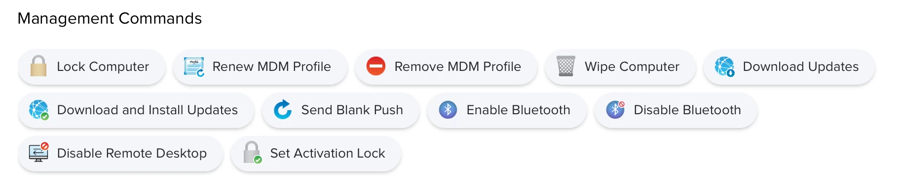

@Bol Thanks for suggesting enabling the three Restrictions for Screenshots, Airplay and Classroom. Unfortunately enabling these had no effect.
Oddly screensharing briefly worked on one of my test M1 Macs after updating the OS from 12.0 to 12.2. Same settings as before. Unfortunately it stopped working as soon as I rebooted the Mac.
Under the Jamf Management Commands I can successfully send "Disable Remote Desktop Command" , but don't get an option to enable again..
Best Regards,
Rob.

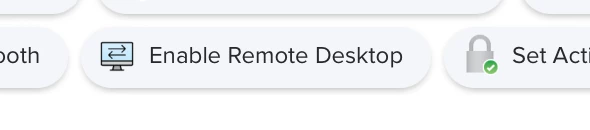

Because of Apple's changes, you now need to use MDM / Jamf to do this.
Either press the 'Enable Remote Desktop' button on the computer object in Jamf or you can script the same outcome by using the API (there's scripts on the forums you can try).

- As a test, I disabled remote desktop in Jamf
- Confirmed black screen during ARD connection
- Sending this command immediately re-connected screen session
/usr/bin/curl --request POST \\
--url "${jamfpro_server_address}/JSSResource/computercommands/command/EnableRemoteDesktop/id/$computerID" \\
--silent \\
--header "Authorization: Bearer $token"
Previously, I would use this to the same effect
/usr/bin/curl -Ssu "${jamfpro_user}:${jamfpro_password}" "${jamfpro_server_address}/JSSResource/computercommands/command/EnableRemoteDesktop/id/${computerID}" -X POST
Also to note, for whatever reason while testing on 12.2.1, it no longer displayed the warning message "Your screen is being observed”.
Previously it would show unless I reconnected in succession to the same machine. Even after a reboot and login, hilarious, I'll ignore that and save myself revisiting an old rabbit hole.

My tests so far:
  1. So from what you did, I disabled remote desktop to my Test-1 machine in Jamf.
    • I noticed immediately that it did in fact disable it when I checked my ARD console: I couldn't remote in.
    • I also noticed that in Jamf on my Test-1 machine, after a refresh, there was no "Enable Remote Desktop."
  2. Afterwards following the steps you took, I created a Policy with the following script: unfortunately failed.  Maybe I wasn't doing it right.
--silent \\
   3.  So I then I saw your reference to the Richard-Purves post on the API script and created another policy with the following script below.
computerrecord=$( /usr/bin/curl --request GET \\
--url "${jamfpro_server_address}/api/v1/computers-inventory?section=USER_AND_LOCATION&filter=udid%3D%3D%22${machineUUID}%22" \\
--silent \\
--header "Authorization: Bearer $token" )
computerID=$( /usr/bin/osascript -l 'JavaScript' -e "JSON.parse(\\`$computerrecord\\`).results[0].id" )
  • When I scoped this to my Test-1 machine, it ran and appeared to have been applied (the machine log indicated that it executed).
  • However in Jamf Pro it indicated that it failed.
  • BUT!  Interesting enough though... My Test-1 machine in Jamf now shows that Enable Remote Desktop.  I clicked it and it worked.  Once I did that, it does not show “Disable Remote Desktop.”
  • Is this a normal behavior?
  • How can I disable it so I can test if the my script above will work?

This is by design and the changes are noted here;
Your script will handle the ARD settings and allow you to connect fine. Although the blank screen can only be fixed by enabling Remote Desktop via MDM. Add into your script an API call to do this and it will work again.
I have this setup after enrollment as a policy / script and allows me to ARD to a machine, erase & wipe, then after enrollment my original ARD window reconnects again. Not that helpful but it works :D
Super curious about your script @obola. Especially, because it allows you to ARD to a machine and do that after enrollment. How did you avoid the black screen issue? Or, do you run this script with an "Enrollment Complete" trigger and then also press the. button to Enable Remote Desktop as well? Is it a two part process for you now?
