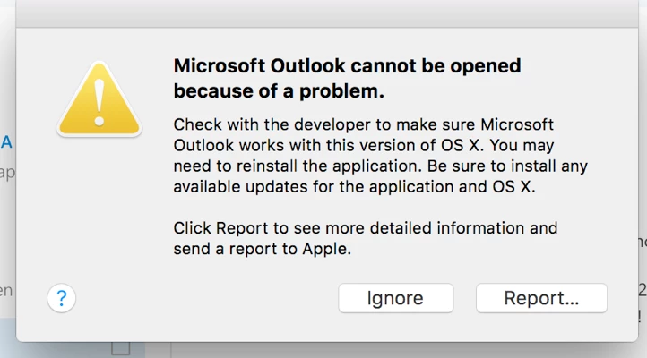

I've found that if the install is executing in the background (at the "Running Package Scripts" phase), and a user tries to launch an Office 2016 app, they'll encounter this error. When the install eventually finishes, they should be able to launch the applications fine.
I haven't had the time to invest in making a preventative solution, but just an FYI for those who might run into it. Basically, you need to make a script that is running for the duration of the install, and throwing an alert if a user tries to launch one of the apps and kills it. Mildly annoying.

@CAJensen01 We fight with the same issue here..although ours doesn't seem to recover at all. We have to re-install the entire office suite if the user opens it while the updater is in progress.
