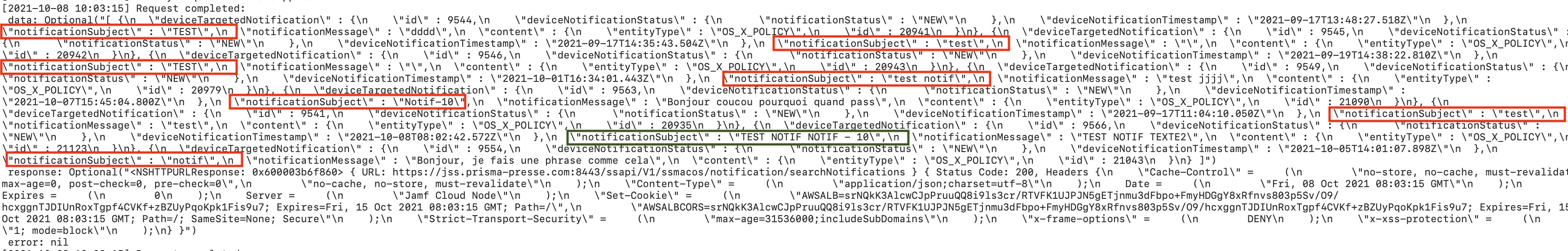

On the other hand, I don't know if this has to do with the notification problem, we noticed that each time we make available a policy with notification, on the workstations in scope, in the log file "selfservice_debug.log" , there is a mention of new notifications from policies that no longer exist in our JSS.
I am sending you as an attachment a capture of the part of the log file containing this information. I have framed you in red, the policies no longer exist in our JSS and in green, the good test policy made available to self-service with notifications.
We do not have this behavior with the test JSS.

But these "phantom" policies occur again in the "selfservice_debug.log" log file each time new policies are made available in the self service in the production instance.
I don't know if this has anything to do with our notifications issue but I share this with you.
