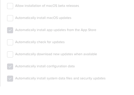

in our main config profile, we had everything here checked except Allow installation of macOS beta Releases until this morning. I'm also wondering if that could have caused any issues

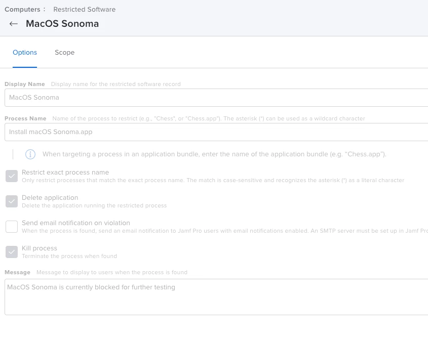

I also have Software Restrictions set up blocking the InstallAssistant and Install macOS Sonoma.app however this only blocks App Store downloads, USB-C installs or pkg installs etc.
