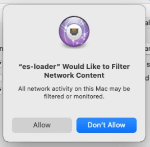

Hey guys... anyone know how to create a config profile for the Carbon Black Response network filter on Big Sur???

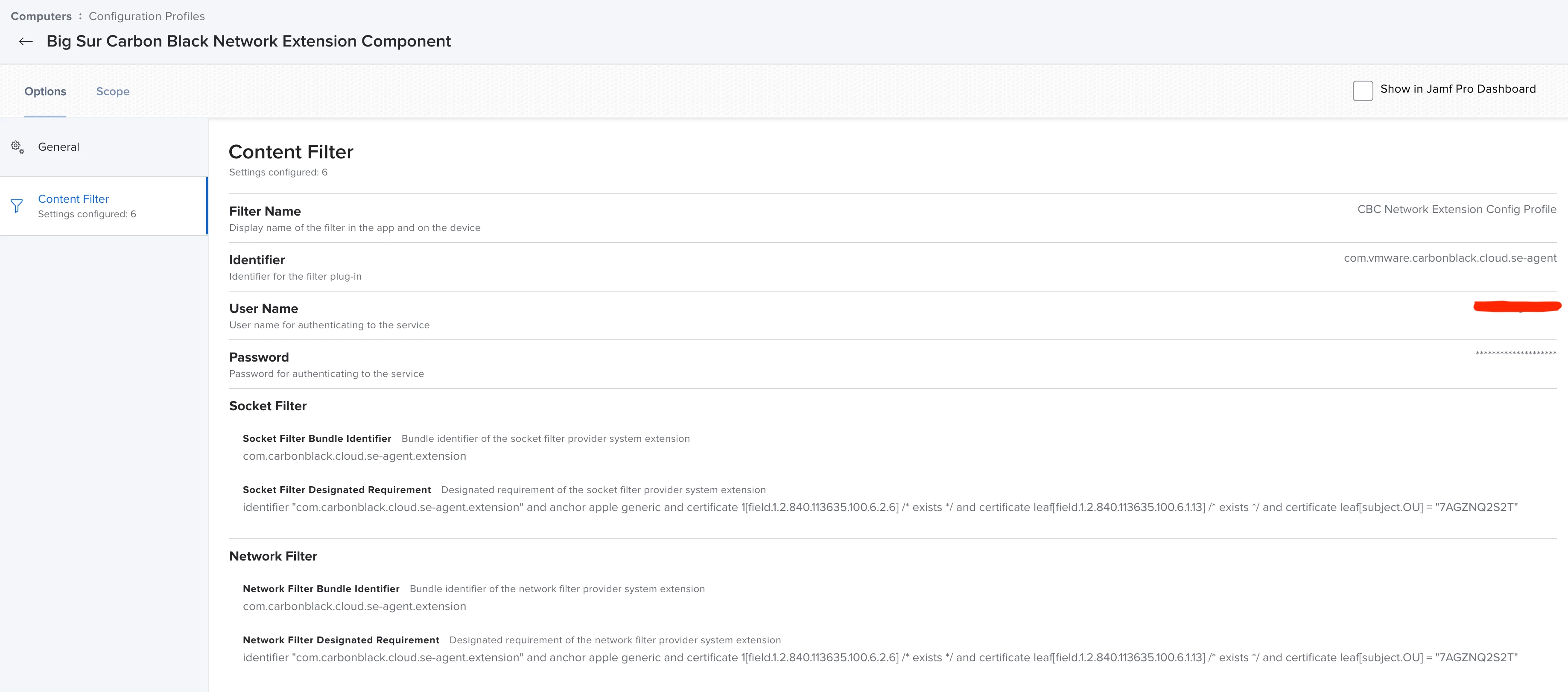

Instructions from CBC
VMware, Inc.
Carbon Black Cloud Sensor MDM-instructions.txt (August 18, 2020)
I. MDM Kext Approval Configuration Approving Carbon Black KEXTs via MDM can be accomplished via a KEXT Approval Configuration Payload. The recommended way to deliver this configuration is through the provided MDM-KEXT-approval.mobileconfig file. This mobileconfig provides the necessary configuration which can be uploaded to your organization's MDM-compatible software deployment tool. To construct this configuration manually, you must specify the Apple Team ID and KEXT bundle in your configuration profile Apple Team ID: 7AGZNQ2S2T KEXT Bundle ID: com.carbonblack.defense.kext
KEXT post install approval on Big Sur (Introduced in Big Sur Beta 10): In order to allow the KEXT to load on MacOS Big Sur, the OS either requires a local action from an admin to approve the KEXT after install, or a customized reboot command from your MDM, to rebuild the Kernel Cache. Please see Apple documentation here: https://developer.apple.com/documentation/devicemanagement/restartdevicecommand/command The recommended way to deliver this configuration is through the provided MDM-KEXT-reboot-command.xml file. This XML file should be uploaded as a Custom Command and sent to endpoints after KEXT install. Note that this will reboot the target machine without warning, and that this distribution method is a temporary workflow until MDM providers update their reboot protocols to support RebuildKernelCache.
II. MDM System Extension Approval Configuration Approving Carbon Black System Extensions via MDM can be accomplished via a System Extension Approval Configuration Payload. The provided MDM-SYSEXT-approval-mobileconfig-sample.txt provides a snippet of an example mobileconfig that correctly implements this profile. To construct the correct configuration, you must specify the Apple Team ID and System Extension bundle in your configuration profile System Extension Types: Allowed System Extensions Apple Team ID: 7AGZNQ2S2T System Extension Bundle ID: com.vmware.carbonblack.cloud.se-agent.extension
III. MDM Network Extension Web Content Filter Configuration Granting the Network Extension component of the Carbon Black System Extension access to filter network content can be accomplished via a Web Content Filter Payload. The recommended way to deliver this configuration is through the provided MDM-SYSEXT-network-extension-approval.mobileconfig file. This mobileconfig provides the necessary configuration which can be uploaded to your organization's MDM-compatible software deployment tool after it is signed by your organization's signing tool. These instructions were created using Apple documentation and ProfileCreator (found here: https://github.com/ProfileCreator/ProfileCreator) When exporting this profile, the profile should be signed to enable distribution via MDM. To construct this configuration manually: The fields should be completed exactly as follows. Please copy and paste for accuracy. In the General payload: Payload Scope should be set to: System In the Web Content Filter payload: Filter Type should be set to: Plug-In Plug-In Bundle ID: com.vmware.carbonblack.cloud.se-agent Check Enable Socket Filtering Filter Data Provider System Extension Bundle ID (macOS): com.vmware.carbonblack.cloud.se-agent.extension Filter Data Provider Designated Requirement (macOS): identifier "com.vmware.carbonblack.cloud.se-agent.extension" and anchor apple generic and certificate 1[field.1.2.840.113635.100.6.2.6] / exists / and certificate leaf[field.1.2.840.113635.100.6.1.13] / exists / and certificate leaf[subject.OU] = "7AGZNQ2S2T" Check Enable Packet Filtering (macOS) Filter Packet Provider System Extension Bundle ID (macOS): com.vmware.carbonblack.cloud.se-agent.extension Filter Packet Provider Designated Requirement (macOS): identifier "com.vmware.carbonblack.cloud.se-agent.extension" and anchor apple generic and certificate 1[field.1.2.840.113635.100.6.2.6] / exists / and certificate leaf[field.1.2.840.113635.100.6.1.13] / exists / and certificate leaf[subject.OU] = "7AGZNQ2S2T"
IV. MDM Privacy Preferences Payload Configuration Granting an application full disk access via MDM can be accomplished via a Privacy Preferences Payload. The recommended way to deliver this configuration is through the provided MDM-privacy-config.mobileconfig file. This mobileconfig provides the necessary configuration which can be uploaded to your organization's MDM-compatible software deployment tool. To construct this configuration manually, we must add four identifiers into this Privacy payload. The fields should be completed exactly as follows. Please copy and paste for accuracy. 1) Identifier: com.vmware.carbonblack.cloud.daemon Identifier Type should be set to: Bundle ID Code Requirement: identifier "com.vmware.carbonblack.cloud.daemon" and anchor apple generic and certificate 1[field.1.2.840.113635.100.6.2.6] / exists / and certificate leaf[field.1.2.840.113635.100.6.1.13] / exists / and certificate leaf[subject.OU] = "7AGZNQ2S2T" App or Service should be set to: SystemPolicyAllFiles Access should be set to: Allow 2) Identifier: com.vmware.carbonblack.cloud.se-agent.extension Identifier Type should be set to: Bundle ID Code Requirement: identifier "com.vmware.carbonblack.cloud.se-agent.extension" and anchor apple generic and certificate 1[field.1.2.840.113635.100.6.2.6] / exists / and certificate leaf[field.1.2.840.113635.100.6.1.13] / exists / and certificate leaf[subject.OU] = "7AGZNQ2S2T App or Service should be set to: SystemPolicyAllFiles Access should be set to: Allow 3) Identifier: com.vmware.carbonblack.cloud.osqueryi Identifier Type should be set to: Bundle ID Code Requirement: identifier "com.vmware.carbonblack.cloud.osqueryi" and anchor apple generic and certificate 1[field.1.2.840.113635.100.6.2.6] / exists / and certificate leaf[field.1.2.840.113635.100.6.1.13] / exists / and certificate leaf[subject.OU] = "7AGZNQ2S2T" App or Service should be set to: SystemPolicyAllFiles Access should be set to: Allow 4) Identifier: com.vmware.carbonblack.cloud.uninstall Identifier Type should be set to: Bundle ID Code Requirement: identifier "com.vmware.carbonblack.cloud.uninstall" and anchor apple generic and certificate 1[field.1.2.840.113635.100.6.2.6] / exists / and certificate leaf[field.1.2.840.113635.100.6.1.13] / exists / and certificate leaf[subject.OU] = "7AGZNQ2S2T" App or Service should be set to: SystemPolicyAllFiles Access should be set to: Allow 5) Identifier: com.vmware.carbonblack.cloud.uninstallerui Identifier Type should be set to: Bundle ID Code Requirement: identifier "com.vmware.carbonblack.cloud.uninstallerui" and anchor apple generic and certificate 1[field.1.2.840.113635.100.6.2.6] / exists / and certificate leaf[field.1.2.840.113635.100.6.1.13] / exists / and certificate leaf[subject.OU] = "7AGZNQ2S2T" App or Service should be set to: SystemPolicyAllFiles Access should be set to: Allow

Has anyone been able to create a working config profile to eliminate this pop-up? I built Config profiles for MDM Network Extension Web Content Filter Configuration using ProfileCreator and I still have the popup on devices that have the config profile installed prior to installing VMWare Carbon Black.
Been trying to fix for the last 3 days!

I still get the popup "com.carbonblack.es-loader" to filter Network Content. I attached my Config Profile. Can anyone assist in getting this resolved for me?

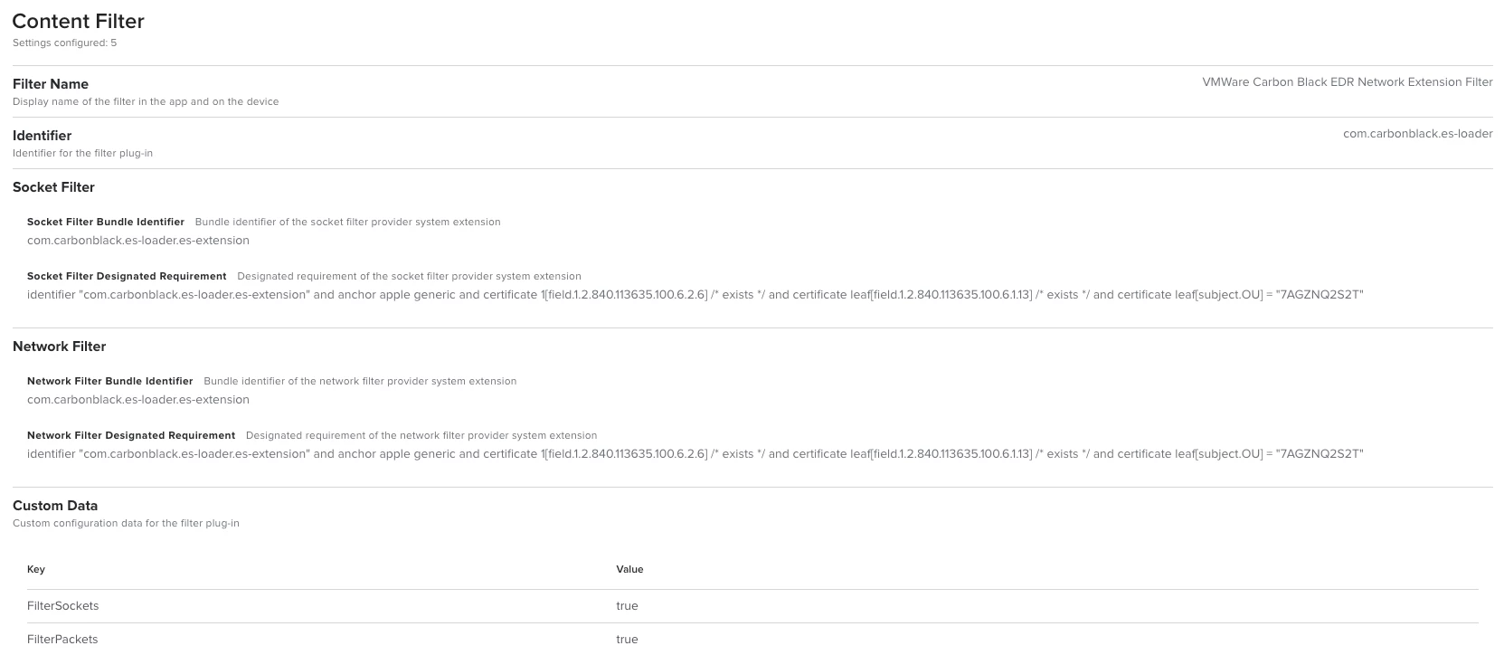

  • June 7, 2021
I have the following configuration and do not see the Network Filter popup. The app itself that we have in our environment is "VMWare Carbon Black EDR".
