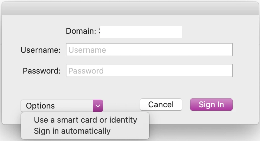

Hi everybody,
By any chance, do you know how to:
- Remove or replace the @domain in SSO menu in toolbar
- Remove the "Options" field when user wants to authenticate
Thanks :)
Eltord
  • May 13, 2020
Those are a couple things I've asked our rep on as well. They've been put in as feature requests. I'm actually meeting with APS next week to go over some things with the Kerberos Extension SSO, hopefully will get closer to being able to replicate EC and make it an easier transition for all.

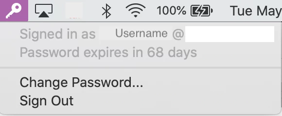

Curious if the days to expiration is still configurable so it shows when rolling over the icon, as it did when we used Enterprise Connect? Users can click on the icon and see how many days they have now, so not a big issue, just curious.
Thankfully changing your password through the SSO syncs back to your FileVault 2 password (like Enterprise Connect did).

@Karl941 I actually asked the Apple engineers this exact question as well as if its possible to set up the "Automatically sign in" button to just default answer yes instead of requesting to users, and the ability to hide the additional options dropdown menu in the main window, but so far those aren't available. I was hoping to get more from the updates from wwdc.
@donmontalvo I've never had EC do that, where it just shows when rolling over the icon before, i've always had users have to click it in order to see the days remaining. That would be an interesting feature to add, but seeing how there are still a lot of features missing to provide better parody between the two tools, I doubt that something like that would be high on the list.
