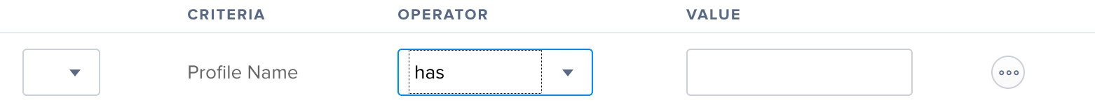

However, Configuration Profiles are standard Smart Group criteria items these days, so there shouldn't be a need for an Extension Attribute for each one.
When in Criteria, click on Show Advanced Criteria and look for "Profile Name" From there, you will be able to choose a name from a list by clicking the ellipses button and choosing one. Or you can enter your own if needed.
With this approach, you can be reasonably sure that whatever KEXT approval profile is needed before the software is installed is there.
