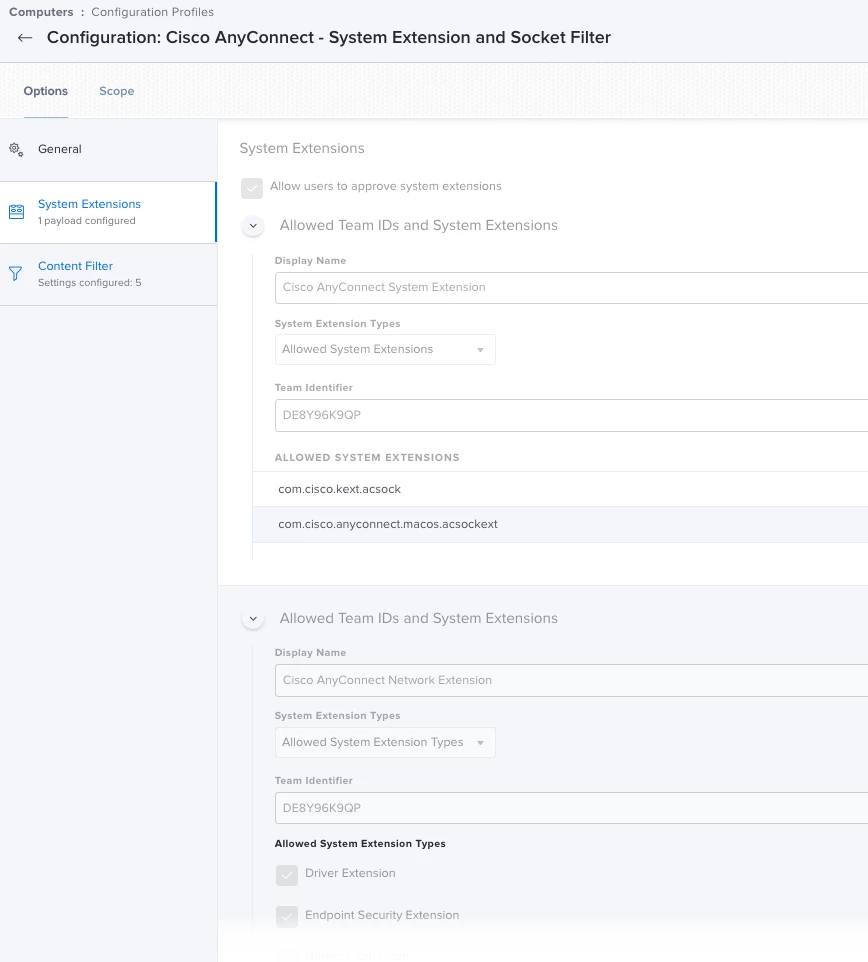

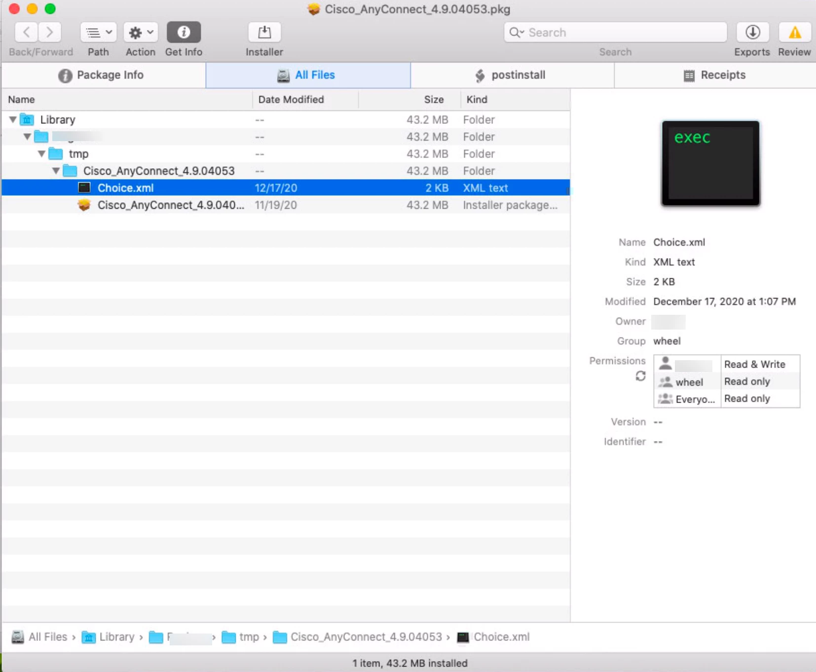

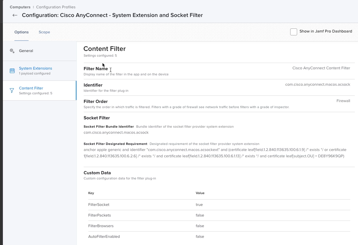

@Professional most of the stuff between AnyConnect 4.8 and 4.9 should be the same, but keep in mind that 4.8 is for Catalina and 4.9 is for Big Sur.
We are running the AnyConnect package with the choices xml below. Just shove the pkg you get from the ASA and the choices.xml (must be named that for anyconnect to pick it up) in the same directory and repackage them with the post install script below. Cisco could make this much less convoluted and document it better, but then would it really be cisco?
## postinstall
pathToScript=$0
pathToPackage=$1
targetLocation=$2
targetVolume=$3
sudo installer -pkg /Library/{folder name}/tmp/Cisco_AnyConnect_4.9.04053/Cisco_AnyConnect_4.9.04053.pkg -target / -applyChoiceChangesXML /Library/{folder name}/tmp/Cisco_AnyConnect_4.9.04053/choice.xml
exit 0      ## Success
exit 1      ## Failure
Choices.xml. Flip 1's and 0's based on what you need disabled and enabled. As Cisco adds more keys they would have to be added to this XML to be told to install or not.

Script works great thx for sharing. As I build this deployment further there are a few other things to address, can you advise?
1. After installation, there is an immediate alert that the "AnyConnect System Extension is blocked", do you have this built into your deployment?
2. Message appears, "Cisco AnyConnect Socket Filter would like to filter network content", there are "Allow" and "Don't Allow" buttons. Can these preferences be set so this box doesn't appear?
3. Do you deploy the cert, if so, how?
4. Do you deploy the .json file to /opt/cisco/anyconnect/Umbrella/? If so, how?
Sounds like you are missing the configuration side of things. AnyConnect needs several configuration profiles to install silently. The link below should cover most of what you need to get AnyConnect working. Take it with a grain of salt as with most Cisco documentation, it is horribly outdated and they never look at it.
AnyConnect macOS 11 Big Sur Advisory - Cisco
  1. You need a configuration profile to approve the system extension.
  2. You need a configuration profile to approve the socket filter. Be aware the configuration profile must be installed BEFORE the socket filter or it will need user approval.
  3. You will need a configuration profile to deploy a qualifying certificate. Consult with your security teams on the requirements. JAMF can deploy AD, AD CS, SCEP, and custom uploaded certificates among others. Its all down to what you need.
  4. We do not use umbrella so I cannot speak from experience on that.

Wow all very helpful, thanks. Can you share a screenshot of the socket filter settings you have? Like you said their documentation is less than optimal, so I am am having some trouble translating their language in the article to the Jamf config profile.
Oh, its beyond that. The "code" as Cisco calls it is bad, they need to rewrite it. I was in a pretty lengthy TAC with them over it. After 3 months of them trying to find someone who knows the "code" I finally gave up and rewrote the JSON. Cisco tried to get me to give them the mobileconfig I wrote and I said no, maybe if they did not lead me on for 3 months but I was pretty salty.
because no body likes typing from a screenshot
Socket Filter Designated RequirementDesignated requirement of the socket filter provider system extension anchor apple generic and identifier "com.cisco.anyconnect.macos.acsockext" and (certificate leaf[field.1.2.840.113635.100.6.1.9] /* exists */ or certificate 1[field.1.2.840.113635.100.6.2.6] /* exists */ and certificate leaf[field.1.2.840.113635.100.6.1.13] /* exists */ and certificate leaf[subject.OU] = DE8Y96K9QP)
