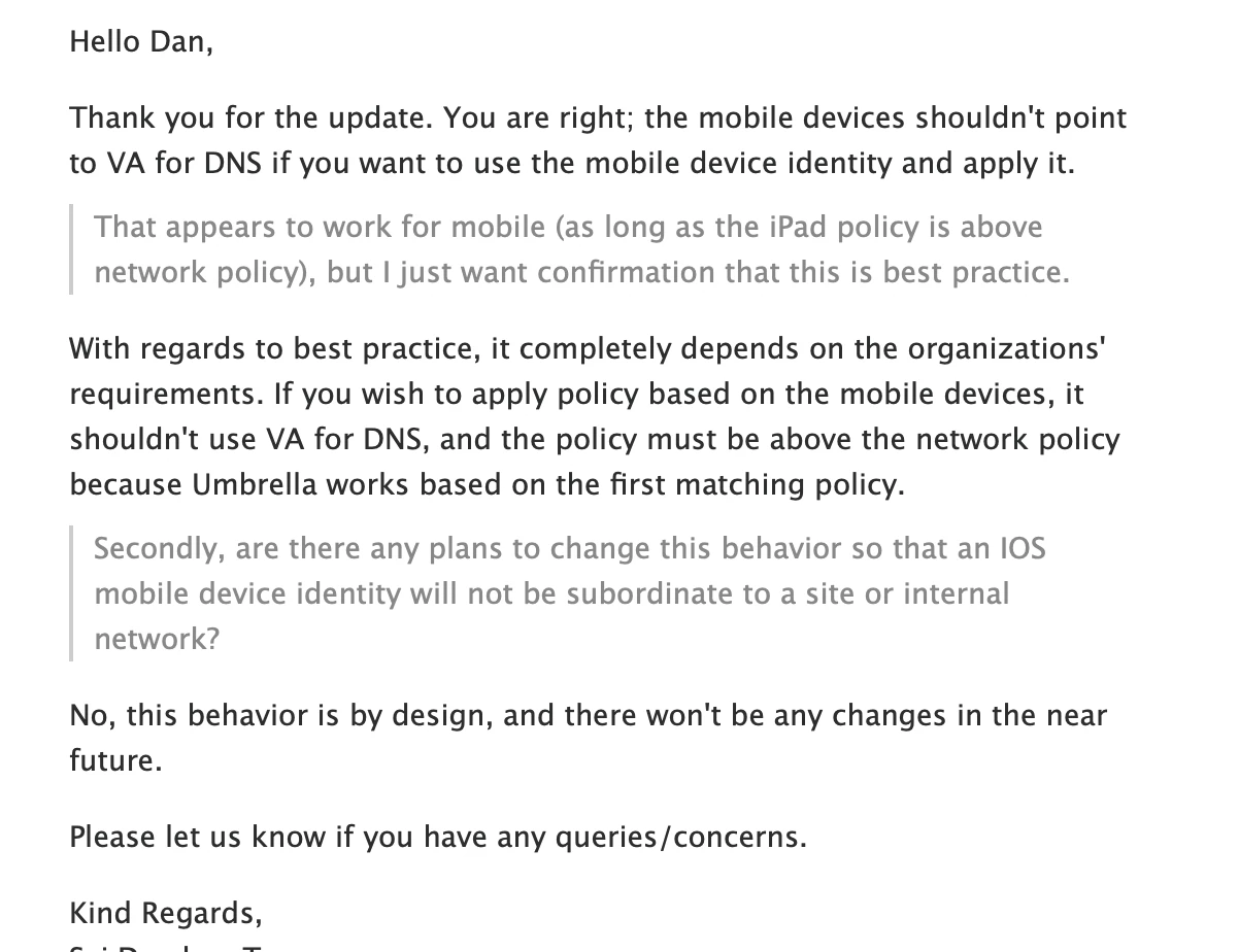

I found the answer on this, confirmed by cisco and testing - if you want the mobile device policy to continue to be applied while on-premise, the devices need to not use the on-premise Umbrella VA's for DNS resolution. Beyond that, because policies are applied in order from top to bottom, the mobile device policy needs to be above the default policy (which is applied to the site because of the trusted network egress IP).
So in our case, that means having the iPads join a subnet configured to supply our standard AD DNS servers in the DHCP response rather than the Umbrella VAs. Then we get our granular policy application from the mobile identity (and roaming client identities) same as off-premise, but with the default policy being catch-all for any device egressing from the site that doesn't have the Connector App or roaming client. Another option would have been grouping the iPads on unique internal subnet (via separate SSID, VLAN derivation, etc.) and applying a unique policy to that internal network. But that seems harder to do for grade-level specific grouping.
