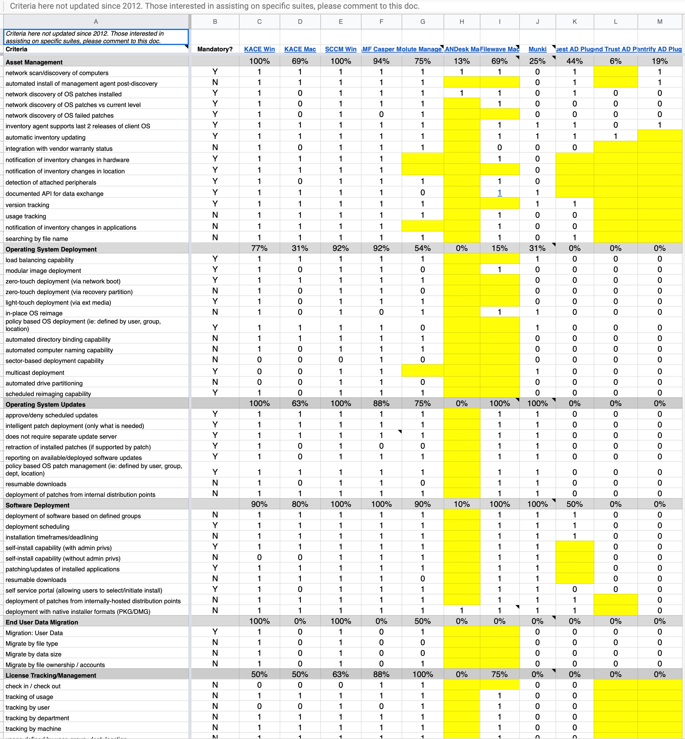

There is https://www.gartner.com/reviews/market/enterprise-mobility-management-suites/vendor/jamf-software/product/jamf-pro-formerly-casper-suite
If you are looking for an approach how to structure a comparison there is an (old) "recipe" from 2012 MacSysAdmin Gotenburg presentation" Casper Andrina Kelly" http://bit.ly/testingmatrix (https://docs.google.com/spreadsheets/d/15umBgKAeoWbWHlHwQtTmYhyc9_05hyLwn9a4JHwihCs/edit?hl=en_US&hl=en_US#gid=0)
Of course: Criteria are not updated since 2012 - so MDM, DEP, VPP, intune Integration, Cloud, etc. are missing...

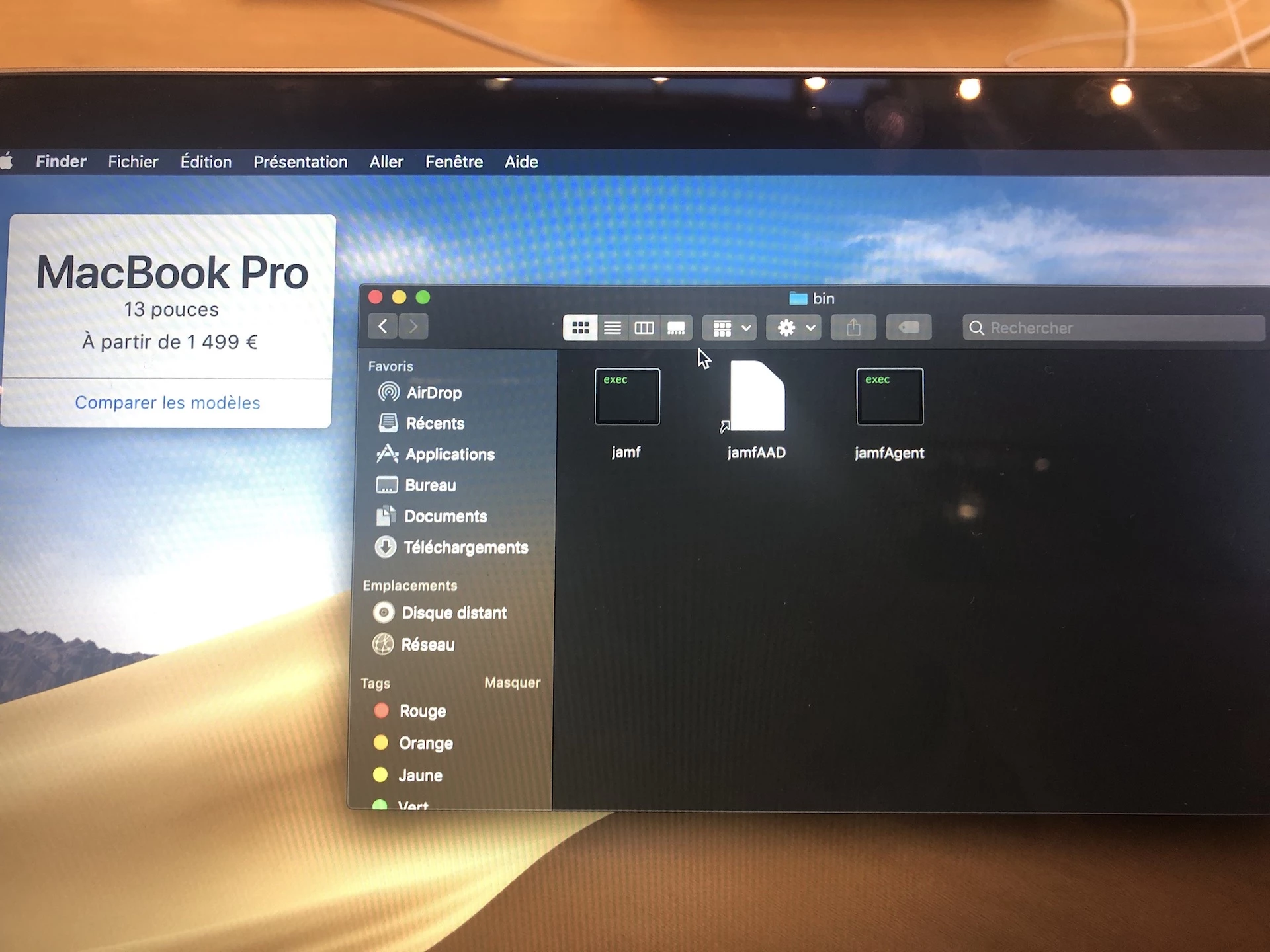

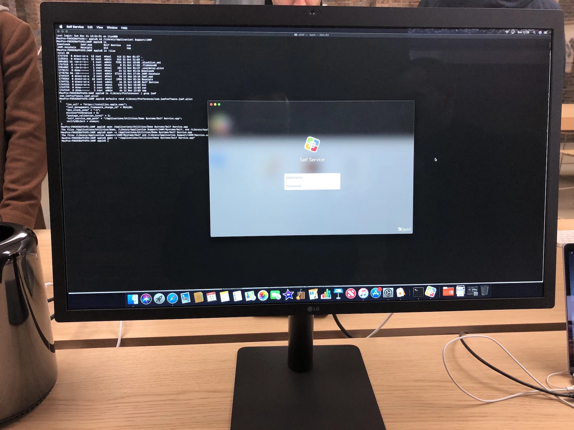

@afarnsworth Regarding Apple Retail:
Apple Covent Garden in London, from last November:
Apple Opera Paris, from February:
