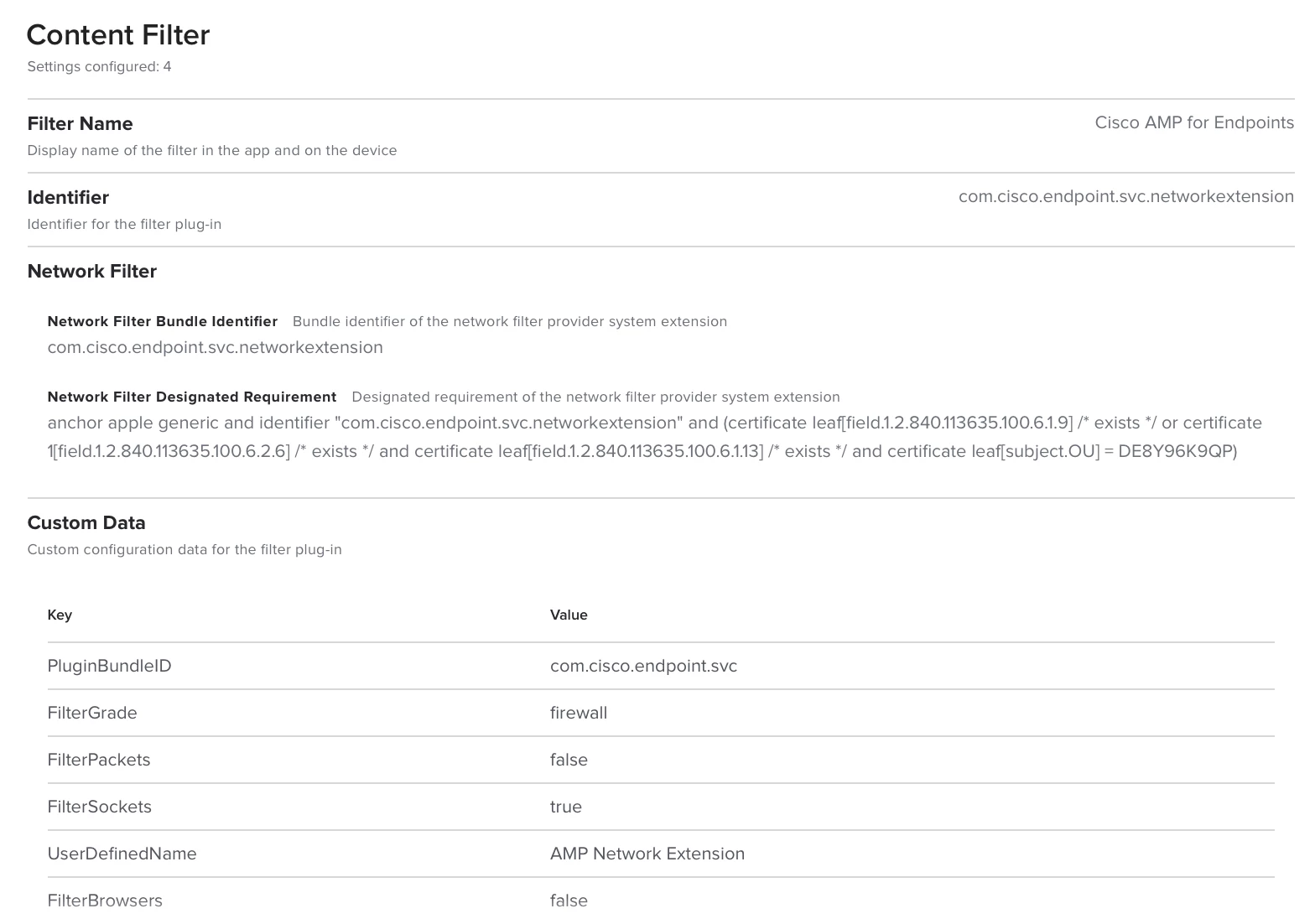

Hi.
Just seen that Jamf Pro 10.26.0 supports the Content Filter (New Payload) to provide compatibility with macOS Big Sur 11 so hopefully all the nonsense in this thread goes away.

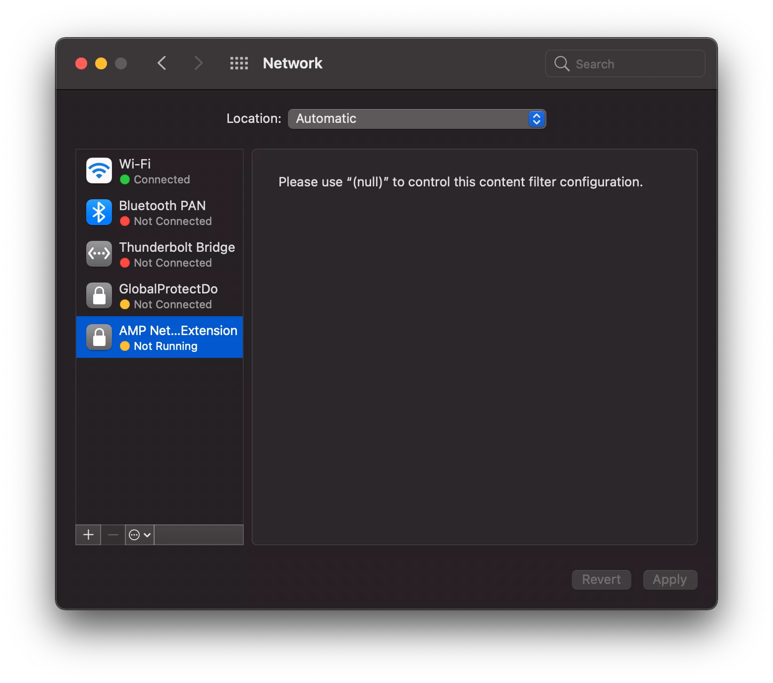

I tried making a Config Profile with the WebContentFilter for AMP (and another for AnyConnect), and pushed it to a 10.15.7 system. It shows applied in the System Preferences > Profiles section however the OS still prompts for an AMP WebContent Filter with approve or deny. I selected Deny, then rebooted, the AMP icon no longer complains about needing the Filter but this is quite clunky, you would like to it auto approve the Filter so the end user wouldn't see any popups. Does anyone have any ideas about this?

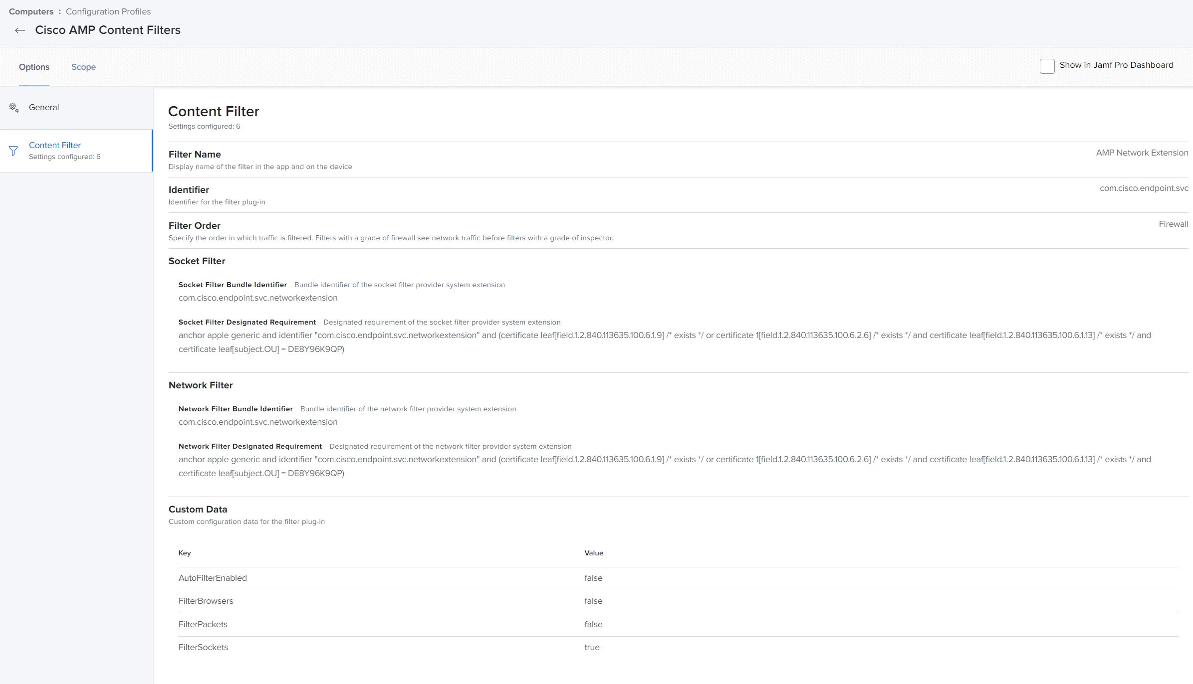

We just got 10.26 and I'm working on the AMP WebContentFilter. Anyone have that working yet in their Config profile? I'm not sure I'm setting it right by the Cisco doc - https://www.cisco.com/c/en/us/support/docs/security/amp-endpoints/216089-advisory-for-amp-for-endpoints-mac-conne.html
Here is what my setting looks like:
@ccliff I created my config profile the other day and just tested on a freshly installed/enrolled Big Sur 11.0.1 machine. AMP 1.14 installed fine with no prompts and no faults. Attached is what my config profile looks like. I believe either the socket or network filter I set might be redundant or unneeded, but it works so I'm leaving it be and not tempting fate. :P
@ajc196 Thanks for that help. I missed the FilterOrder so and I had a few things not typed in correctly. I can now get the install to go without that web filter prompt which is good but I noticed that the filter is inactive in my network settings - see the screen shot I'm attaching to this post. Also on a system without the web filter in the config profile where I had to click on the Allow, the web filter entry is green and the text is not "null" but says "AMP for Endpoints Service". Is the web filter entry in your Network settings showing it's active?
