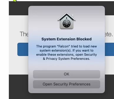

I already set the configuration profile, but crowstrike full disk approval still shows / require? any advise

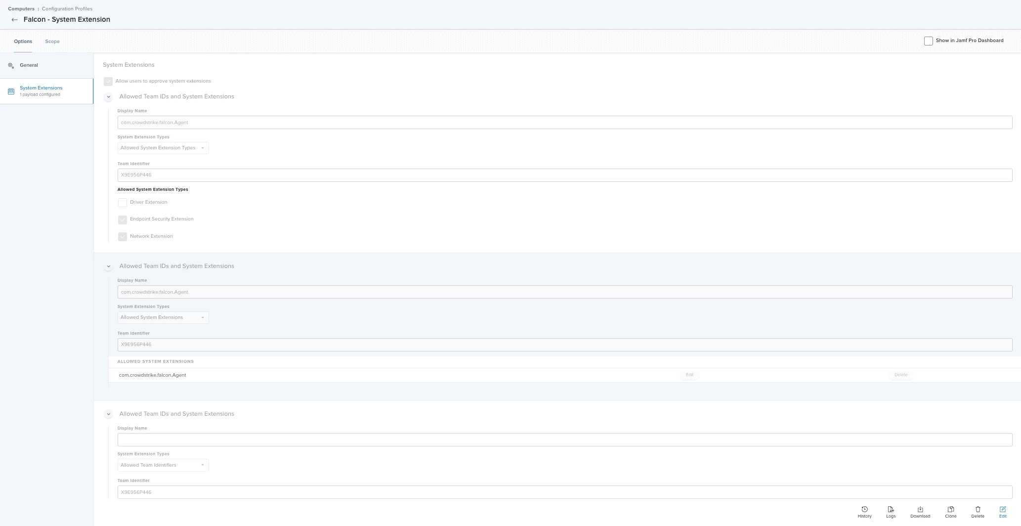

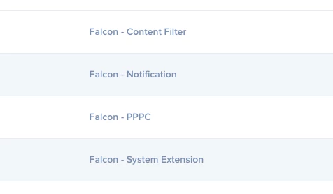

This is what our System Extension looks like for Falcon.
For us, we split them into different ones. I can see that you have everything in one profile, that should work too as long as you have everything added.

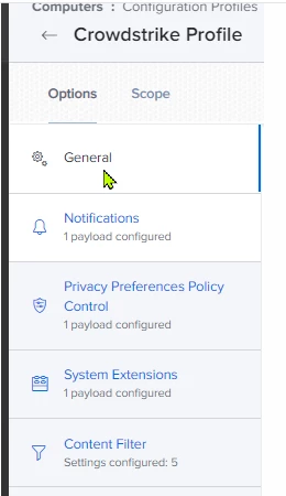

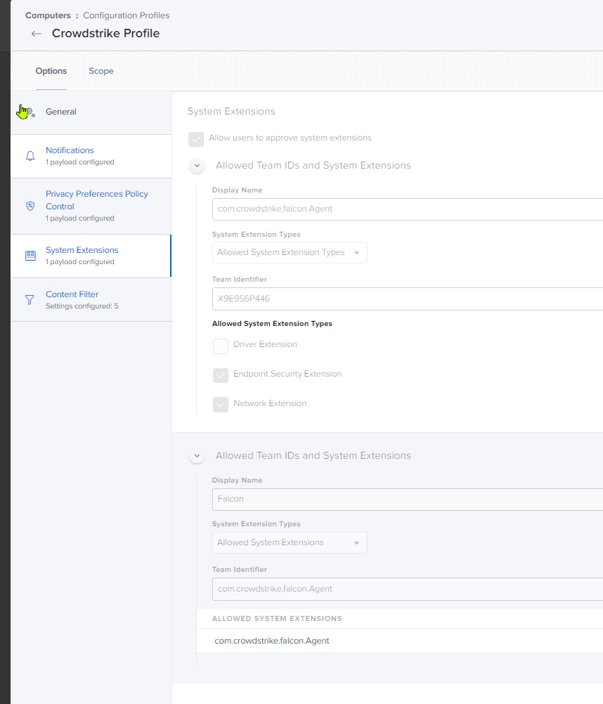

my setting is like this :   seems like missing the bottom one you set?
  • May 24, 2022
