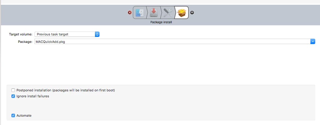

Is there anyone out there using Deploy Studio for netboot imaging and Casper for management?
We are currently looking into going back to Deploy Studio for imaging as we've had major headaches with Casper Imaging (netboot). I thought by putting a base image of an OS made with AutoDMG into Deploy studio then pairing that workflow with a quickadd.pkg would be the solution. However the pkg install keeps failing:
2016-12-20 10:12:22.939 DeployStudio Runtime.bin[298:16022] installer: Package name is MACQuickAdd
2016-12-20 10:12:22.939 DeployStudio Runtime.bin[298:16022] installer: Installing at base path /Volumes/Macintosh HD
2016-12-20 10:12:22.939 DeployStudio Runtime.bin[298:16022] installer:PHASE:Preparing for installation…
2016-12-20 10:12:23.006 DeployStudio Runtime.bin[298:16022] installer:PHASE:Preparing the disk…
2016-12-20 10:12:23.054 DeployStudio Runtime.bin[298:16022] installer:PHASE:Preparing MACQuickAdd…
2016-12-20 10:12:23.082 DeployStudio Runtime.bin[298:16022] installer:PHASE:Waiting for other installations to complete…
2016-12-20 10:12:23.588 DeployStudio Runtime.bin[298:16022] installer:%81.422057
2016-12-20 10:12:23.588 DeployStudio Runtime.bin[298:16022] installer:PHASE:Running package scripts…
2016-12-20 10:12:24.083 DeployStudio Runtime.bin[298:16022] installer:%83.471267
2016-12-20 10:12:24.083 DeployStudio Runtime.bin[298:16022] installer:PHASE:Running package scripts…
2016-12-20 10:12:24.586 DeployStudio Runtime.bin[298:16022] installer:%85.325652
2016-12-20 10:12:24.586 DeployStudio Runtime.bin[298:16022] installer:PHASE:Running package scripts…
2016-12-20 10:12:25.086 DeployStudio Runtime.bin[298:16022] installer:PHASE:Running package scripts…
2016-12-20 10:12:26.095 DeployStudio Runtime.bin[298:16022] installer:%97.750000
2016-12-20 10:12:26.095 DeployStudio Runtime.bin[298:16022] installer: The install failed (The Installer encountered an error that caused the installation to fail. Contact the software manufacturer for assistance.)
We've tried setting the pkg to install during imaging and upon reboot.

You do need to Postpone until first boot. DeployStudio when your imaging is running from a NetBoot image. If you install without the postpone, your trying to install on that NetBoot image. AutoDMG is also a good choice. Works very well.

It should absolutely work when run after the reboot. Its how we primarily do this. We use DeployStudio still for imaging here as well.
Quick question, but are you using a QuickAdd package install built out of Recon.app, or did you grab one downloaded from an enrollment page? It needs to be the former, not the latter. The latter is designed for single use, not for an imaging process.

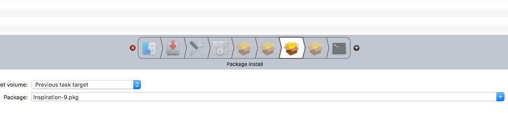

@millersc That's exactly what we are working on accomplishing with DS. We still want software to be modular and build on top of the base image. Right now we're adding all our pkgs from the JSS into the DS pkgs folder and putting them into a workflow to test.

@Look Not using a compiled config seems to make the process take 2-3x longer for us. I can see what you mean by how it might speed things up in certain instances. We just threw a base image of 10.11.6 into Deploystudio and bundled software PKGs in line with that along with the casper quickadd pkg. This accomplishes the same thing you're describing except the DS netboot is much faster and consistent. Not having to log into DS, using a script in the workflow that deletes it out of the JSS before re imaging are all major time savers when imaging hundreds at a time. It's nice that DS has it's own database to, so deleting the computers out of the JSS will not affect computer names at imaging time. We've even been able to export our computer names from JSS and import them into DS. To further optimize our DS workflow we can compile our software PKGs using AutoDMG with a 10.11.6 installer to accomplish a DMG compile without being prompted for admin rights 5 times like in Casper Admin. Overall even if we got Casper Imaging's kinks worked out I still see all the small benefits accumulating and causing DS reign supreme for us.
