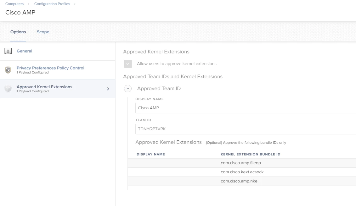

How does Cisco deploy the PPPC and Approved Kernel Extensions via Jamf?
I'm trying to do this on Big Sur with AMP v1.16 and it seem things have changed from Catalina.

It's all documented here: https://www.cisco.com/c/en/us/support/docs/security/amp-endpoints/216089-advisory-for-amp-for-endpoints-mac-conne.html

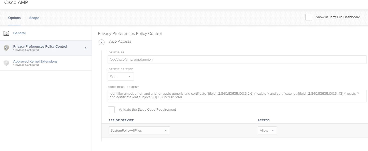

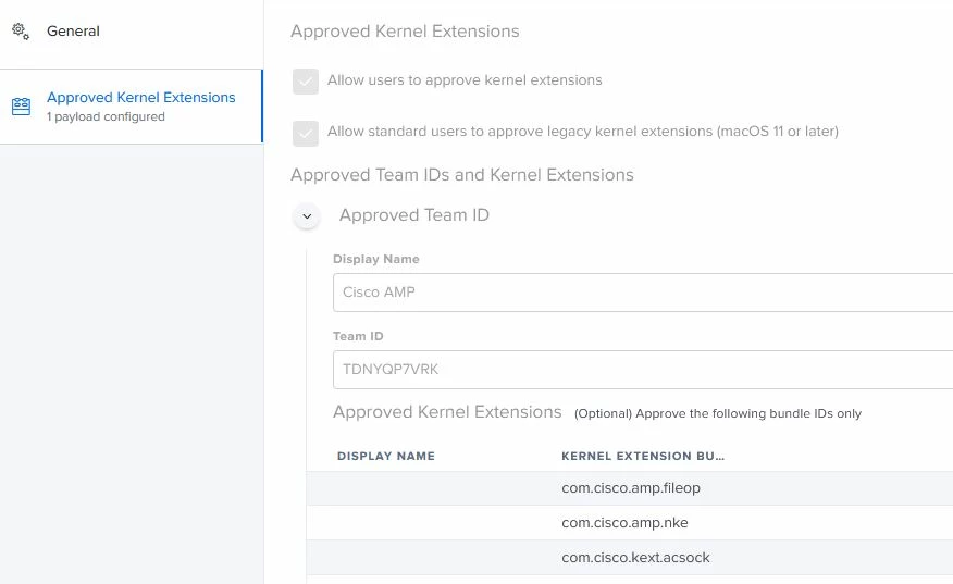

@Echterling This is what my configuration profile looks like. My deployment is based on this post and its working fine.

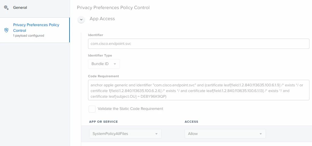

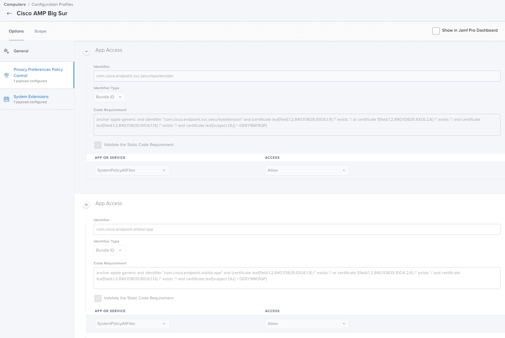

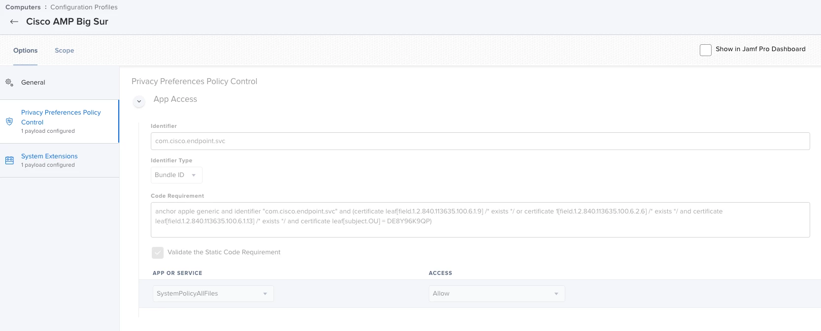

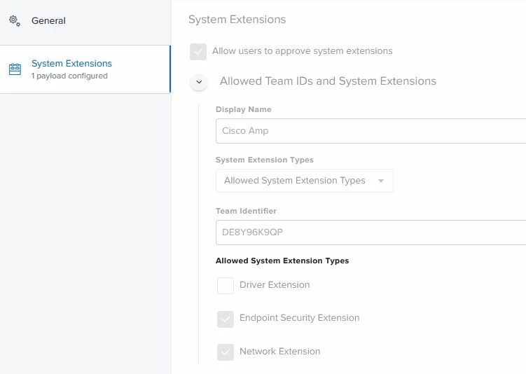

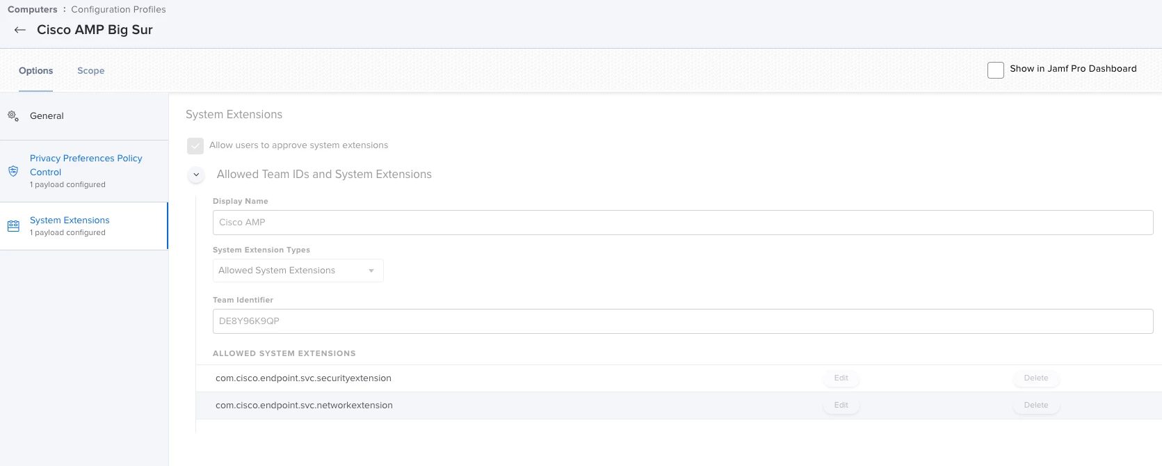

Could someone check my work and see if I've built these correctly?
I'm still getting the "requests to allow" prompts in security and privacy when installing it.
Also, any suggestion on how to push the config for full disk access?

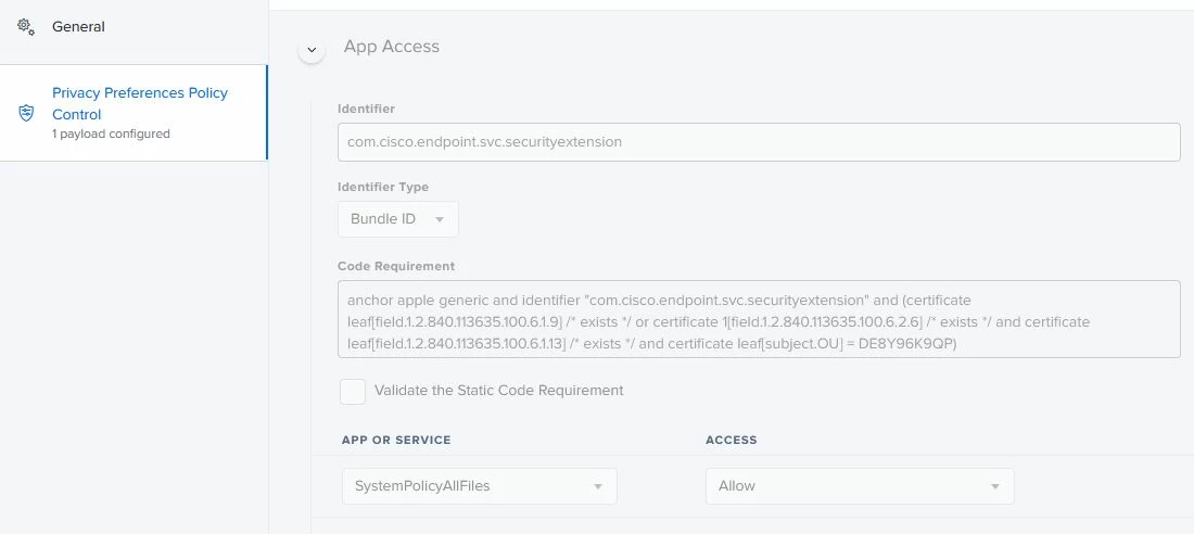

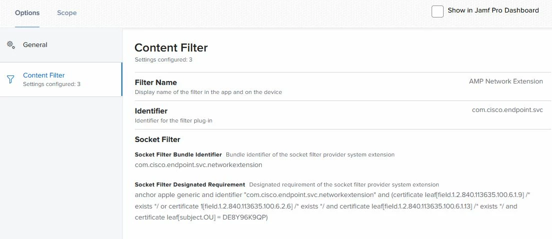

@winterboerI don't have time to confirm your profiles right now but I don't see a Content Filter.  Also, it's suggested to make individual profiles for each settings, kernel, system, pppc and content filter so that you can scope things better per version of macOS.  Something else to keep in mind, the profiles need to be installed and the system rebooted prior to installing AMP or you will still get the prompts.  At least that is my experience.

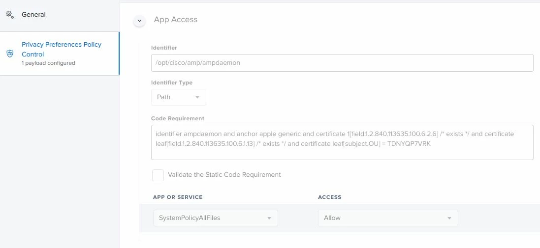

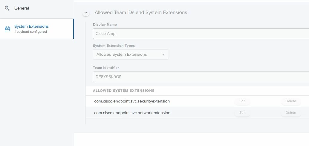

@winterboerHere are my profiles, all separate for scoping.  These work for us, provided they are installed to Big Sur and the system rebooted before Cisco AMP is installed.  Note, Kernel extensions aren't scoped to Big Sur.
I had to upgrade JAMF to the latest build and now can test what you've posted. Thank you very much for the help.

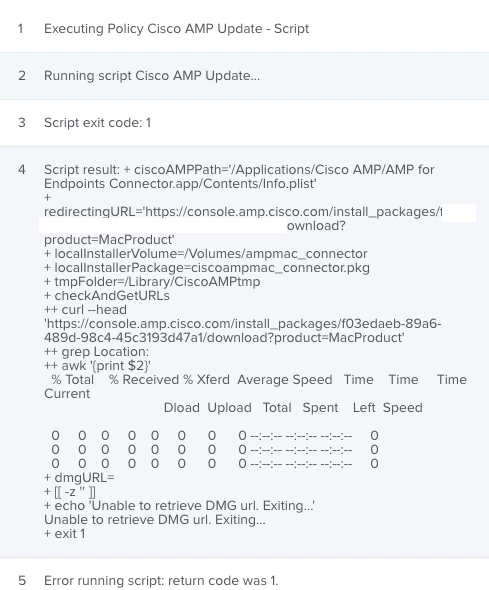

I guess I don't know how to use the script that @iJake has kindly offered up. I've loaded it up in jamf and see this.  What am I missing or doing wrong?
@winterboerMight want to remove your AMP URL from that photo. Might not. 😉  Your download works, I see it's 32 MB.  I'm deploying 1.15.6.842 (29.2 MB) tested and still working this morning.  Perhaps something has changed with a newer version?
Also, as noted above, Location changed to location (which I edited in my script).  Perhaps you just need to add a -i to the grep command.
++grep Location: to ++grep -i Location:
Line 13 in my script:
dmgURL=$(curl --head "$redirectingURL" | grep -i "Location:" | awk '{print $2}')
Thank you very much for the reminder. I've cleaned it. I'll mod the script and see what happens.
