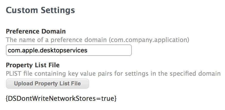

We have a handful of edit stations, we tend to run into permissions error as an editor will drag an entire folder from their desktop to an smb / omfs share. I'd like to disable DS_Store on a scope of stations.
I was experimenting with the "Custom Settings" section of the JSS. I wrote the following:
defaults write com.apple.desktopservices DSDontWriteNetworkStores true
cp'd that to the desktop and used plutil to convert to XML. Uploaded to Custom Settings and scoped to a test machine. It completed the push, however when rebooting / logging in and out I noticed that plist hasn't been written anywhere and I still show .DS_Store files in each directory.
Is it better to defaults write /Library/Preferences as opposed to the user library to apply to any account?

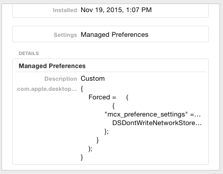

Also, that would only effect network volumes. Once created, that configuration profile would need to be on all computers that access that network share because otherwise you will end up in a situation where some computers have preference and others don't. And the ones that don't have it will continue to write the .DS_Store files on network volumes. Config profiles will not write plist files on the computer so it won't be visible in that regard. But you can check that the config profile is installed by using the "profiles" command (do "man profiles" in Terminal for more info) or check System Preferences -> Profiles. The latter will be the easiest to confirm that it's taking effect.
  • November 19, 2015
Yes, my plist looks like the above.
I confirmed it's there via System Preferences > Profiles
I logged out and back in, yet still am showing .DS_Store files on Desktop, I am assuming disabling DS_Store isn't retroactive as when I create a new folder it does not contain a DS_Store file?
