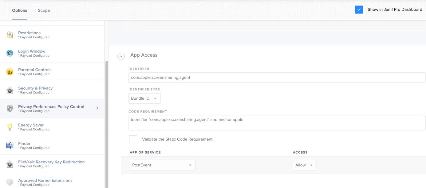

Since a few of you are asking for how to automate this process, Apple Support has an article explaining this new(ish) process. Keep in mind I think you need JAMF 10.11 or higher to have the features this article is talking about for the privacy config profile settings.
Use the kickstart command-line utility on macOS Mojave 10.14
  • May 2, 2019

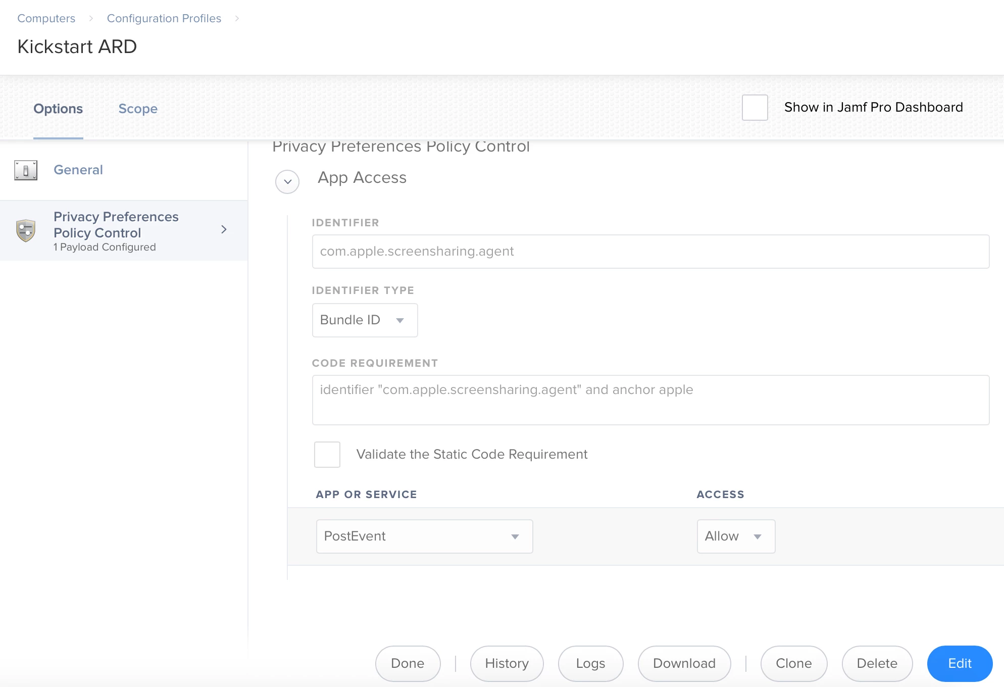

Yes, it is possible to automate this by pushing the PPPC and tying the kickstart command to a smart group of computers that have the profile installed. We update inventory every half an hour so time isn't of the essence.

@CorpIT_eB The first thing is to create the PPPC to allow the kickstart command.

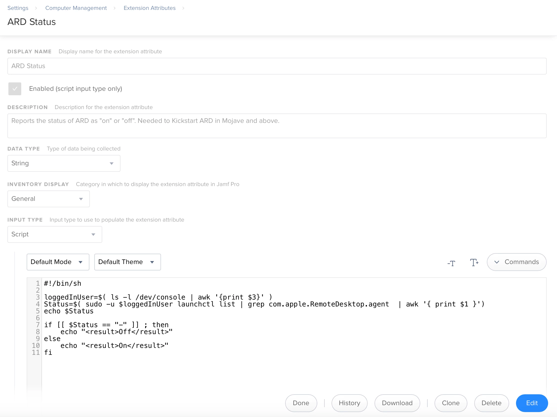

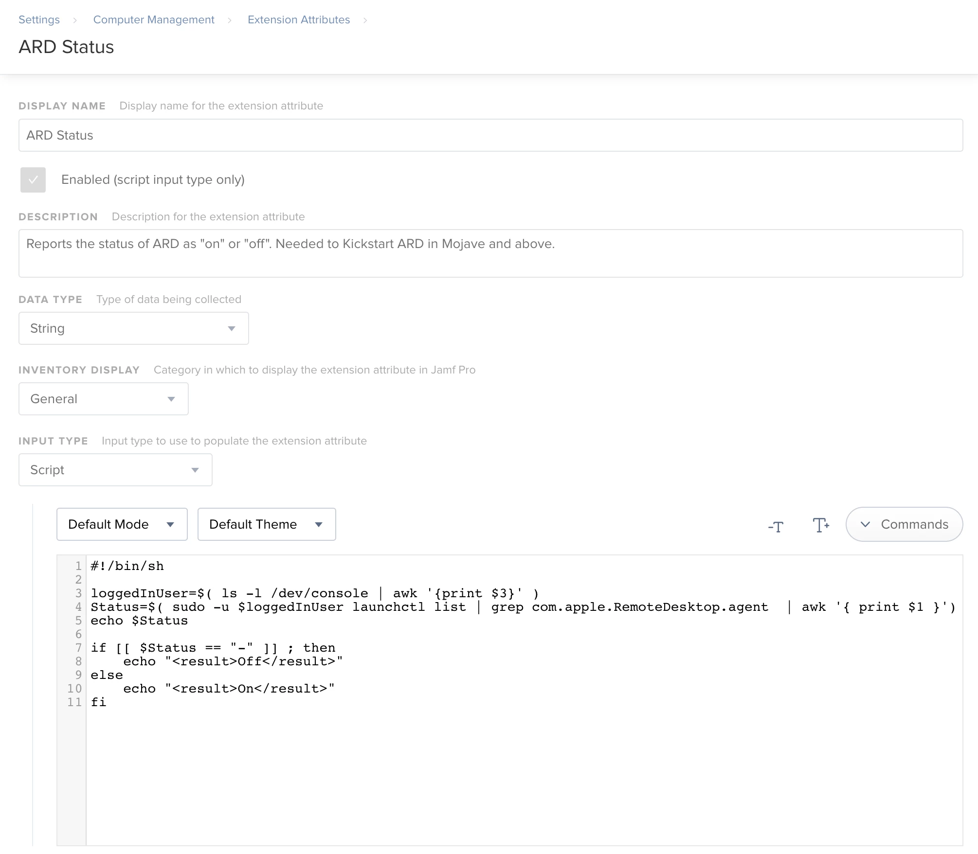

Second, I have an extension attribute that checks to see if remote management is enabled on enrolled machines. Note: Devices will need to update inventory to show a status if you set this up.
loggedInUser=$( ls -l /dev/console | awk '{print $3}' )
Status=$( sudo -u $loggedInUser launchctl list | grep com.apple.RemoteDesktop.agent  | awk '{ print $1 }')
echo $Status
if [[ $Status == "-" ]] ; then
    echo "<result>Off</result>"
else
    echo "<result>On</result>"

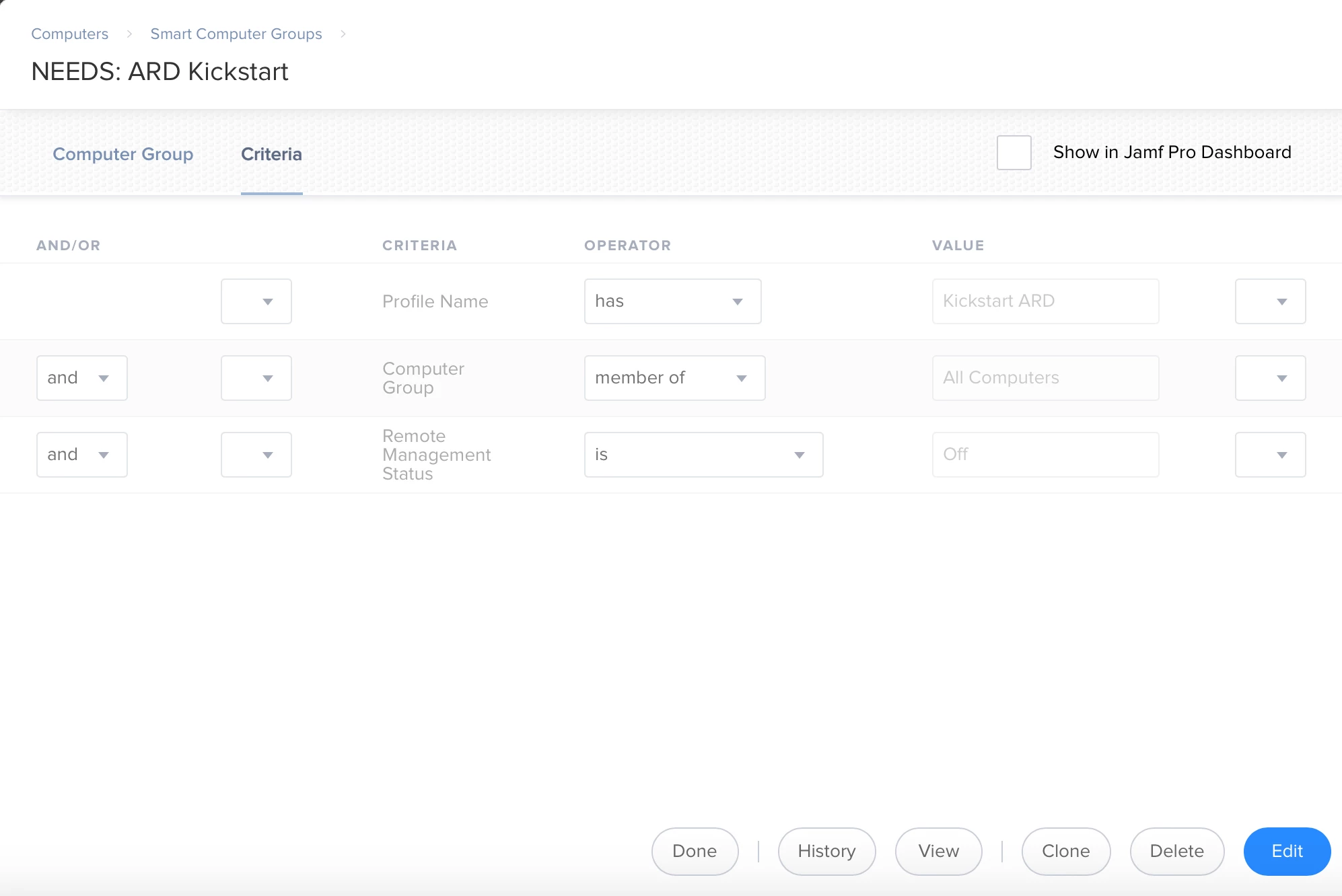

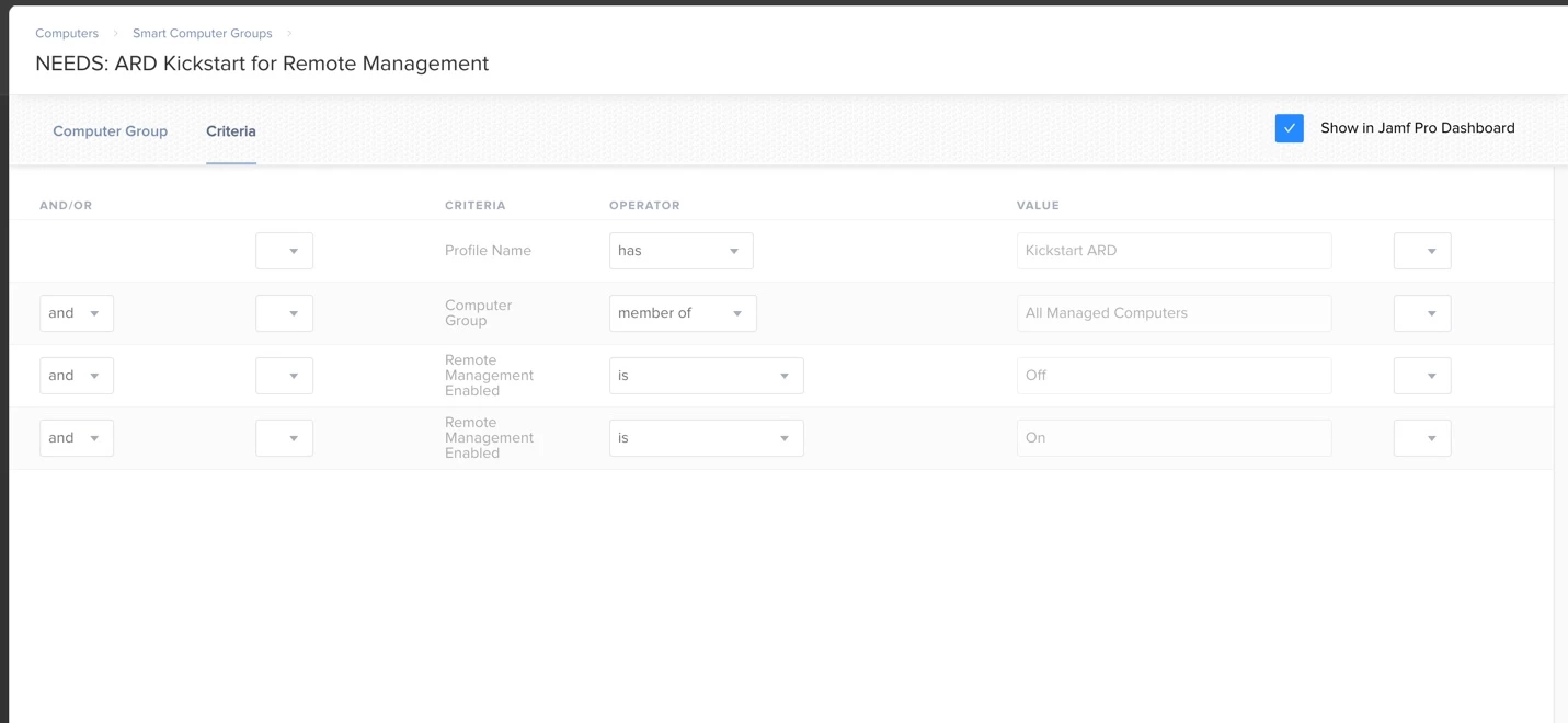

Then I have a smart group setup with devices that have the kickstart profile, are in a computer group (I scope to all computers), and Remote Management Status is "Off".
Lastly, I have a policy setup with the attached script scoped to that smart group. I have it set to ongoing @ login, enrollment complete, and recurring check-in. I can set it to ongoing as that smart group is re-calculated after running the kickstart policy.

@jcheLC I looked at our environment and it is grabbing "On" and "Off" as expected. I would double check the EA, here is what we are using:
Remember your devices need to Update Inventory to grab the state once you update the EA.

wierd, iono why i had this:
if [[ -z $Status ]] ; then echo "<result>Off</result>"
else echo "<result>On</result>"
the update inventory is auto right, as long as it recons in?
  • January 6, 2020
@jcheLC Yes. Update Inventory / Recon are basically the same thing.

@jared_f I have my EA set up identical to yours but it just shows a blank space. I've ran sudo jamf policy and I see multiple computers checking in, but it's still not giving me a yes or no on any of them. Anything else I can try?
Update: I honestly don't know what happened but it all of a sudden started working, sorry for jumping the gun, and thank you for having such a detailed comment on how to set this up, you rock!
