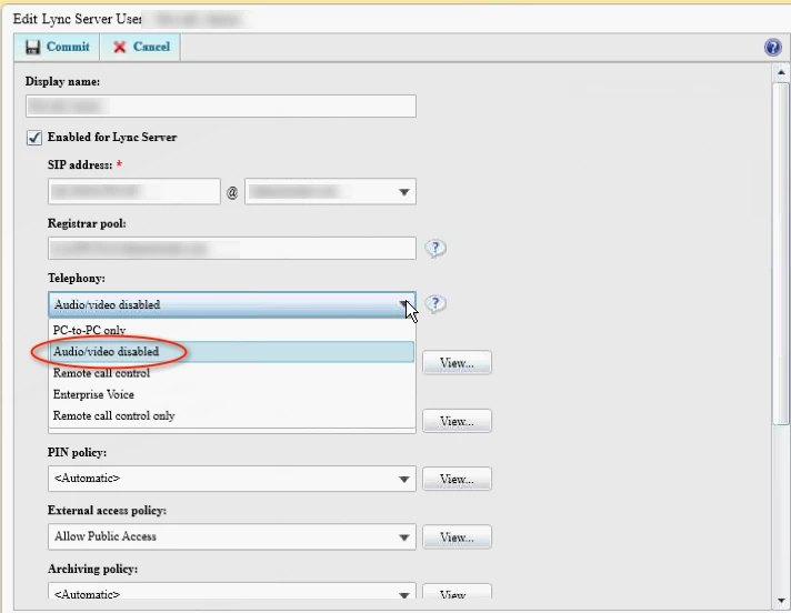

@talkingmoose Thank you for the awesome feedback. I was able to work with our Lync admin to disable the audio/video at the server level. We thought we had it disabled on the server before but then realized it was not set correctly.
We needed to go into the users profile and set the telephony setting to Audio/video disabled
To set this across all users you can run a powershell command on the server like the following example.
Get-CsUser -LdapFilter "Department=Finance" | Set-CsUser -EnterpriseVoiceEnabled $false
As for the Idle time and Lync Plugin settings, like an idiot I was editing the wrong keys in the plist. I am going to update my config profiles later today and give them a shot.
