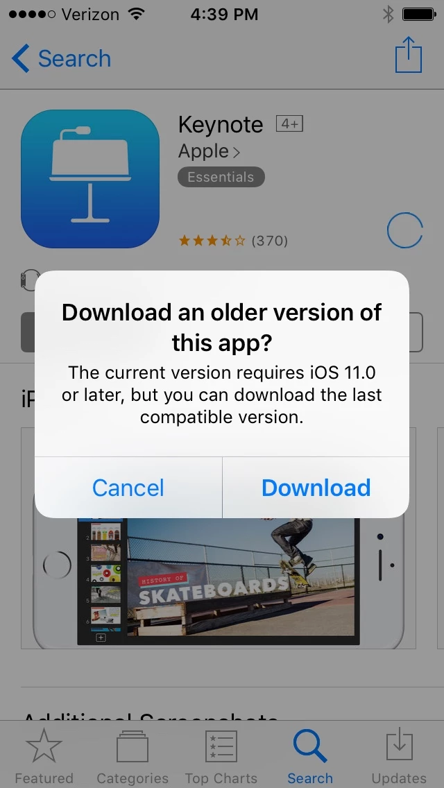

Got an update on this from @camden.webster - We've actually determined a more specific cause for this behavior regarding the failed commands, so I apologize for providing an incorrect explanation earlier. It turns out that this behavior is isolated to just 5th-gen iPads (iPad Airs) from what we can tell, only when assigning new licenses to the device. Expected behavior for Apple apps on devices running an incompatible OS is that they install the last compatible version, which should still be available for them in the App Store. I've attached an example of the prompt that appears if I were to manually install Keynote from my purchase history on an iPhone 5 running iOS 10.
We've opened a product issue on our end for this behavior as PI-004512, but have also opened an AppleCare ticket with Apple to further investigate this issue. We can reproduce this behavior outside of the JSS by signing into the App Store on a 5th-gen iPad using an Apple ID that does not have Pages, Numbers, Keynote, etc in its purchase history. When we attempt to download any of the applications we are not given the prompt displayed in the attached screenshot and the download fails.
