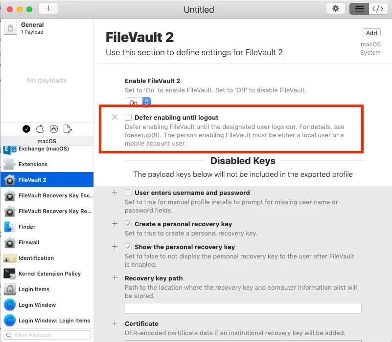

If you're using a configuration profile, that would enforce FileVault activation and prevent the disk from being decrypted (this assumes you are preventing your users in Jamf from removing config profiles). You could also disable deferred enrollment with a profile as well. I'm not sure if you're just using a policy to activate FV right now.
Aside from Jamf's interface, you can use something like ProfileCreator to get very granular with the specific settings you need. This screenshot shows a profile that would explicitly deny deferred enrollments. You might want to consider involving managers/HR if there are hardcore stragglers that don't want disk encryption on their Macs.

Huh, yeah I don't see it in Jamf either... my org doesn't have an issue with people always deferring, so we don't have that enforced in a profile. But you can definitely set that preference with ProfileCreator.
It's ok to have multiple profiles that control FileVault, the most restrictive setting will win out. So if you use the built-in Jamf profile to enforce FileVault being on, and then upload a custom FV profile made in ProfileCreator (which enforces FileVault and prevents deferment) then both profiles will complement each other without conflict.

Thank you all for the help on this. I've tested the additional profile on my test mac and it did over ride the deferred and forced the encryption at the next login as well as is preventing the user from going back into the terminal to turn FileVault off.
