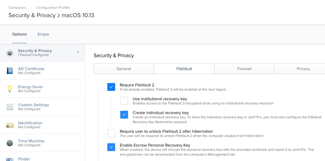

I've used the script available via JAMF support on GitHub to issue a new personal FV2 key to an already FV2 encrypted computer running High Sierra. (https://github.com/JAMFSupport/FileVault2_Scripts/blob/master/reissueKey.sh)
The script successfully changes the personal key, but the new key does not escrow on the JAMF server.
I've tested this by using the script to change the key and then attempted to use the previously escrowed key to access the computer. The old key fails.
I have a config profile in place which I thought would get the new key onto the JSS (see the screen shot).
Has anyone successfully accomplished this on High Sierra? Any input would be greatly appreciated.

I've found that with high sierra, the key does not get sent to Jamf until an inventory update occurs. On one of your machines that has the new key, go to terminal and type
sudo jamf recon
and see if they key is in Jamf after that.

hmm has the config profile ever been removed after you sent it out? I would check the config profiles logs and see if anything weird was changed and check the logs of the computer for anything out of place (/var/log/jamf.log)
I have never had an issue with the FV2 Key escrow on a 10.13 machine, unless the config profile was removed from the device

@Mr.Einstein You may be encountering PI-005560:
[PI-005560] When a new FileVault key is escrowed, FileVault individual recovery keys report as invalid or unknown for computers with macOS 10.13.x. Workaround: Reboot the device, and submit an inventory update.
