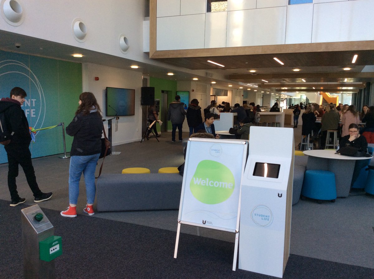

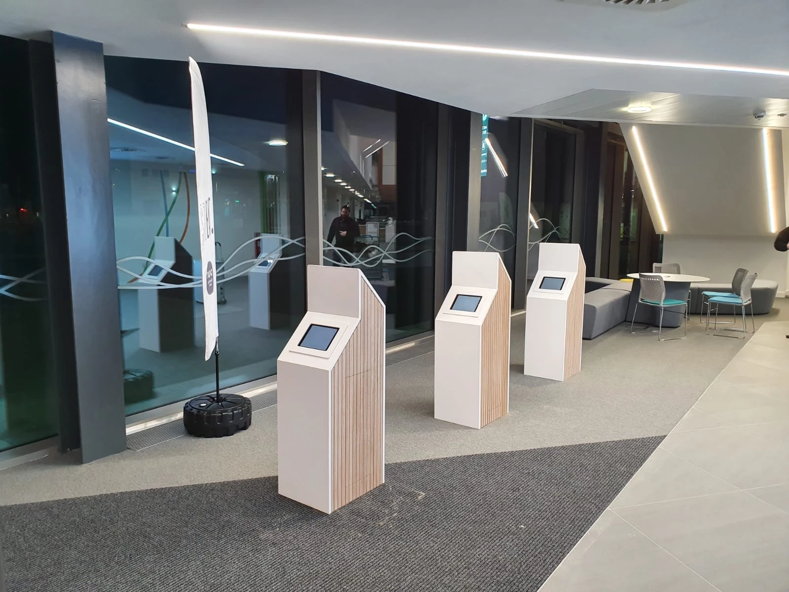

Our setup is an iPad in a plinth with very little access, once it's in all you can see is the screen and home button and the iPads are locked in Single App Mode to an In-House developed App which is essentially a web browser with restricted access.
Student Life
