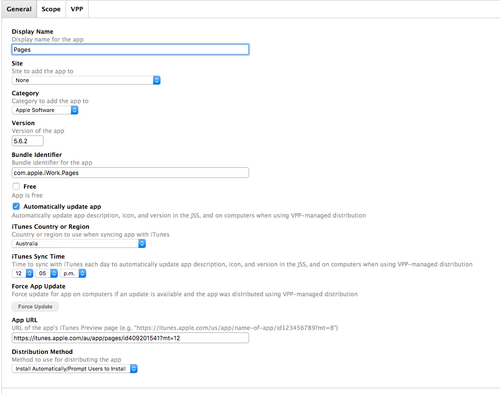

Just wondering if anyone is having issues pushing out apps using VPP at the moment or if anyone has seen the issues I am having:
Currently using VPP to push out apps, scoped to a static group of lab machines
Distribution method set to Install automatically/prompt users to install
this will not install the app until I edit the app and press FORCE UPDATE
once I click on the then the app will install in the next few minutes, although sometimes it will sit there at the app download file extension in the applications folder.
I have checked access to APNS on port 2195 and it is fine on both client and server.
We are running a caching server but this should not impact the push of apps (I think)
attached screenshot of App
