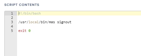

Going to ask here before starting a new discussion. The mas signout works fine for me if i type it in manually but if I try to push a script out to do it it won't work. History says the script ran fine and exited but the user is still logged in. I've been testing it on a 10.12 machine. I attached a screen shot of my script. Any suggestion?
@mcmeekin91 Have you ever figured out how to run mas via policy? I've tried using launchctl asuser [uid] /usr/local/bin/mas but doesn't work. I've also tried sudo -u [logged in user] /usr/local/bin/mas and that isn't working either.
Seems like it's trying to use mas under management account or root.
