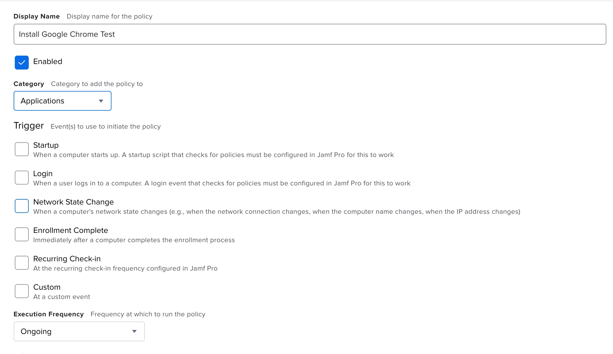

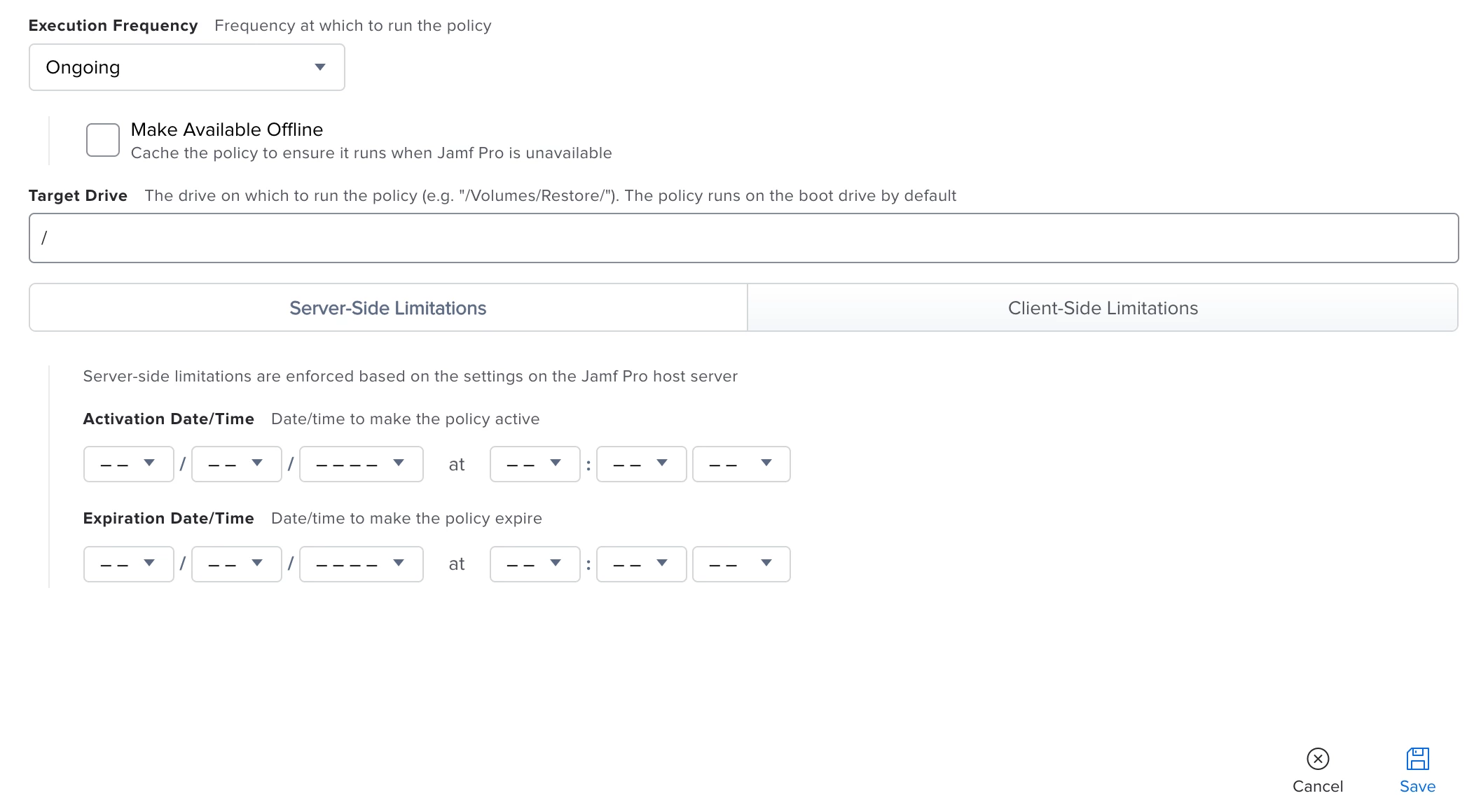

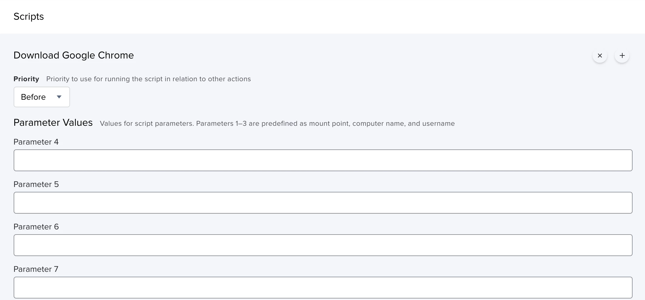

I'm looking to run this script and it runs fine in terminal, but does not run when deployed via Self Service. Chrome isn't our primary browser, so it's only available there and will be left up to the user to update. No part of the script, from beginning to end runs properly. It's like self service isn't even trying to run it. Any ideas on where this could be hanging up? It has been copied and pasted directly from the latest script above.
I've had this happen before, what happens when you delete the policy and try again?
Also screenshots of the elements of the policy may help us as well if after recreation it is still not working 🙂
I ended up with the same result. Just a failure notification from Self Service and seemingly no activity takes place. I'm watching /tmp for the googlechrome folder to appear as my point of reference for if the script is even trying to run. I've also looked for logs, but luck there either.
Very Strange, have you tried choosing a trigger (I know it's not needed with Self Service) or recreating it from scratch, I have had multiple policies fail on me (no indication of running) and had to recreate them for some reason, or is there anything that might prevent this from running on the machine, like another policy?
I finally broke down and hit up Jamf support. Looks like something just happened to be broken on the couple machines that I was testing on, regarding the device certificate for Jamf. I renewed it through terminal and archived the old one. That seemed to do the trick. It was weird because all of the other functions of Jamf were working through self service. App installation, etc. and the device was sending inventory and check-ins to our Jamf Pro server, but JUST scripts were broken. We're good now and the script works perfectly as written, so thank you for sharing it!
