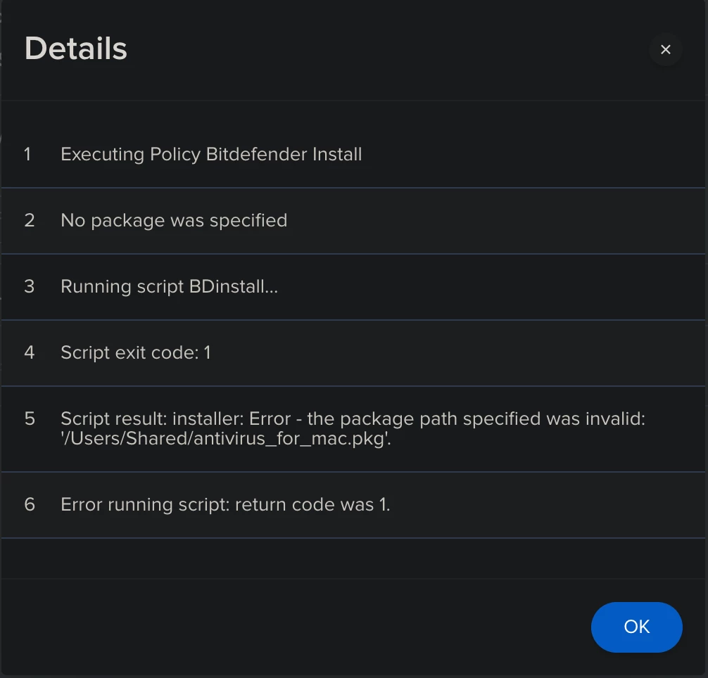

@bradchapman Once I have the package built, and I write the script (everything is done verbatim per the articles) it fails. This is what the log shows-
After going through some of the JAMF forums regarding the issue, I tried editing the script and file location based on some of the recommendations, but to no avail.

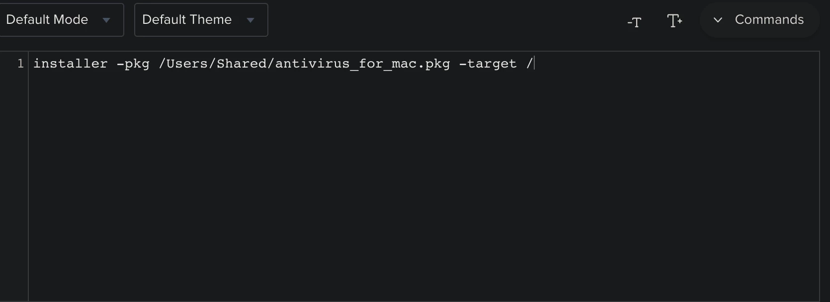

Looks like the script is missing the '-target'
Should be: installer -pkg /Users/Shared/antivirus_for_mac.pkg -target /
I confirmed I had the script typed out correctly, and I do. I still got the same response on my test machine. One thing I am now noticing is that the package in JAMF is actually "pending" but I created it days ago. I haven't had any of my other packages pend like this, so I'm assuming that something is going wrong with what I'm doing in Composer?

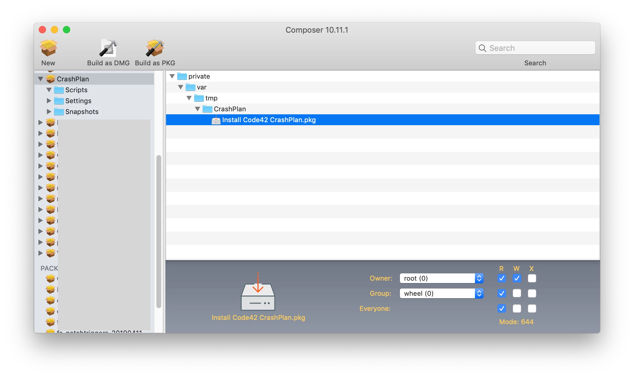

Please post a screenshot of the package source in Composer that you made for the Bitdefender package. Open all the folders so we can see where you put the antivirus_for_mac.pkg package.
Example: here is a package I built for deploying CrashPlan:

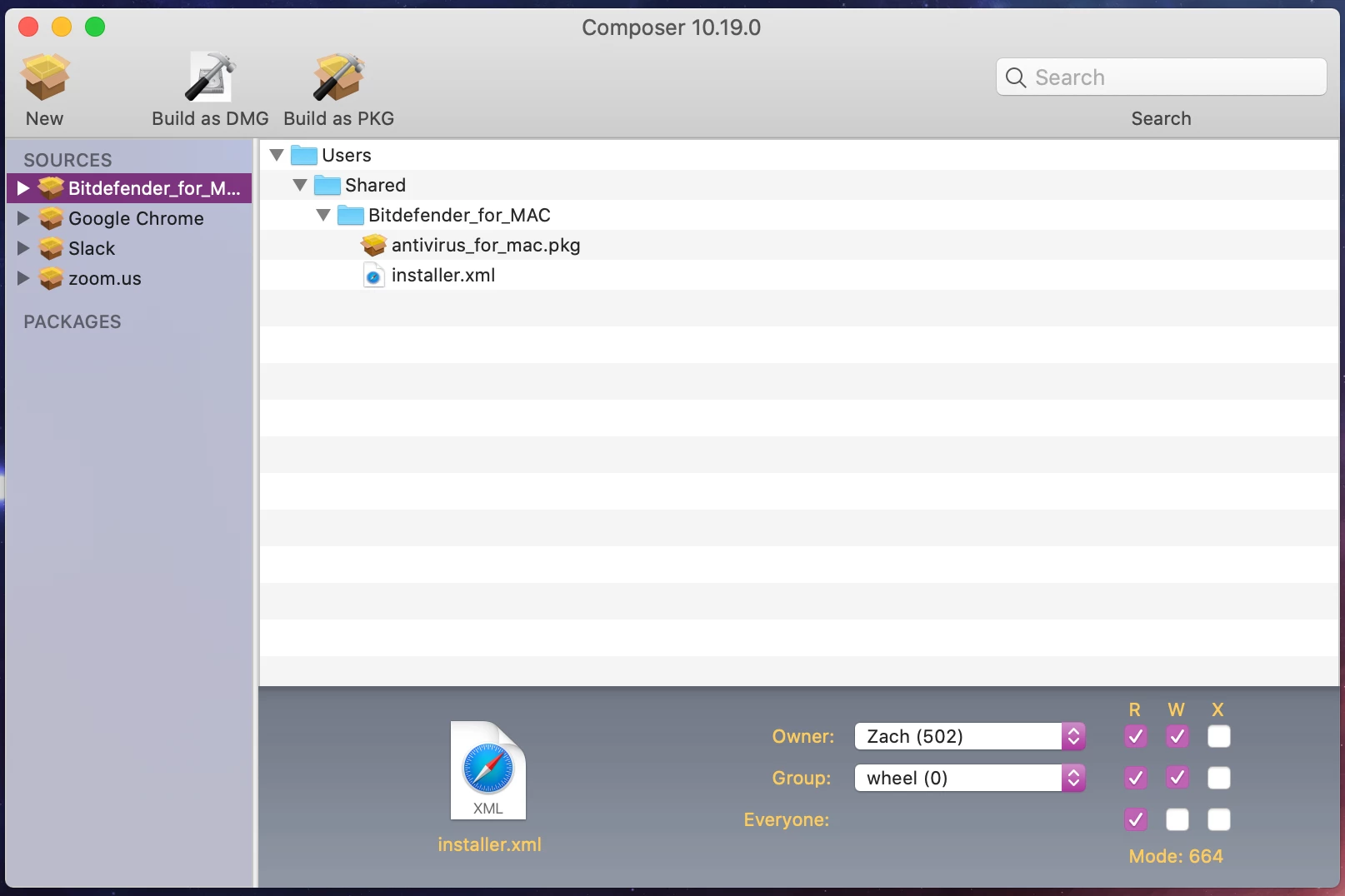

Here is a screenshot from Composer on my end.
Aha! You put everything inside a folder called Bitdefender_for_MAC, inside /Users/Shared.
Your install command was missing the complete path. The fix is very simple:
installer -target / -pkg /Users/Shared/Bitdefender_for_MAC/antivirus_for_mac.pkg

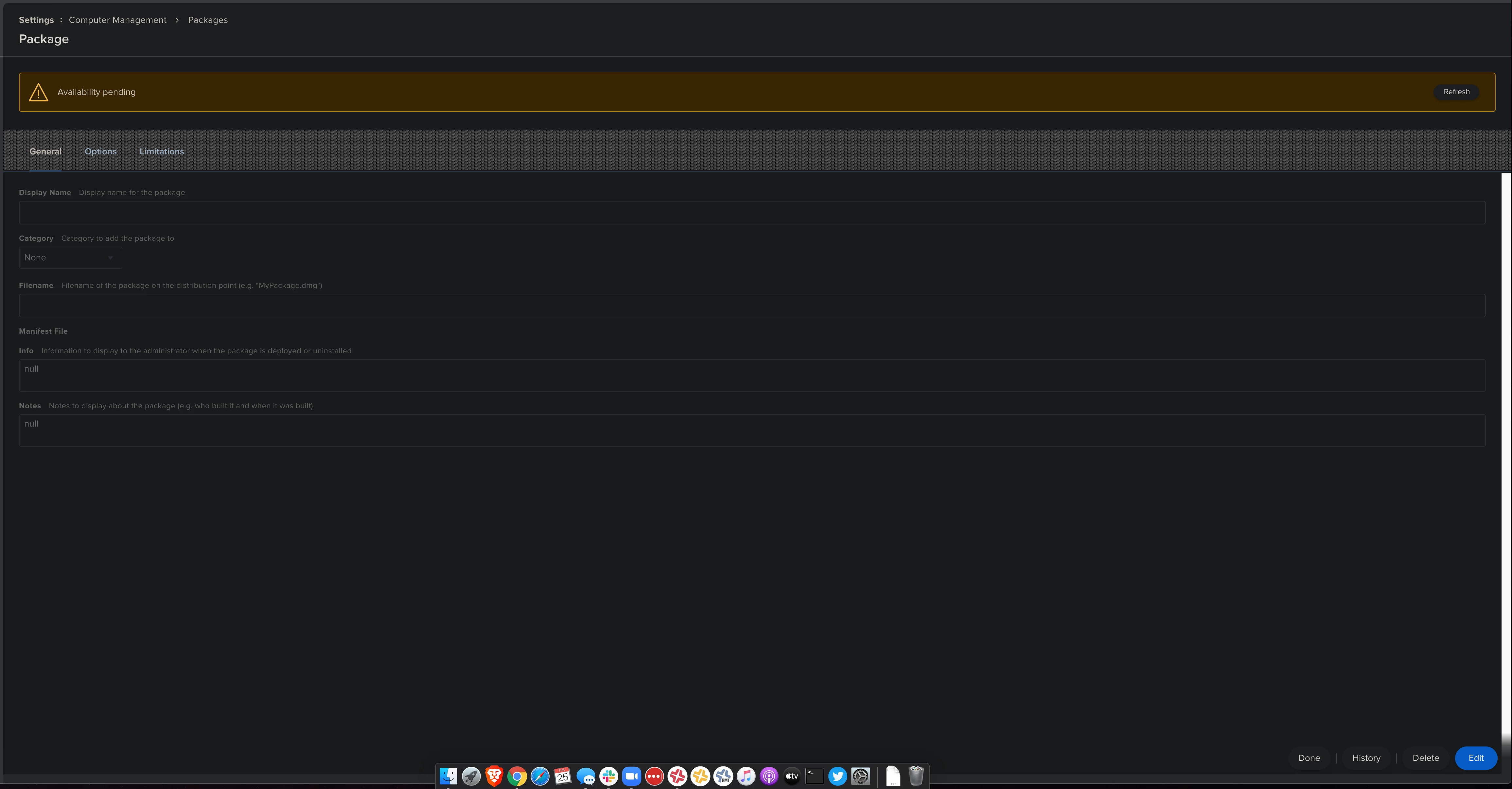

Perfect, I adjusted my script to support this. Another issue I am noticing, is that when I am uploading the package to JSS, what files should I be selecting for the FileName and Manifest? I've been selecting the .pkg, but when I do so, it doesn't seem to populate correctly. This is what I see directly after adding the package. The name was Bitdefender_for_MAC.pkg, but now it nulls out and calls itself 'Package.'
I'm assuming this is from the way I am uploading it?
I was just able to test everything, and I am getting the same error log.
@zachbuzalski : based on your previous response, if you get the same error it means the package wasn't downloaded to the computer during policy execution. I assume you're uploading packages via the Jamf console to a cloud distribution point? Try deleting the package object in Jamf, and uploading it again.
Policies always refer to packages as objects, and not by the filenames directly. That's because packages—like so many other objects in Jamf—have additional metadata like title, priority, category, exclusions, etc. Thus, deleting a "package" from Jamf actually deletes the file from the distribution point AND the entire object, which makes it disappear from all policies that were using it. Uploading the same package creates a new package object with its own unique ID, and that new package object has to be added back to those policies.
