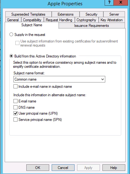

11) Then we have to Create a new AD machine certificate template on the AD cert server . Easiest way of doing this is to duplicate the Windows Machine (named WorkstationAuthentication in our environment) template and name it for Mac
12) Right -click and select "Duplicate Template"
13) Select "Windows Server 2003 Enterprise"
14) Then Edit the Template as in the next step
15)
(i)Name it like "OSX Workstation Certificate" this will automatically create the Template Name without spaces. You should use the name without spaces in "AD Certificate" payload in JSS.
(ii) In the "Subject Name" field, tick "User principal name (UPN)" and untick all others for alternate subject name.
(iii) In the "Security" field, make sure you have privileges for Domain Computers to "Enroll" and "Read"
