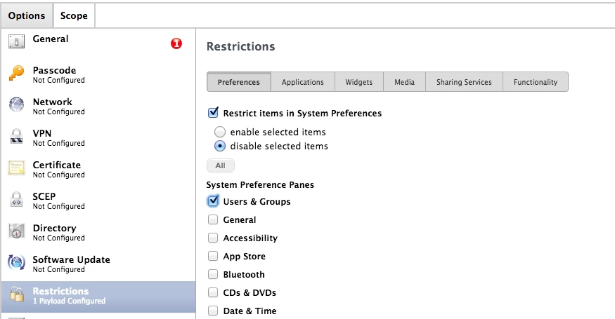

You could use configuration profile to disable the 'users & groups'.
Hi,
Thanks for your answer, are they still able to change there password in this section?
Thanks.
Once blocked, Users and Groups will be unaccessible.
@txhaflaire you could have them change their password in System Preferences-> Security & Privacy
@Johnny.Kim Thanks, we have deployed the mobileconfig but when using ADPASSMON and they use change password the still are able to come in the pane.
