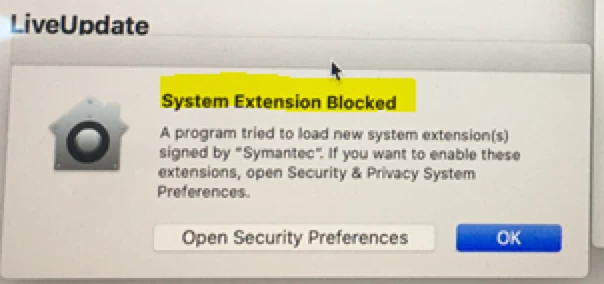

I have the same issue with MacOS 10.15.x Catalina and SEP 14.2 RU2 when installing - System Extension needs Approval and Full Disk Access is not enabled. I have done ALL of the above and no success
I wish I was here to solve this without writing another "me too" post. I have a case open with Symantec Endpoint Protection and a call scheduled here in the next hour.
I'm heartened to see this article by them: https://support.symantec.com/us/en/article.TECH256631.html
Apparently, they tried at some point making this work with Jamf...yay! Upon following it though, it still doesn't work unless I hand authorize that stupid system extension. I'm wondering if something dramatically changed for them in macOS 10.15.2 or something? I'll update this thread if we do anything useful with my case with them.
Same here as @blackholemac We have profiles for PPPC, SEXT and KEXT, fresh 10.15.2 install. I install the cloud version of SEP (14.2 RU2 25, in system info version 9.0.1) and this is what we see after deploying the pkg, and reboot:

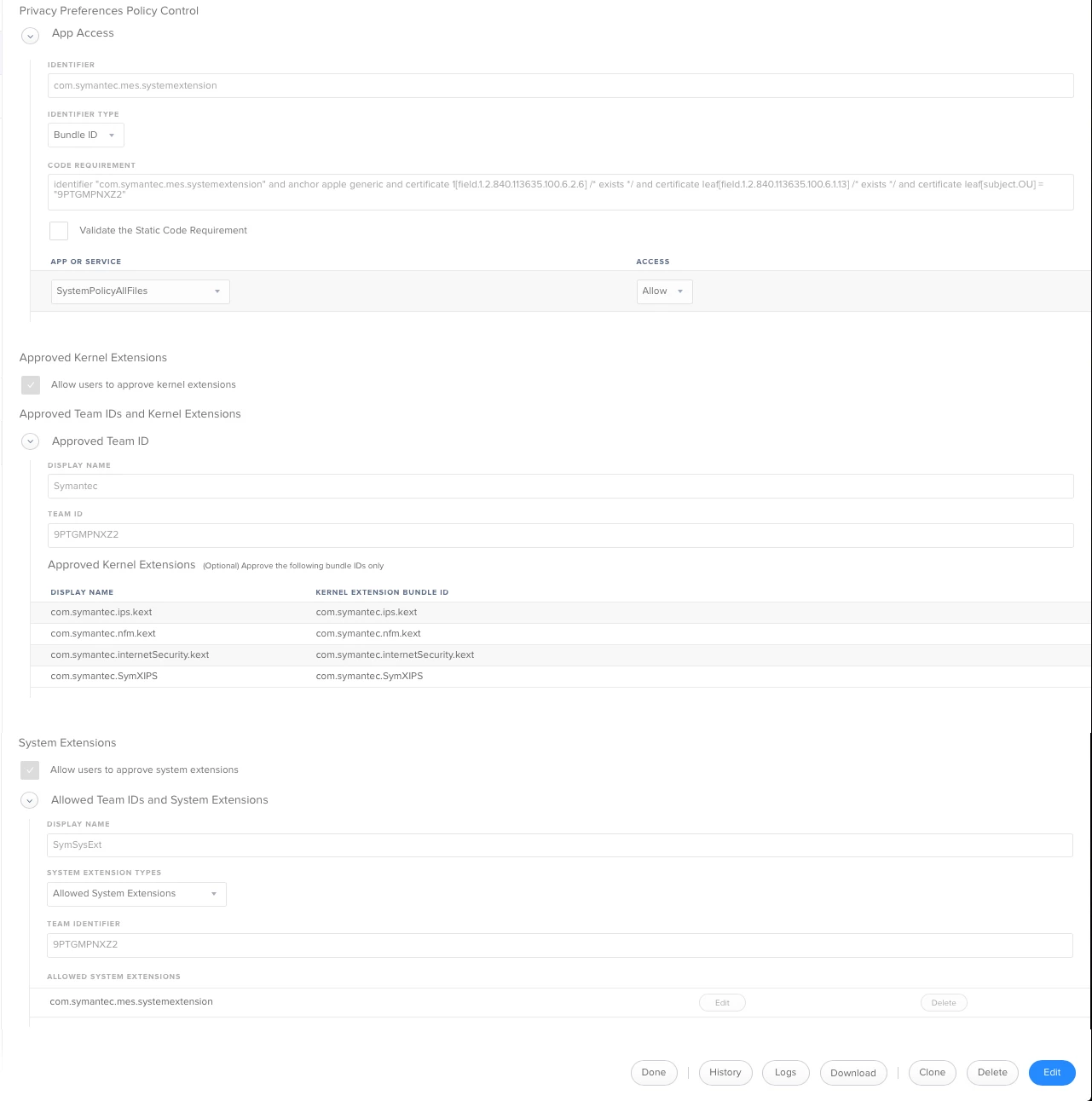

I have a single config profile with three payloads (PPPC, kext, sysext; screenshot below), scoped out to 10.15 (this is important, because if you apply sysext on 10.14 and then upgrade to 10.15, it doesn't know what to do with this and Catalina will not respect the config).
From there, I have a policy scoped to 10.15 machines that hits on login. I haven't been able to activate the system extension correctly without first launching Symantec Endpoint Protection.app in the user space, so I install the SEP 14.2 RU2 PKG as well as a postinstall script (below) that loads the SEP kexts and launchds, launches SEP in the GUI for five seconds (seems to be long enough to get it to activate the sysext), and then quits. I've tried invoking the binary or figuring out some way to do this separate from the user login, but so far haven't been successful.

@NoahRJ Couple of questions...I notice in your kernel extension payload, you add a line com.symantec.SymXIPS
All of your other kernel extensions in both the label and the identifier have ".kext" at the end. Is there a reason com.symantec.SymXIPS does not?
@blackholemac I grabbed that kext list from this SEP documentation, where SymXIPS doesn't have .kext appended, but the other three do.
@NoahRJ I must say, I'm impressed with your documentation and script....they worked for me like a champ. Unfortunately, much like you, I am noticing the stupid system extension taking up a high level of CPU utilization. I still have an open case with Symantec at the moment. I'm going change the nature of my case with them to report that your findings solved my installation issue but that now Symantec is using up way too much CPU resources. My call is in 25 min...I'm going to try installing Symantec by hand on an unmanaged Mac, manually enabling the stupid stuff and verify that it occurs in that configuration as well. If it does, I can send them logs and FINALLY get escalated to someone there that speaks Mac.

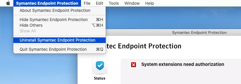

We too were getting the "System Extentions require Authorization" message in SEP although we had the correct Configuration Profiles on the machine. We used this KBA
Opened a case with SEP and they confirmed there were no issues with our configuration. We continued to test and discoverd the System Extention needs to be installed prior to SEP. Not sure if this is the case for everyone however for us pushing out the Config profile prior to the SEP upgrade / install did the trick.
We are hitting a wall with this process and I'm wondering if we are missing some steps. Despite allowing the system and kernel extensions as well as loading the PPPC profile we are unable to get past the "System Extensios require Authorization" step.
Overview of the steps we are taking:
  • Fresh Catalina install (10.15.3) enrolled via DEP
  • Install the three profiles
    -- Approved Kernel Extensions (Symantec TeamID, 9PTGMPNXZ2, we don't list any kernel bundles)
    -- Allowed System Extensions (Symantec TeamID, we then specify com.symantec.mes.systemextension)
    -- Symantec PPPC policy (allow SystemPolicyAllFiles)
  • Install SEP (14.2.5569.2100)
  • Reboot
I can now see that the system extension is loaded, but it is still marked as "activated waiting for user". I tried using the script shared by @NoahRJ but status remains the same (btw, I am unable to execute this at login, but have manually run it, as a test, immediately after login - not sure if this makes much of a difference regarding it's effectiveness).

SEP client asking for manual approval of system extension and privacy preferences after upgrade to macOS 10.15, despite the correct configuration policies being in place? The related *.systemextension type is new in Catalina; it doesn't run in earlier macOS versions. I would expect that the OS upgrade would re-check policy against the new extension. But it doesn't. Remains to be seen whether this is a Symantec or Apple bug. And the following isn't really a fix, but demonstrates how to get macOS to re-query the configuration policy: un/re-install SEP but don't use the RemoveSymantecMacFiles tool because it does not handle the newer systemextension. As a matter of fact, the current version of this tool will stop and ask you to use the application's uninstaller if it detects a newer Symantec product. You can still run RSMF afterward.
ATTENTION: You must use the uninstall option in your product's
"Symantec Endpoint Protection" menu.
Older versions of RSMF won't warn you, and won't reset the stuck "waiting for user authorization" and re-installing SEP will put you back where you started.
