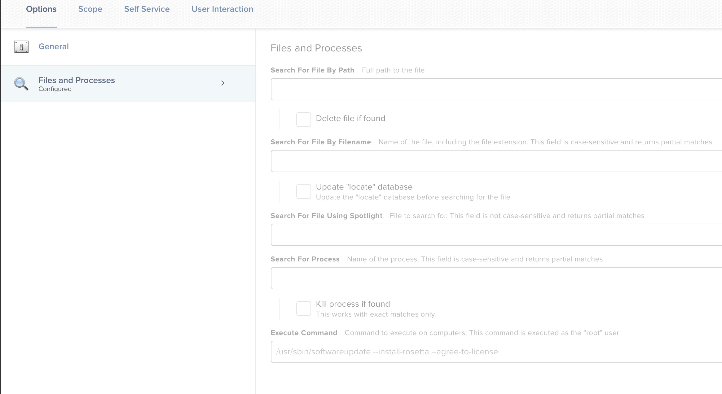

Set the first policy in your deployment to install Rosetta via Files and Processes/Execute Command: /usr/sbin/softwareupdate --install-rosetta --agree-to-license
Like @Jason33 mentioned, and then scope it to your M1 Smart Group.
Thanks All, this works like a charm.
