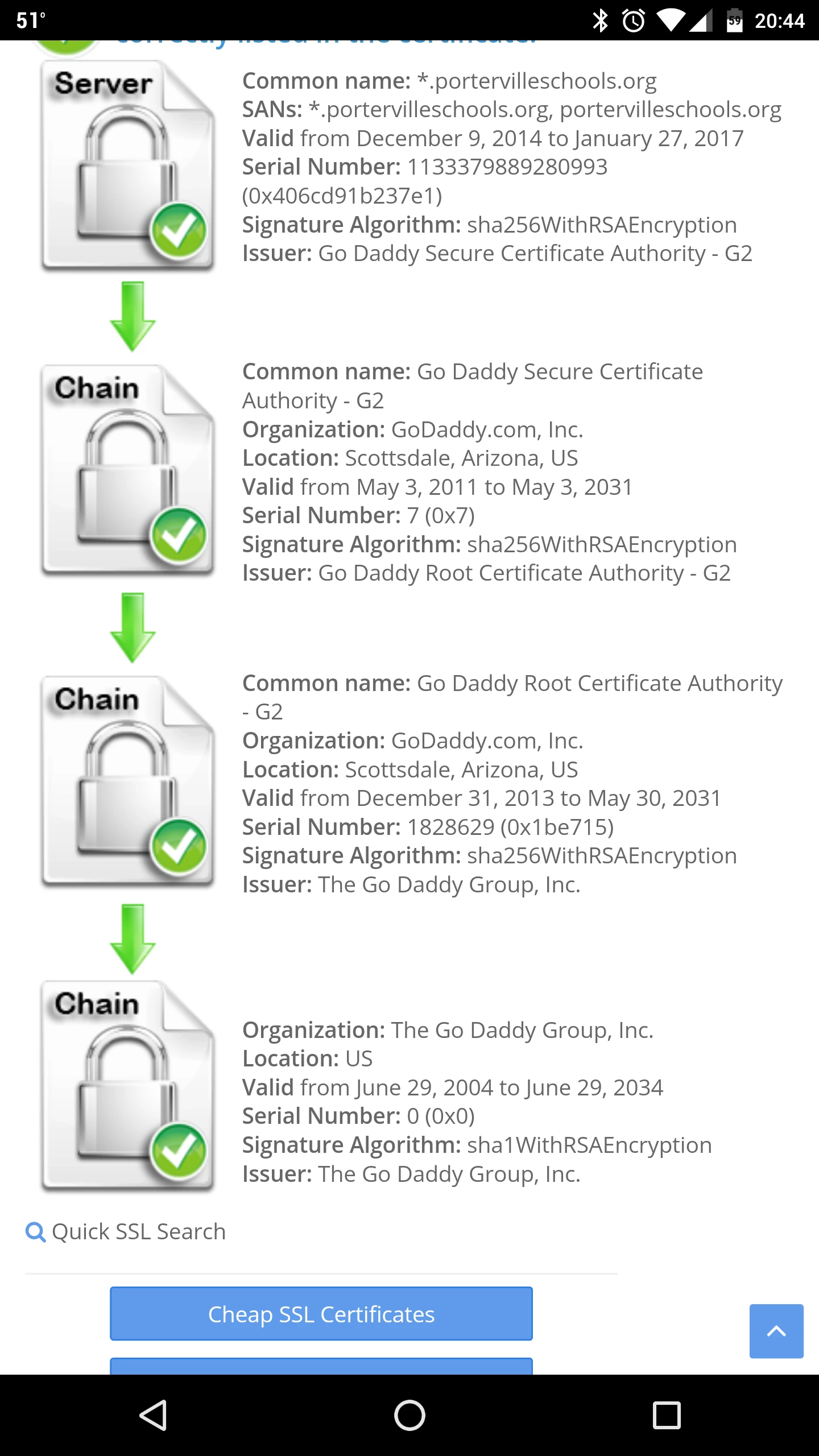

Hello I am in the process of converting all of my iPads in my organization JAMF and unfortunately on some specific iPads I am unable to do so. I have 3 iPad 2's and 2 new iPad Pro's all up to date on 9.3.5 and 10.2 that every I attempt to activate them through DEP during the setup process I receive an "The Operation couldn't be completed. NSURLErrorDomain error -1012". These devices are assigned to our jamf JSS in School Manager as well. I've attempted to wipe them numerous times and each time I go through the setup I get the same error. Our JSS is on 9.96. I've been able to convert through prestage about 25 iPads of varying models but these 5 I am unable to do so. I've checked all my certs to ensure they're up to date and they all look good. Have check into time drift and ensured the time is correct on my domain controllers and the JSS server. I'm at a bit of a loss. Any ideas?
