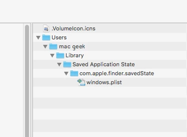

I want to change my Macintosh HD icon to something different. I used Composer to Monitor File System Changes, copied an icon on my desktop, selected the Macintosh HD and did a Get Info and pasted the new icon over the original one. I entered the Admin name and password, closed the window and voila the icon had changed and I stoped recording.
I exported the Source as a .pkg and I attached it to a policy and ran a test and it failed. Then I rushed to test it on another Mac and it failed. I went through the same process of changing the icon on the other Mac and then tried my .pkg file again and it succeeded. I have since verified this on several other Macs. Once the HD icon has been modified the first time my .pkg works.

One thing I do know is that when you paste a custom icon onto a volume, like Macintosh HD, it creates an invisible ".VolumeIcon.icns" file at the root of the drive. If the icon gets removed or has never been applied, that .VolumeIcon.icns file isn't present. You can see this by doing ls -al / before and after applying your custom icon. I suspect your pkg may not be properly applying the .VolumeIcon.icns file to the HD when the pkg is run, but if one is already present, it's able to change it something else.

The package I created does install a .VolumeIcon.icns at the root level. Something gets switched on or off that allows this change to happen and I'm hoping someone has the answer.
