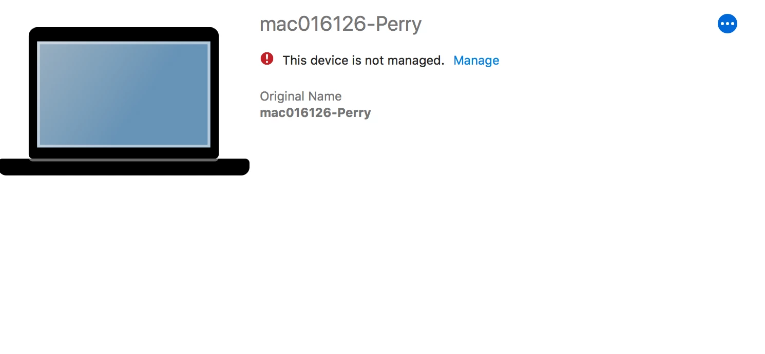

So if i enrol through Self Service its adds to Azure but no further but then if i run the portal app from applications it adds to InTune but fails to manage because of the JAMF MDM Profile already installed.

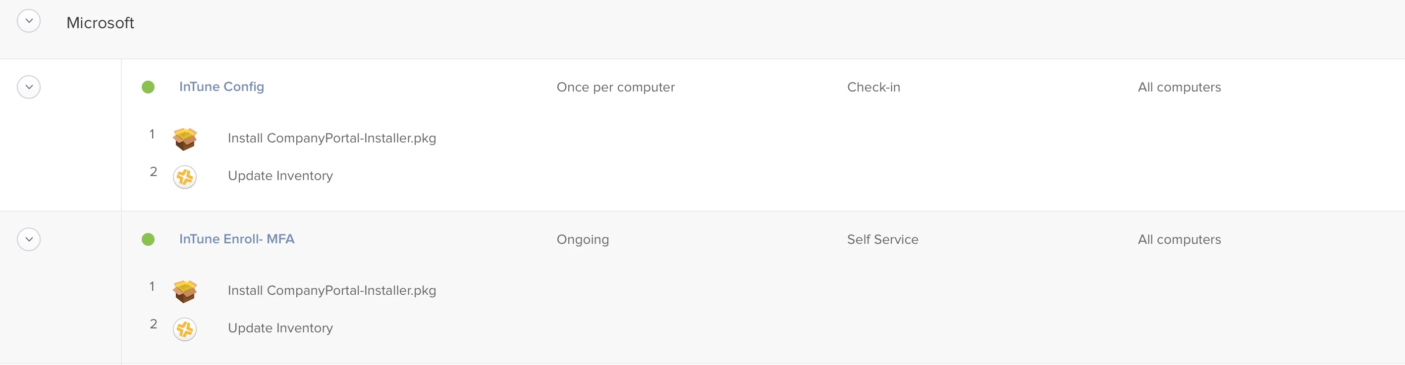

Part One:
You need TWO policies in JAMF. The first one forces the Company Portal App to all scoped Macs. Once deployed, you need a second policy in Self Service that the user uses to launch the Company Portal App. This second policy also has InTune integration enabled.

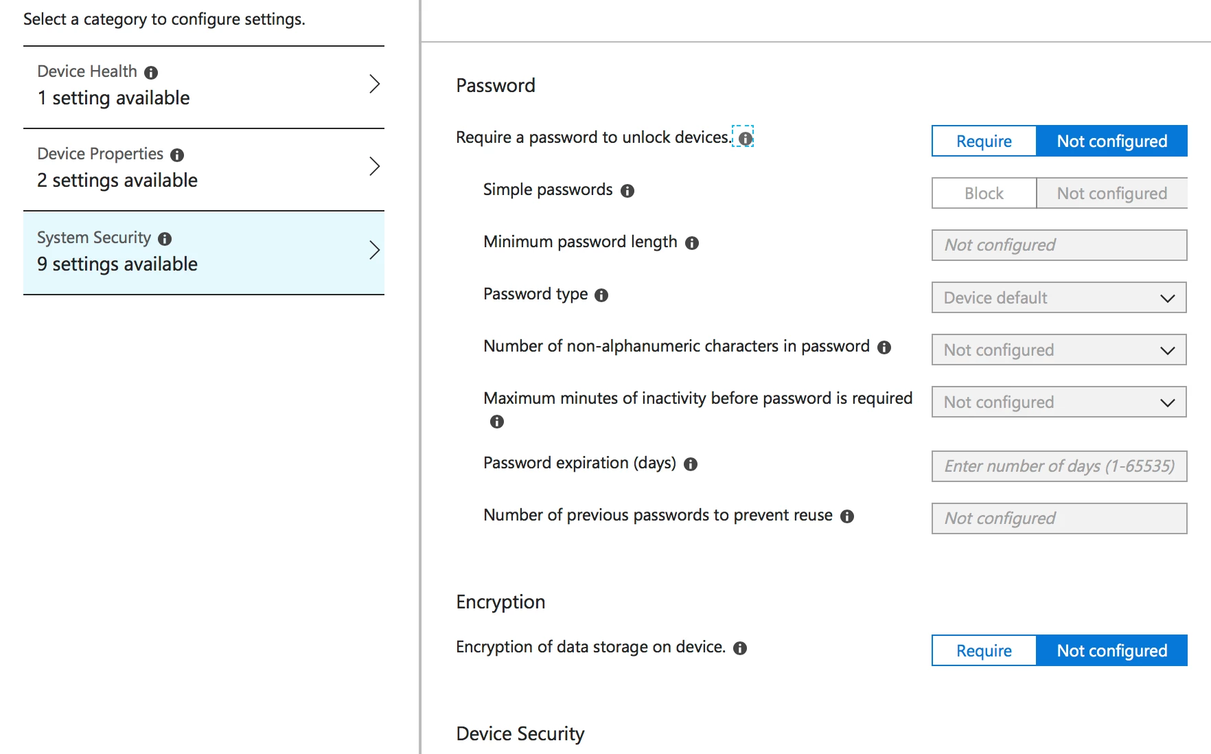

Part 2:

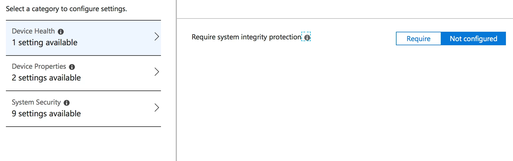

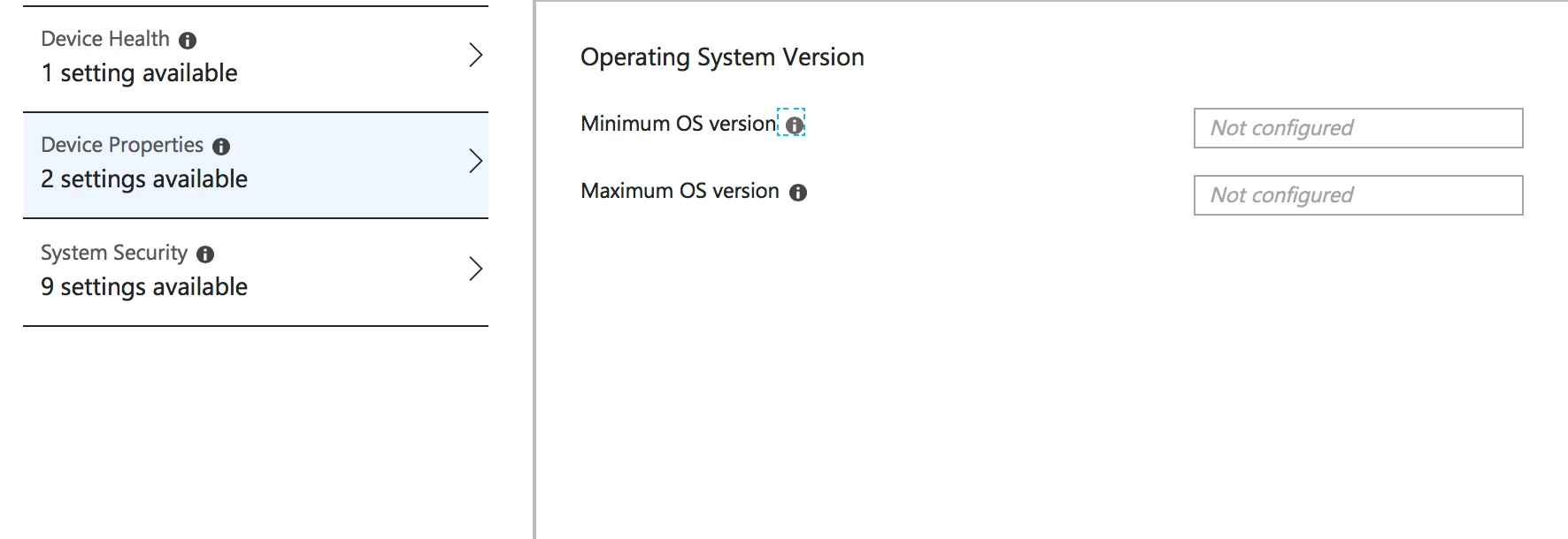

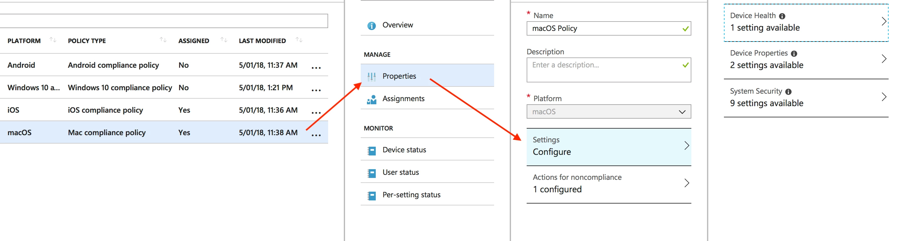

Log into Azure, find the Intune blade.
Click on "Create a compliance Policy"
Name it something logical.
Click on "Properties"
Create a policy. Nothing needs to be configured.
Now the Company Portal App will check in and see there is a policy for the Mac. As long as your criteria is met, you are compliant.
Just an FYI on the MDM question you had: That makes no difference. I know it looks like it requires the Mac to be managed by Intune, but it doesn't care.

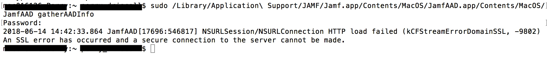

So seems to be some sort of SSL error im getting when running JamfAAD to register with Azure. I'm getting completely stuck on this now and neither Jamf or Microsoft seem to know a fix?!

Seems to be some sort of SSL issue maybe at our end or somewhere between Microsoft and JAMF when JAMF tries to get the information from Azure and then push it back to InTune.
