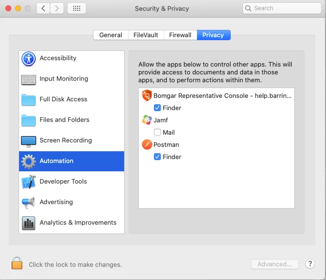

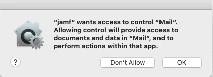

Somewhere around macOS 10.15.5 or so several of my users began receiving a pop-up message from Jamf requesting access to Mail. If you make a selection from the prompt it does create an entry in Security & Privacy under Automation. I worked with an engineer at Jamf on the issue and they were not able to replicate it in their test environment or determine the cause in our environment. It seems to be connected to inventory collection and I can replicate the issue consistently

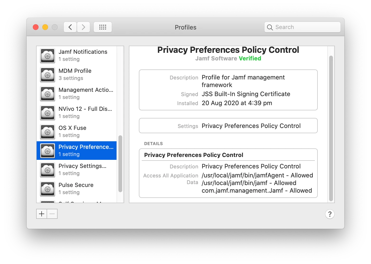

But I think it might be covered by this Configuration Profile

Hi Matthew,
This is exactly what was happening to me. I figured out that it was happening during inventory collection. It turns out it was an extension attribute that was trying to collect the email address of the logged-in user from the Mail app and/or Outlook if they were installed and being used. The attribute was created when we started running Vision-Bot on our Jamf Pro instance. I disabled the extension attribute and the issue went away. Hope this helps!
