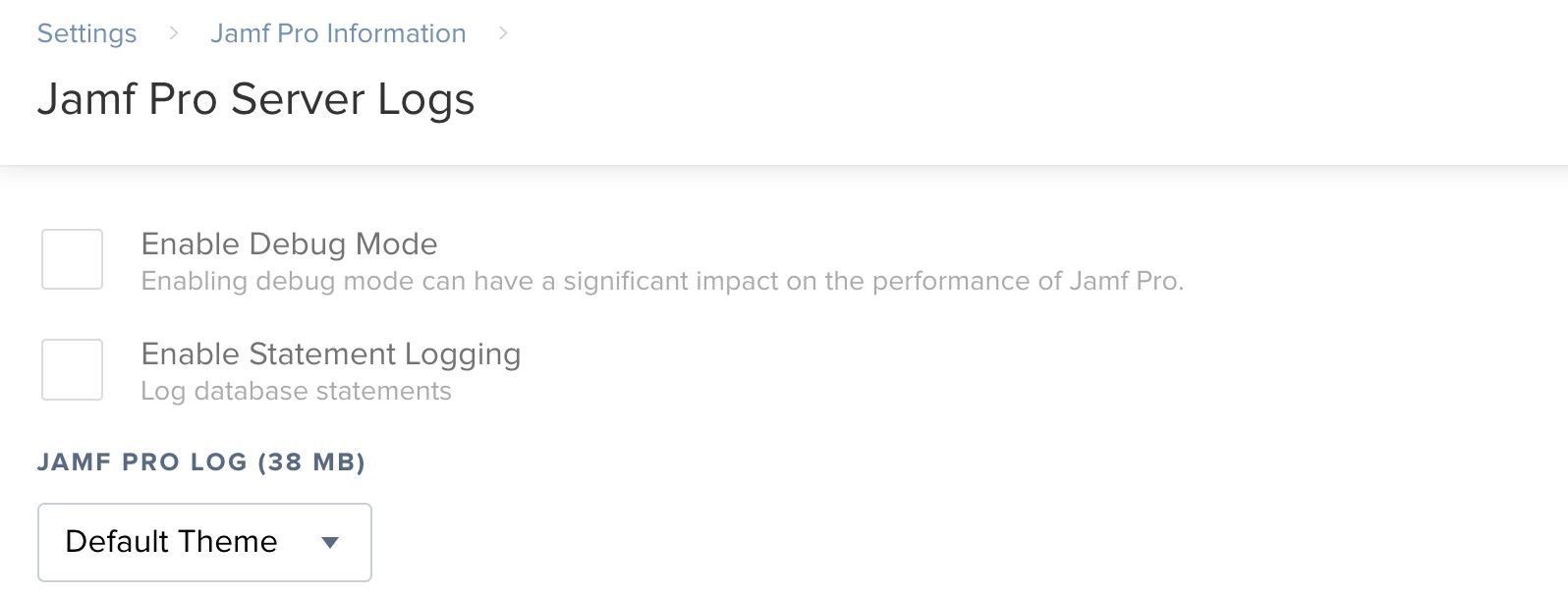

The JAMFSoftwareServer.log will have some info or you can log into https://myjss.com/logging.html and see if anything useful comes out of this. Are you using Okta UD as well?

I'm not seeing anything related when i go to https://myjss.com/logging.html

If you load your JSS URL and then add logging.html on the end of the URL it should pull up the logging interface.
