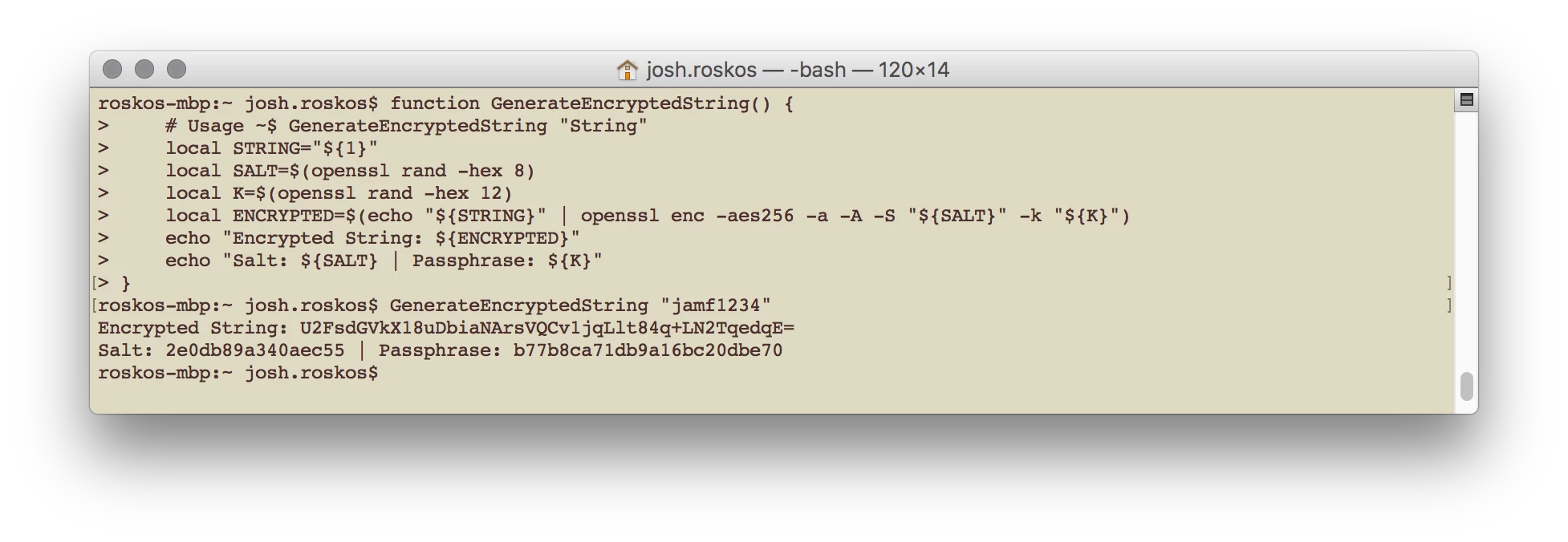

  1. Head on over and check out Bryson Tyrrell's EncryptedStrings_Bash.sh file on his GitHub page.
  2. Copy lines 8-16
function GenerateEncryptedString() {
    # Usage ~$ GenerateEncryptedString "String"
    local STRING="${1}"
    local SALT=$(openssl rand -hex 8)
    local K=$(openssl rand -hex 12)
    local ENCRYPTED=$(echo "${STRING}" | openssl enc -aes256 -a -A -S "${SALT}" -k "${K}")
    echo "Encrypted String: ${ENCRYPTED}"
    echo "Salt: ${SALT} | Passphrase: ${K}"
3. Launch Terminal on your Mac
4. Paste in the copied code and press enter
5. Now enter the following command, replacing jamf1234 with the password you want encrypted
GenerateEncryptedString "jamf1234"
6. This will give you the following output
7. Now on the removeTempAdmin.py script, take the Salt and put that on line 76 and the Passphrase on line 77. The Encrypted String will go into the Jamf Pro Policy which has this script attached and be used on Script Parameter #4. The userName of the admin account you are checking will actually go on line 75 in-between the single-quotes where I have orgAdmin.
